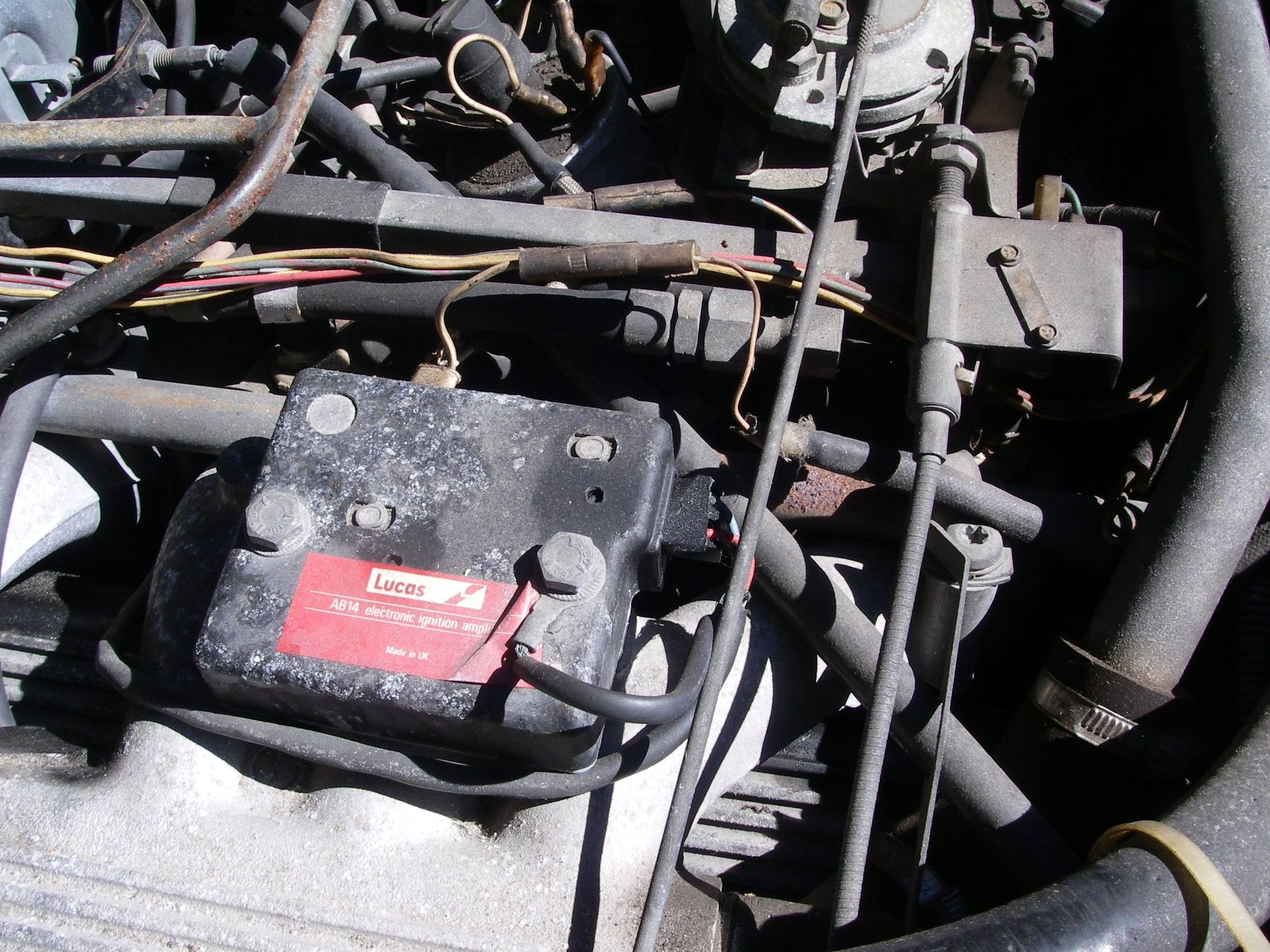

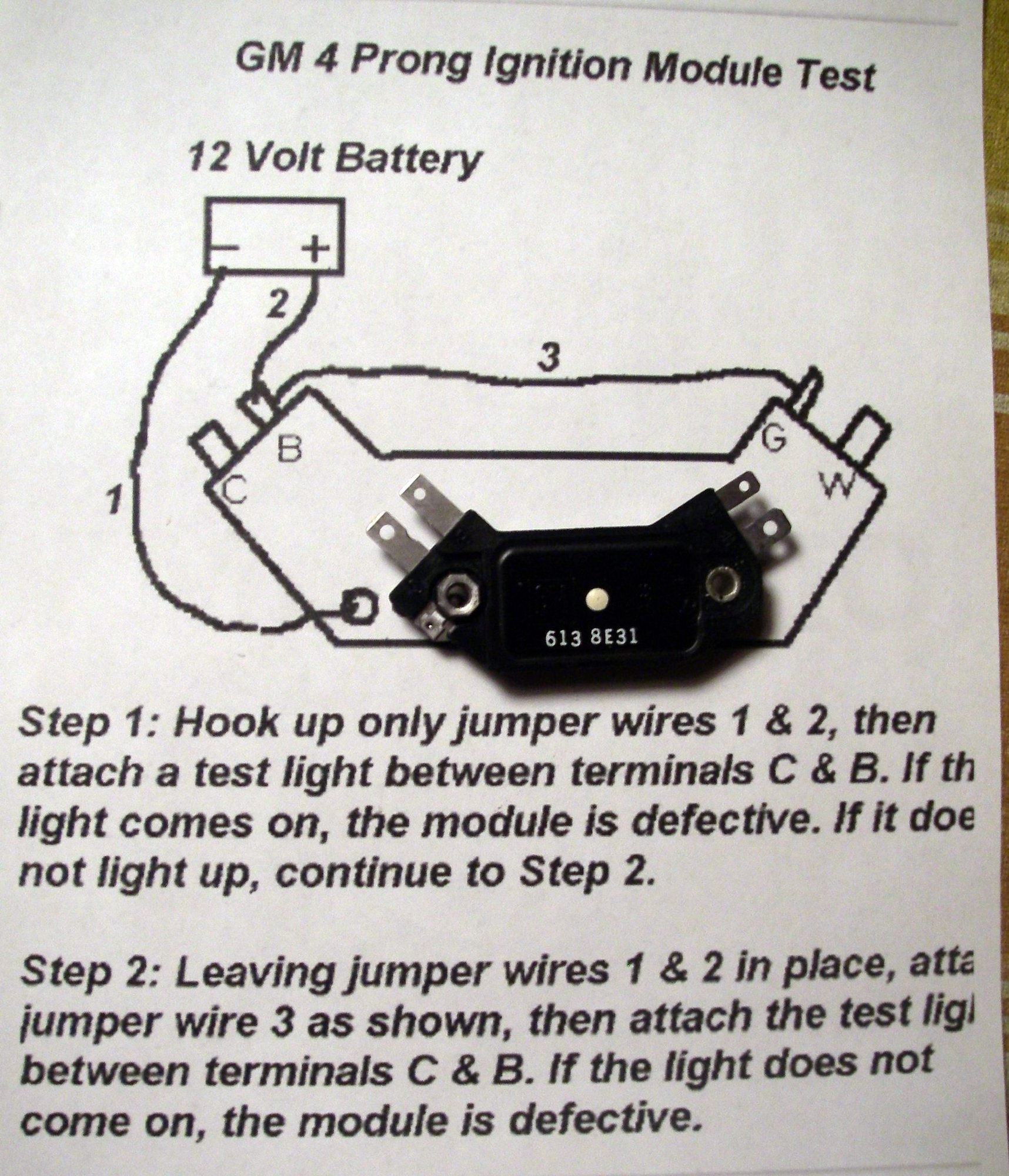

Have you checked the GM ignition amplifier contained in a square flat box (about 4"x4"x1") atop the left side of the engine?

Actually, I'm not certain your year & model uses this

Thanks bought this waiting for it to arrive

I was told that since I have a two wire coil that I do. Can you be more specific as to its location? Thanks

Atop the intake manifold on the left side of the engine near the middle, should be in plain view, a black box about 4x4x0.5 inches (but again, I'm not certain if your year uses an ignition amplifier)

It is a 1995 6 cylinder car, Wayne, not a Lucas V12.
