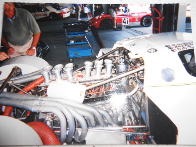

while you are dreamin, check the intake system on this old Jag V12.
its all made of Magnesium, with 12 TBs, and slide throotle plates, electronic FI.
notice the long tapered trumpets, i would say a kool look, nice headers also.
