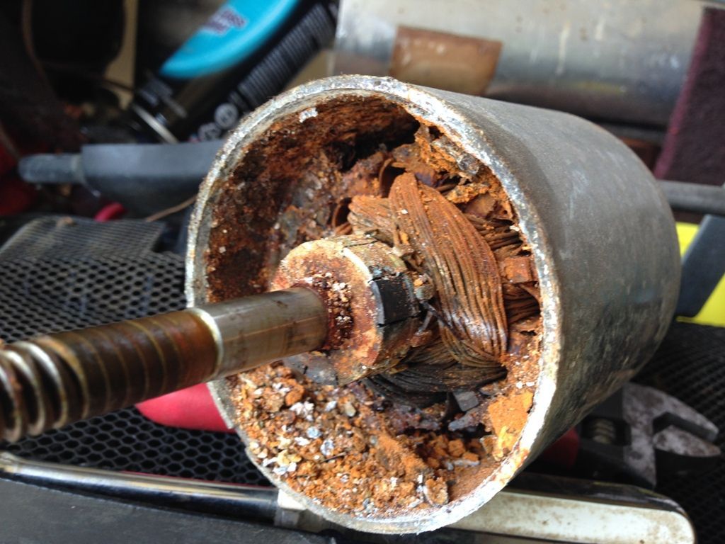

Thank you warrjon and baxtor. The PO had removed the washer bottle and pump from under the right wheel well, he did leave the filler tube. He also replaced the electrolux windshield wiper motor with an old broken one. In fact when I opened the motor housing to see I it could be repaired, the motor was gone.

This is what I found when I opened up the motor housing to see If it could be rebuild the motor.

The electrolux system with the 4 lever actuation system is miles better than the Lucas one with the wheelboxes and Lucas motor that my car has. You can easily buy the entire thing as removed from a car and just put it straight in. It will work properly with your electrics too, which a Lucas one will not (I think you lose the intermittent wipe, and possibly other functions too).
I think that from your pic the PO has shoved in a Lucas system that is incorrect for your model, even if the thing had a motor!

https://cimg8.ibsrv.net/gimg/www.jag...16018b96a4.jpg
Just pulled the wiper motor apart on my 89 XJS..... this looks more like it came off the sunken Titanic, I mean seriously did they have a water injection system into the electrical parts on these cars? LOL **Anybody have a wiper assembly for XJS they want to sell** ???
