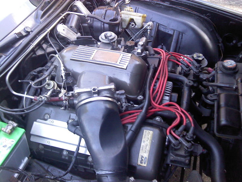

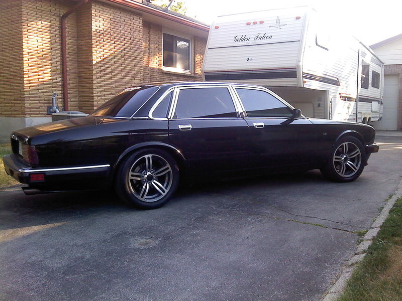

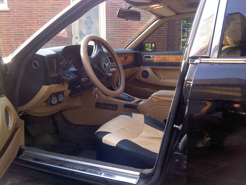

On another note, an acquaintance of mine (who manages a busy 8-bay garage) has done a very nice job of putting a stock Cobra 4.6 and o/d auto into an XJ40. So now it has 305bhp. And it is for sale.
