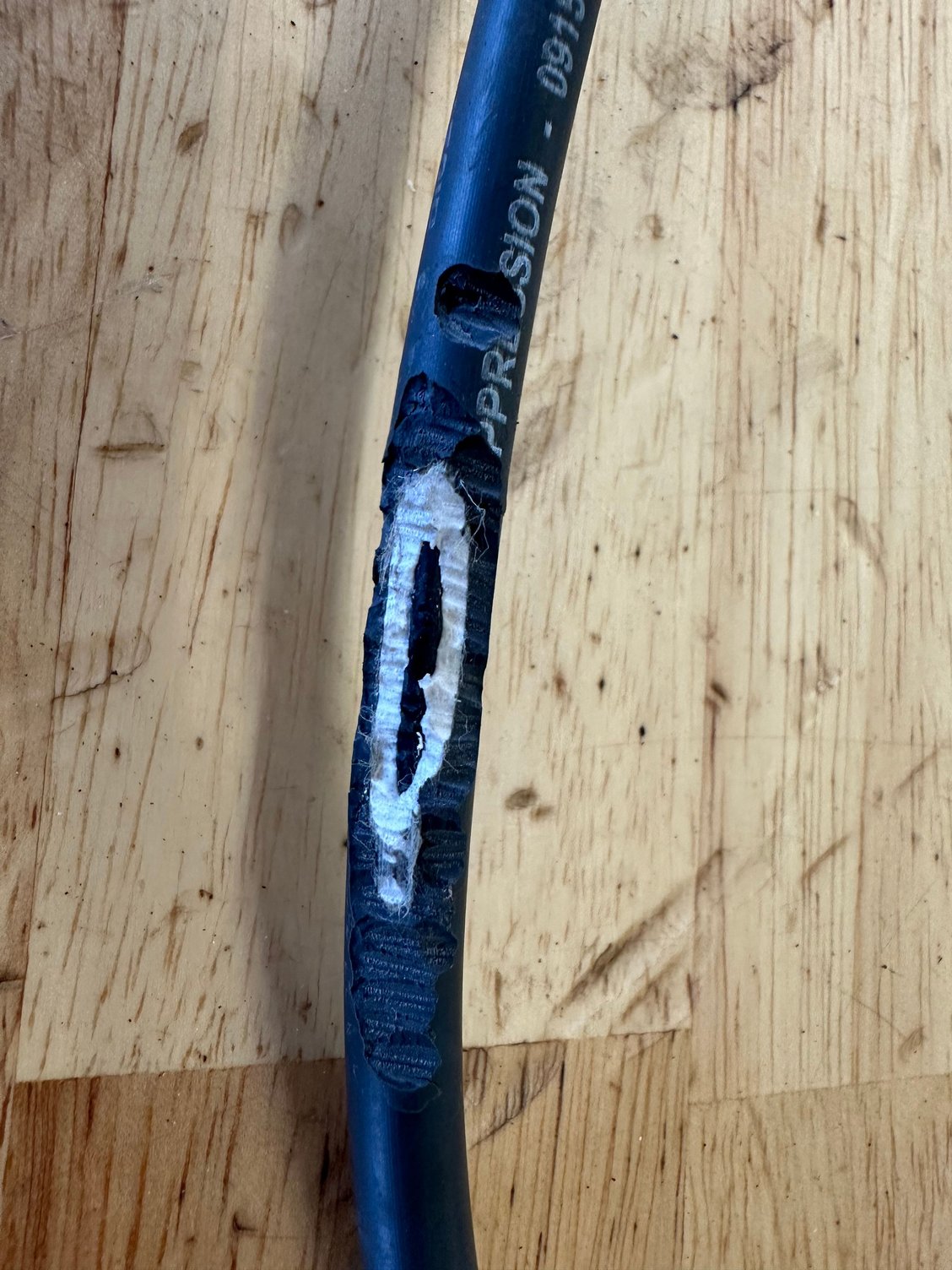

It appears a Washington, DC rat has made a feast of one of the ignition wires. Surprisingly, however, that doesn’t seem to have solved the issue.
I tried unplugging each wire one by one, and that was too subtle of a difference for my powers to detect the miss.
