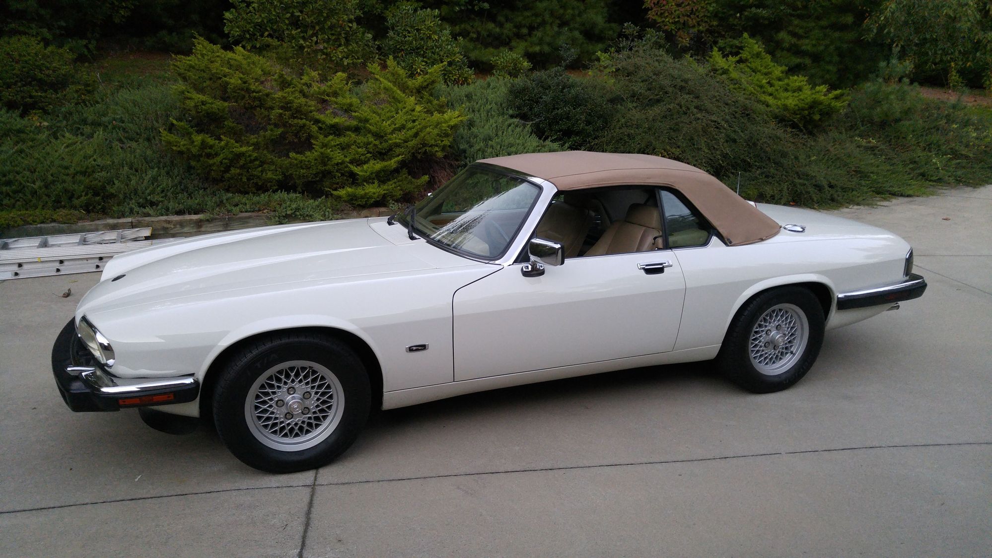

NCJagman Sep 19, 2015 04:39 PM
Replacement keyless entry remote control
Hello.
I just bought a really nice 92 XJS convertible but it came without the keyless entry remotes. Does anyone know if and where I buy two replacement remotes?
I'll post some pictures to add to our XJ8 VDP.
Thanks all.
Stephen
