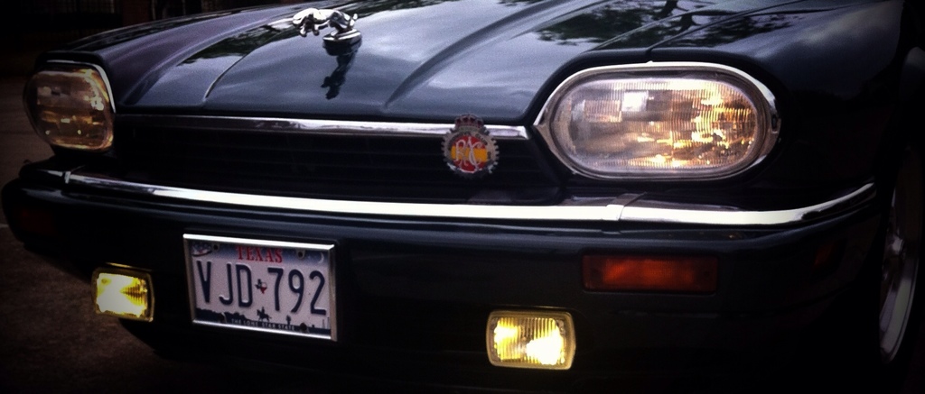

Spikepaga Sep 16, 2014 02:31 PM
1 Attachment(s)
So far the only LED BULBS in my XJS are in the fog-lights which I converted to accept H3 bulbs instead of H2
Attachment 157075
They are there because they don't look like LED's and are a nice warm white color, and because those fog-lights are prone to overheating and cracking. I found those warm white h3 LEDs from a seller on E bay. Granted they are not very functional, but I don't care.
I definitely would not mind LEDs in the interior and in the rear of the cars.
The only LEDs I dislike are the white-bluish tint ones that almost all manufacturers are using in their headlights.
