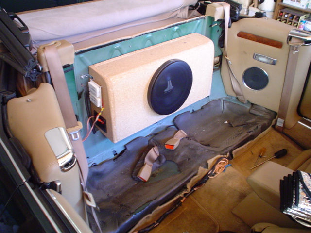

The one place where I would disagree with the above is in the convertible. Mounting a good quality satellite tweeter on the black triangle found on the lower front corner of each window on the door makes a huge difference.
The other issue with the convertible is the rear speaker placement. With them basically firing straight into the back of each seat, highs and vocals get 'lost' or worse delayed before reaching the listener creating a bit of mess.
To get the best sound stage within the limitations of an open top car, the higher mounted tweeters with a crossover to good midrange speakers in the doors, and then set-up the rear storage bin/cubby box speakers only as subwoofers.

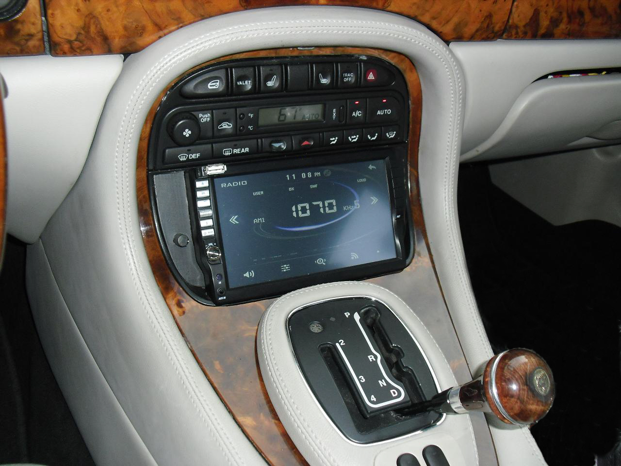

Not sure what i'm going to install in the XJS. I have a double din touchscreen Android unit in my current car & I don't think I can go back to a standard radio...
The XJS is a tricky car in this respect because it will never allow you to install a double DIN radio without major alterations to the traditional dash. However, there is a couple of alternatives for a single DIN unit with a full 7" TFT display.
First, there's the flip screen unit that, on the XJS, it will hit the protruding dash above it, where the trip computer/clock reside, but which Sarc resolved by mounting it a little outwards from the panel as to avoid this problem (see pics on Sarc's post in this thread), which would otherwise cause the display to point downwards.
Second, there used to be so many single DIN head units with displays from 4"+ to 5.4" (at an average $130 to $250) but unfortunately they've just about all disappeared, with the exception of this Lanzar unit SD54MU (see below, yellow 'Vette) that has a 5.4" TFT display, plus all bells and wistles (there's a version with blue tooth), but at a much higher $385. Since my XJS' nice Kenwood head unit is getting old and dated by now, I'm considering a replacement with a TFT display and I'm considering this alternative. I could install this unit on my XJS with its downwards protruding display set at a permanent upwards angle (45 deg?), which will be necessary, regardless, due to the XJS lower radio location.
Just FYI, the 7" display in the picture is only a single DIN unit (on my XJR). Unfortunately with the XJS radio location at the bottom of the console it would be tough to fit, bummer.

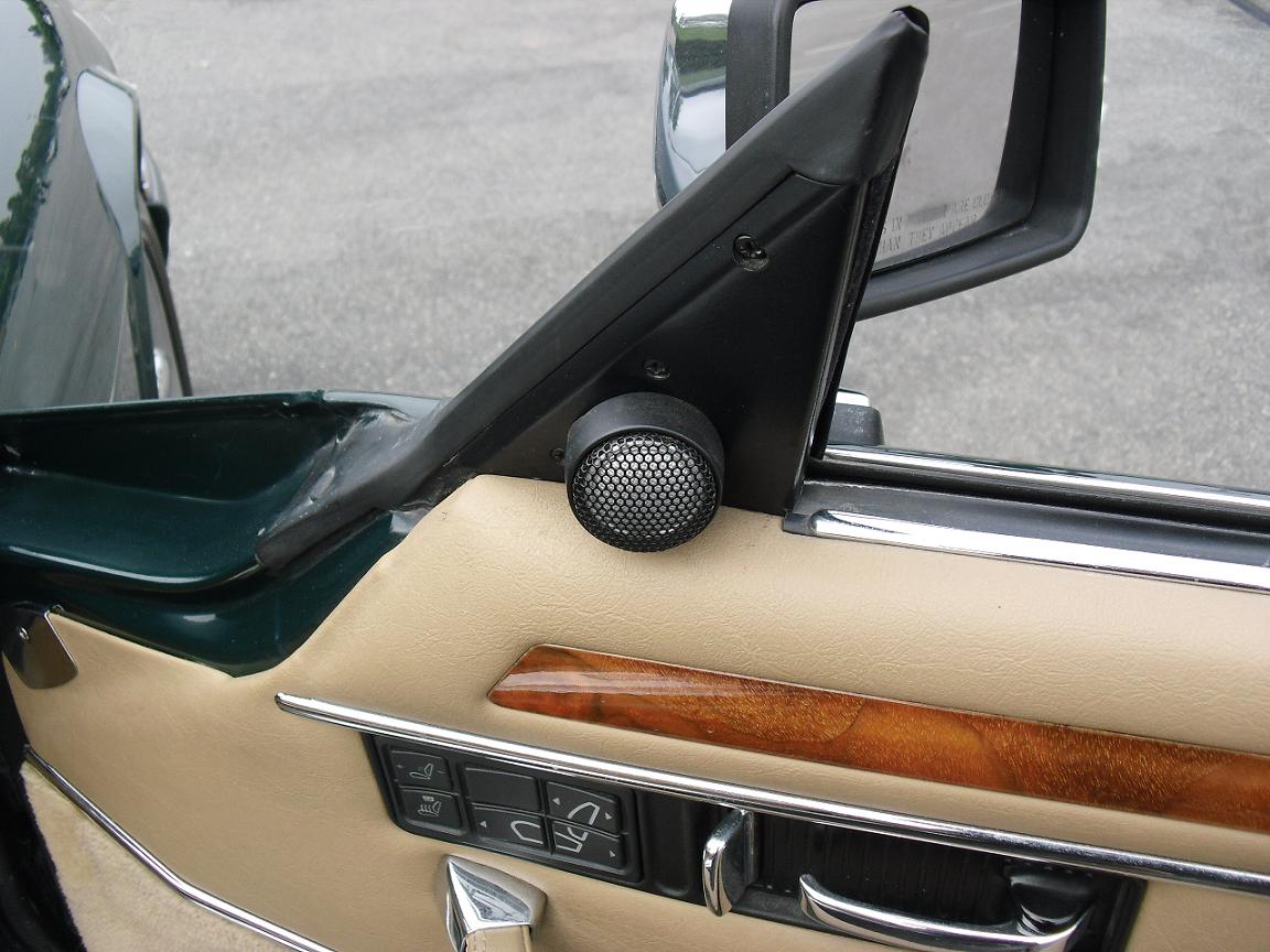

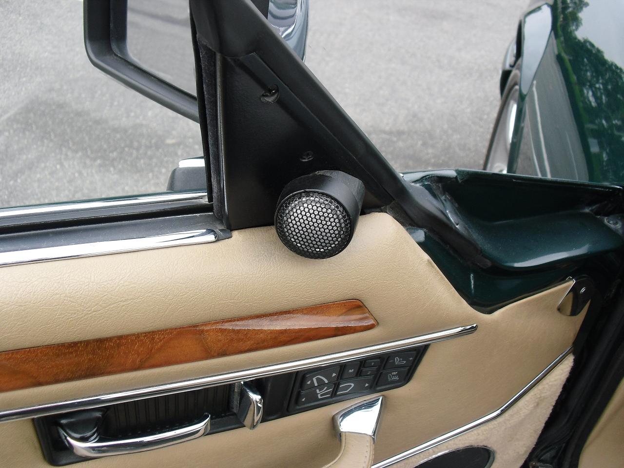

Yes, dedicated tweeters (in this case, JBL) at the A-pillar triangles (see below) with an accurate aim at the driver's ears for the very directional higher frequencies, plus superior stereo separation, sure help. The signal to them is selected by the DSP crossover, as is the signal to the mid range, 6 1/2" Infinity Reference speakers down at the bottom.
I do get your point with the facing rear speakers, but I left the rear Infinity's alone, as I already have a 10" JL Audio, 300 wrms sub-woofer inside the rear seat back cushion (pic below).
Cheers,

I started my working like as an electronics apprentice in the audio industry. I still design and build speakers and amplifiers in my spare time.
Putting the tweeters up high like this will add brightness to the frequency range in the crossover region, unless you add delay to the tweeter. So I we will have to agree to disagree on this one.
Your knowledge is far superior than mine and I wouldn't differ from it, except in this one very special case. It is less an issue of agree/disagree than one of what is the least worse case.
When you are driving a convertible with the top down, the higher mounted and properly aimed tweeters make HUGE difference. Let's face it, a convertible isn't a great platform for a audio, and it's more about whether you can even hear the highs or not, rather than what is the ideal sound stage in perfect conditions.

I also came across this single DIN, in-dash 4.5" detachable LCD touchscreen DVD Receiver with the display fitted in such manner that it splits up and down whatever protrusion there is in height over its single DIN body, thus seriously allowing for installation on the XJS' inconvenient bottom location. It comes with Bluetooth and with both, SD card and USB slots, plus 3.5mm Aux input, etc. The screen is not as big as the Lanzar above (4.5" vs. 5.4") but at a fraction of the price ($104.58 at that Brazilian river place...) and with the XJS dash's relatively close distance from your face, a 4.5" display would seem adequate.
I just actually drew on a piece of paper a 9:6 aspect ratio rectangle that's 4.5" from each corner and I placed it at a distance similar as the XJS radio typically is from my face and I'd say I can easily live with that display. There may be a member here who wouldn't mind having this nice unit in his/her XJS, so I'm glad that I'm able to post this.
BTW and FYI, this is a Power Acoustic unit. Is it comparable to a $450 Sony or Pioneer? I wouldn't know, but the customer's feedback appear to show that the radio is fine for the price. The only thing that I would suspect in a case like this would be the quality of the display, itself, such as brightness in day light, etc. especially when installed on a convertible...
Maybe I'll be able to get some more feedback on the unit.
