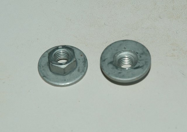

I have a metallic rattle coming from the rear at about 30mph which dissapears when accelerating or decelerating (or momentarily if I go over a bump). I suspect there's a screw or a nut loose in the bottom of the boot (sorry trunk).
I thought I'd found the problem when I fished these 2 nuts out of the bottom of the liftgate
which turned out to be from the spoiler. I stuck them back where they're supposed to be but the rattle didn't really go away.
