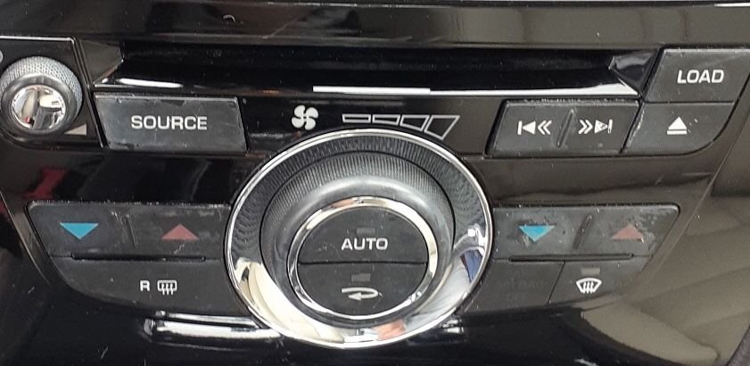

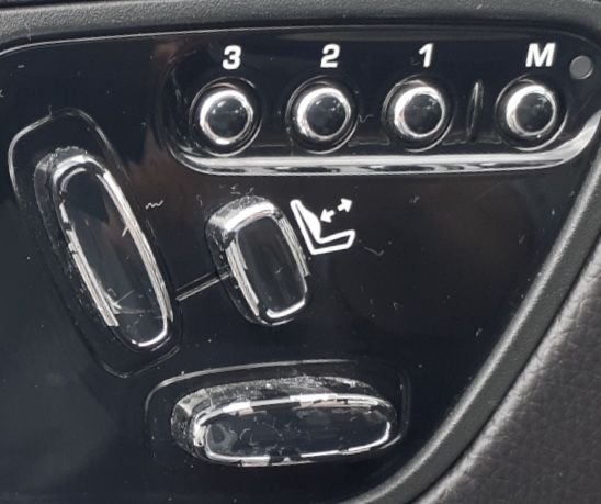

As an FYI, attached are some interior pics of a car I looked at yesterday, 49K miles (if it was to be believed); the interior smell was appalling, the headliner was pealing from the hatch forward and all the internal pieces were as you can see. The exterior was pristine, totally incongruent with the interior. The interior pics of the 100k mile car were a bit better, though not by much, similar fading and flaking.
For perspective, my idea was to upgrade and replace my 115K mile well maintained VW Rabbit with a higher mileage and equally maintained XK to serve as my daily driver (I work from home, so there’s no commute). I have 2 ‘weekend drivers’; a recently purchased 69 XKE FHC and Nissan Figaro. As an FYI, I sold my 16’ F-Type last week - just wasn’t for me.
I’ll keep searching locally to see if a good fit comes along, otherwise, the trustworthy VW keeps chugging along.
As always, opinions and input are much appreciated!

Not sure about jaguar but in Maserati and Ferrari world that's called sticky buttons and a few hours with baby wipes solves the issue.

Interesting, but I prefer an owner who like you recognized the issue and would've addressed it. BTW, is that flaking common, I saw it both second gen cars I looked at, the one with 49K miles, the other with 100k miles? I’ve looked at few first gen cars circa 2007-2008, and I don't see the same issue. Curious.

All my interior buttons and switches are in perfect shape other than the texture on the volume 'wheel' on the steering wheel, which is worn somewhat smoother than the other three 'mouse wheel' type buttons/switches.
Old Jun 29, 2020 | 03:58 PM
Smonop's Avatar
Joined: Apr 2019
Posts: 262
Likes: 45
From: Philadelphia burbs
Got it, it’s not the buttons it’s likely the care or lack thereof that makes the difference. Thanks for chiming in!

My seat control buttons on the driver side look like that, its terrible,
but my passenger side and the rest of the interior is in great condition.
I'm wondering if something was used to clean it that is not suppose to be used.

The most important thing is to buy a car that was loved. Loved means maintained religiously, both mechanically and cosmetically. The sticky buttons ala Ferrari/Maserati should have been repaired or replaced, it's not that awful much money to just replace with used parts (careful shopping should get steering wheel, climate and screen surround, seat switches and such should be 1500 or less used).
