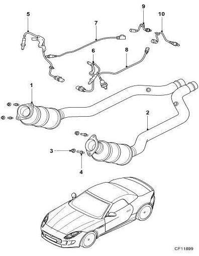

Does anyone know what the configuration of the XKR-S and F-Type exhaust are?
R-S has the Performance Active Exhaust (crossover type)

F-Type pics attached.
Attached Thumbnails 4.2L XKR Exhaust Options-front.jpg   4.2L XKR Exhaust Options-3l-nonactive.jpg   4.2L XKR Exhaust Options-3l-active.jpg   4.2L XKR Exhaust Options-5l-rear.jpg

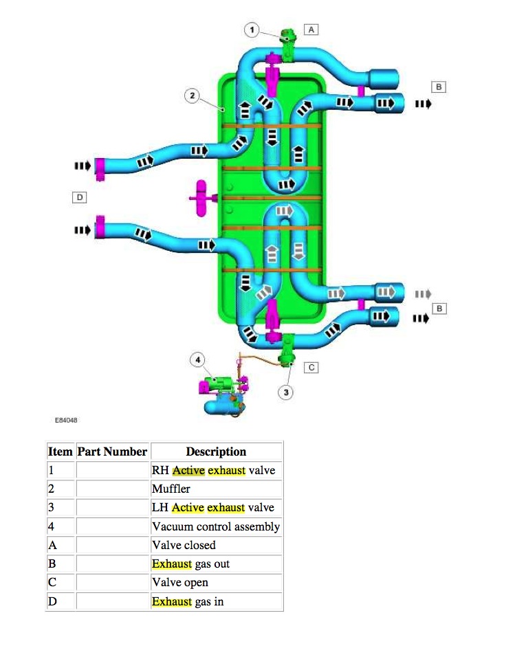

Has anyone opened up the muffler to see if the inside mixes both pipes or is it separate per bank. Meaning does the right pipe connect directly to the right exhaust header and the left to the left.
So the F-Type V8 has a crossover, just like the R-S.
I haven't opened the muffler, but there's a diagram in the 4.2 workshop manual (strangely missing from the 5.0 manual) that shows the exhaust flow as separate:
Attachment 74922
I think he meant that the small silencers in the middle section are internally open, a bit like crossover pipes.
My understanding is that they're not; I gather they're just straight pipes with a couple of boxes full of glass fibre welded on to them so the crossover in the XKR-S and XKR75 Performance Active exhaust is a new thing.
