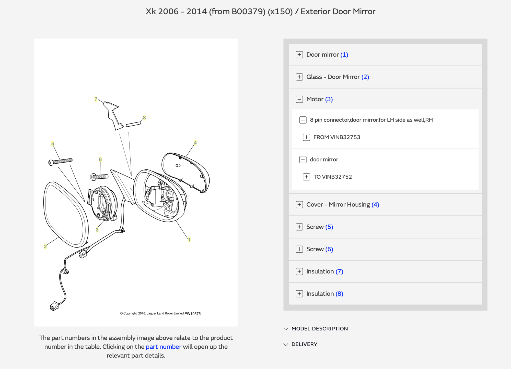

From https://parts.jaguarlandroverclassic.../brand/jaguar/

Yeah my guess as Cee Jay pointed out, the trick will be the harness. And there has to be some sort of control module between.
So Sean said 3-500 + a harness + control, maybe wire in a fuse. May be cost prohibitive…

This for your part numbers....

The motor in this case, is the one that moves the mirror glass (up/down/left/right).
That was my point. My car is less automatic folding mirrors. Thats ok, gives me the opportunity to walk around it and fold them by hand.
