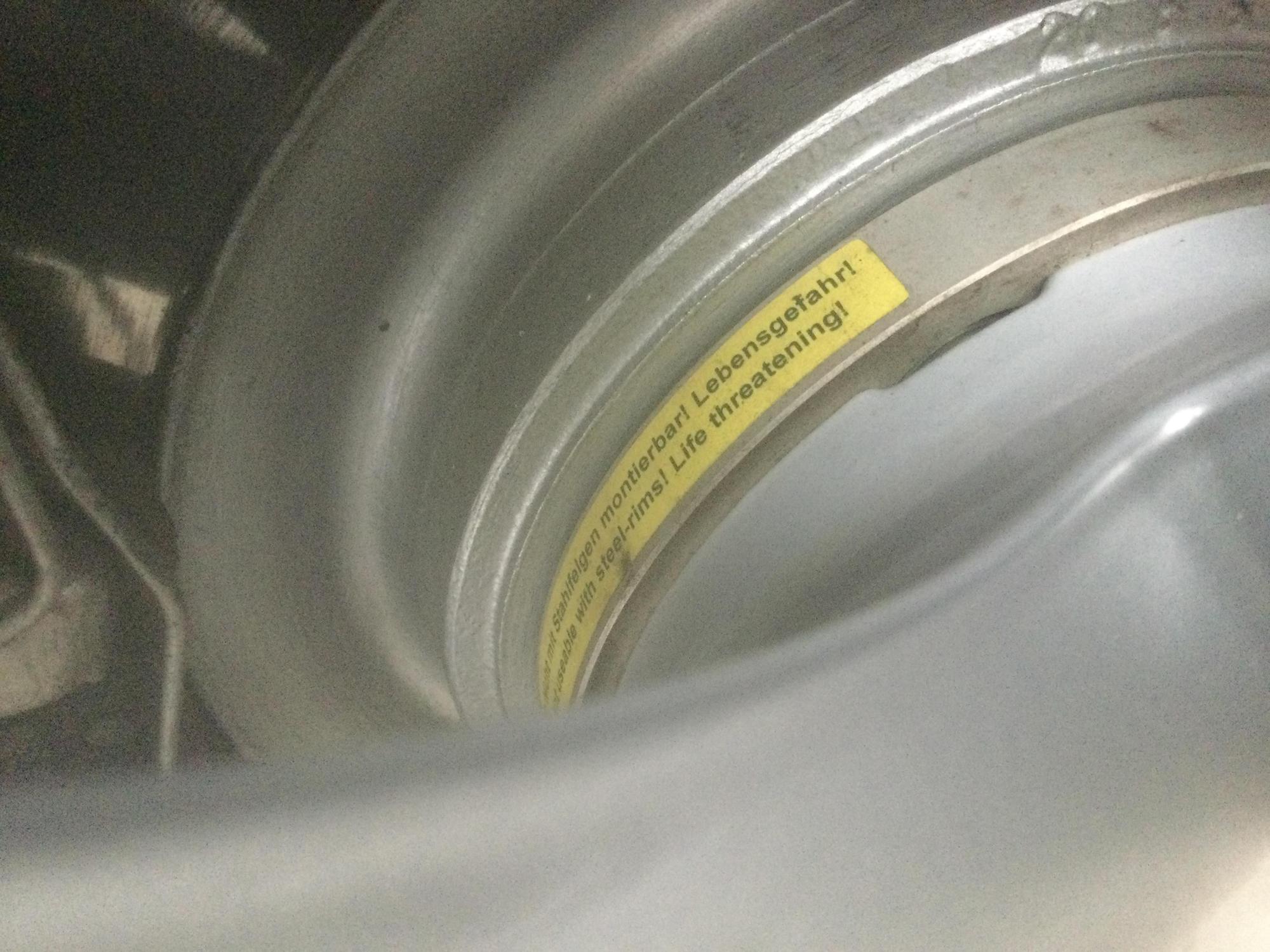

That's what I'm thinking as well. Here a pic the poster on the other forum uploaded. I think it looks like a steel spacer that he's fitted permanently
I don't have any Aluslip but I do have copperslip, would that do instead ??
What do you think ?

I only mentioned Aluslip which I use because I have a thing about seeing Copaslip marks on aluminium wheels. Either are equally effective.
