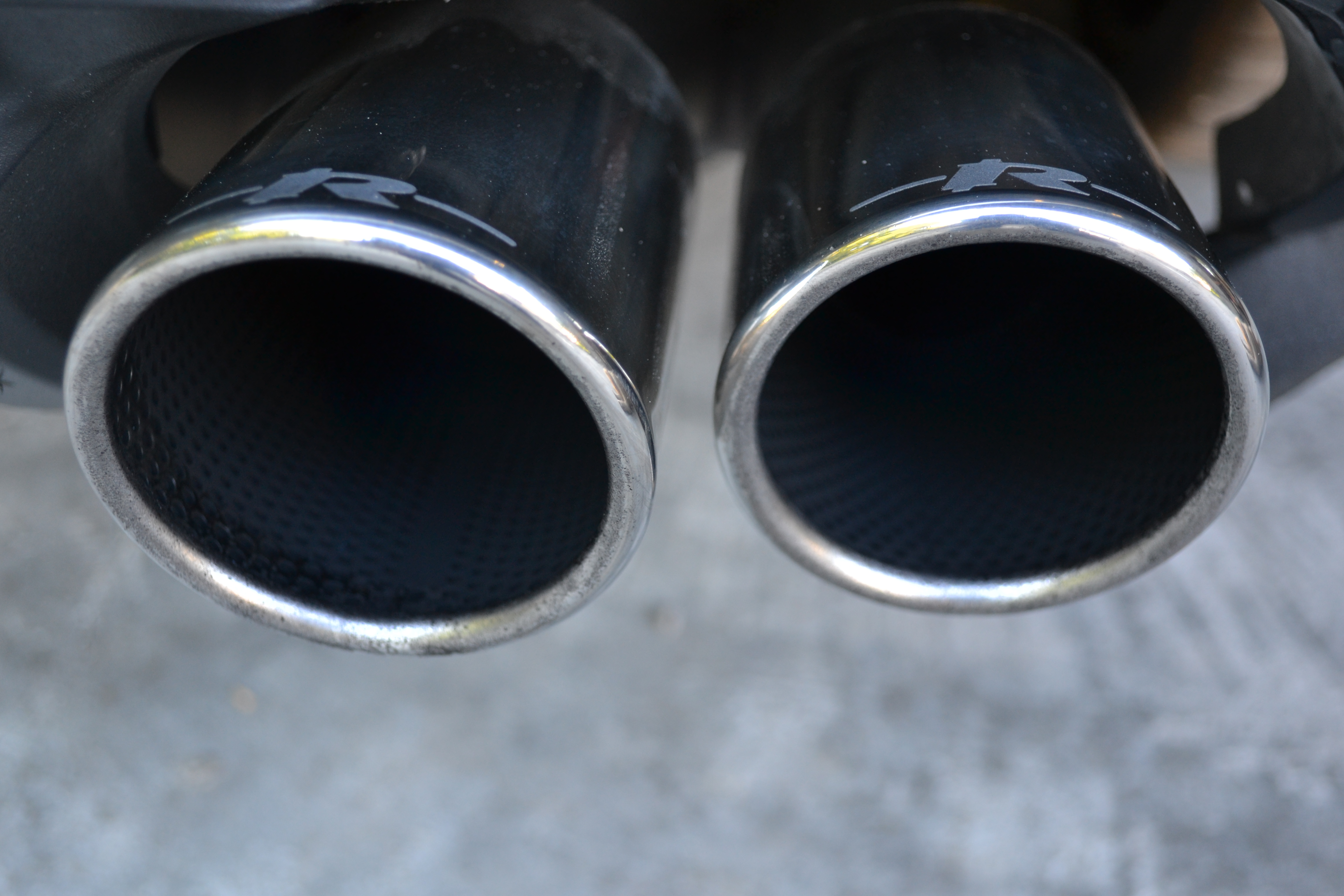

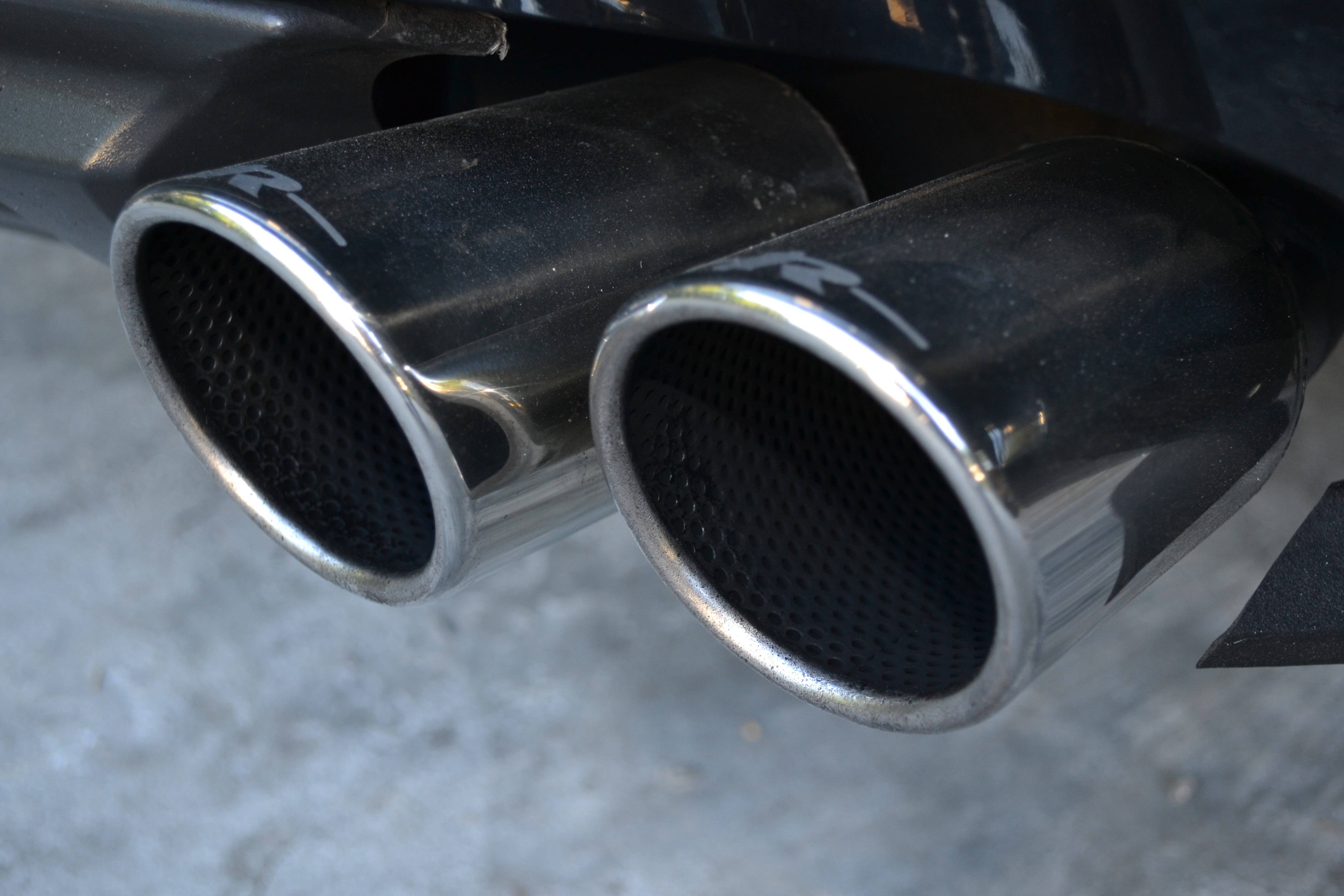

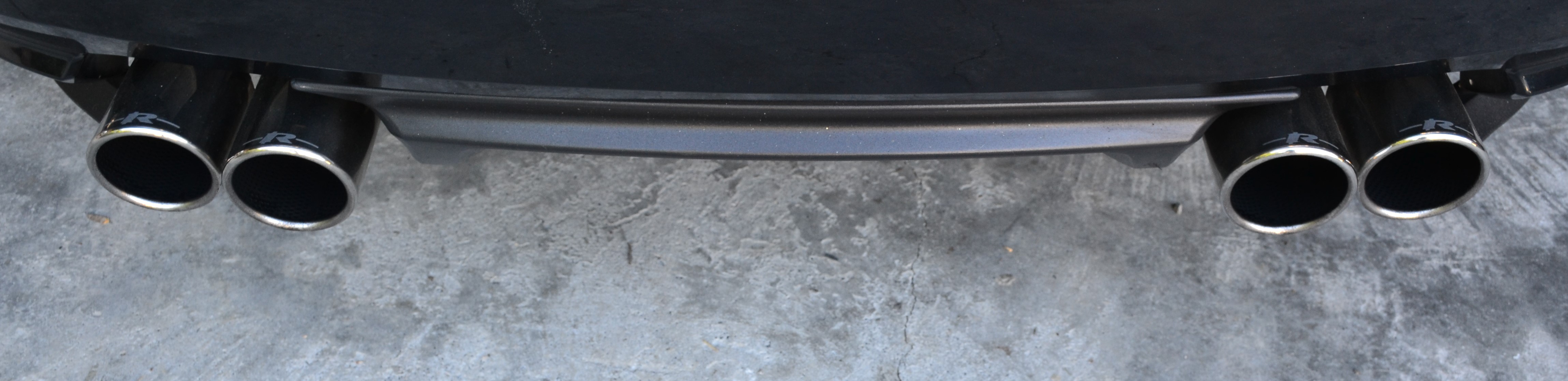

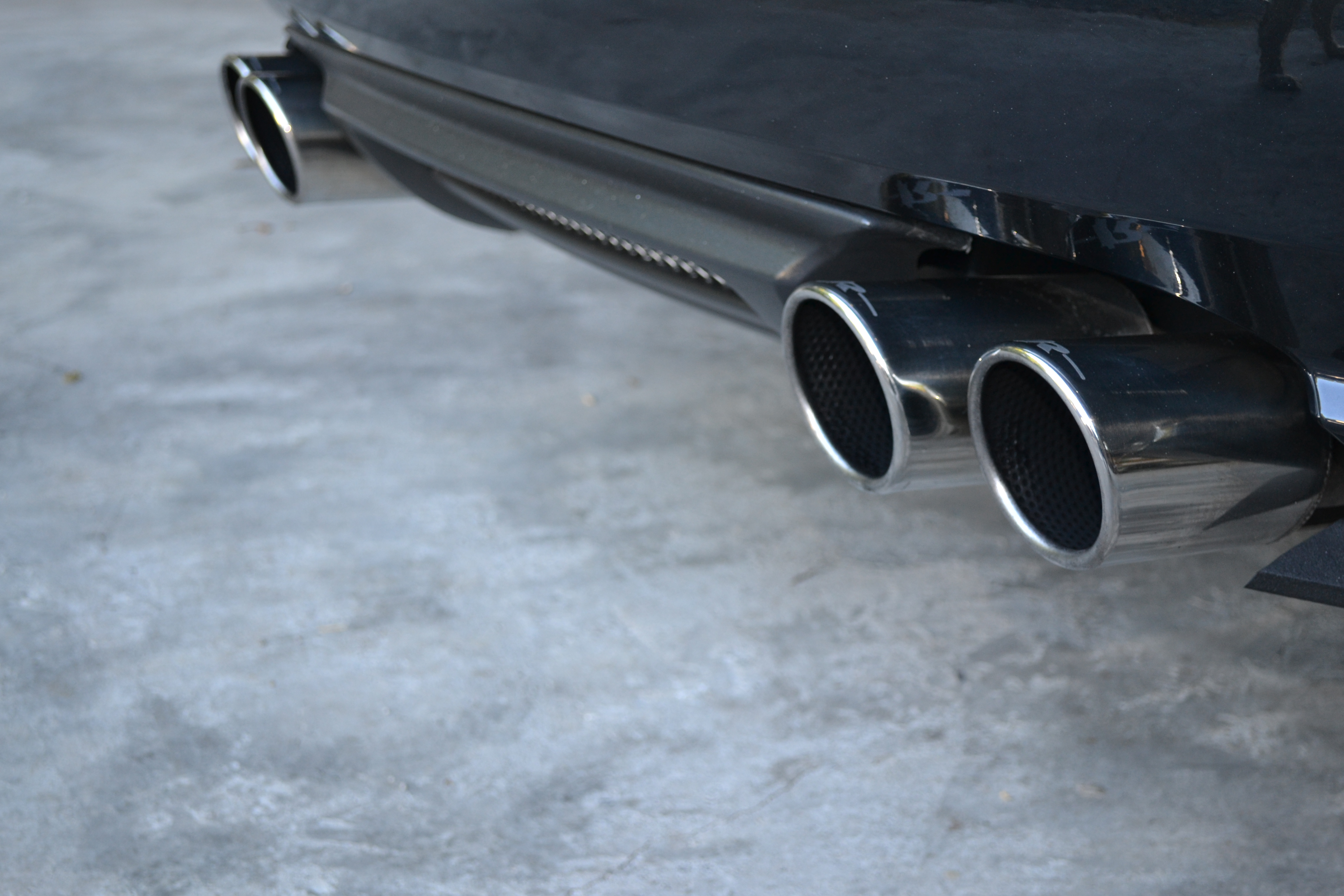

Here's, mine, they are on a Milltek system, Twin dual pipes with perforated holes. Each pipe measures 3.5 inches in diameter. They look nice and big, haven't seen any xkr or s for that matter with bigger rear pipes although my system is all done with 3 inch pipe. Even from far away the pipes look big as in rear picture.

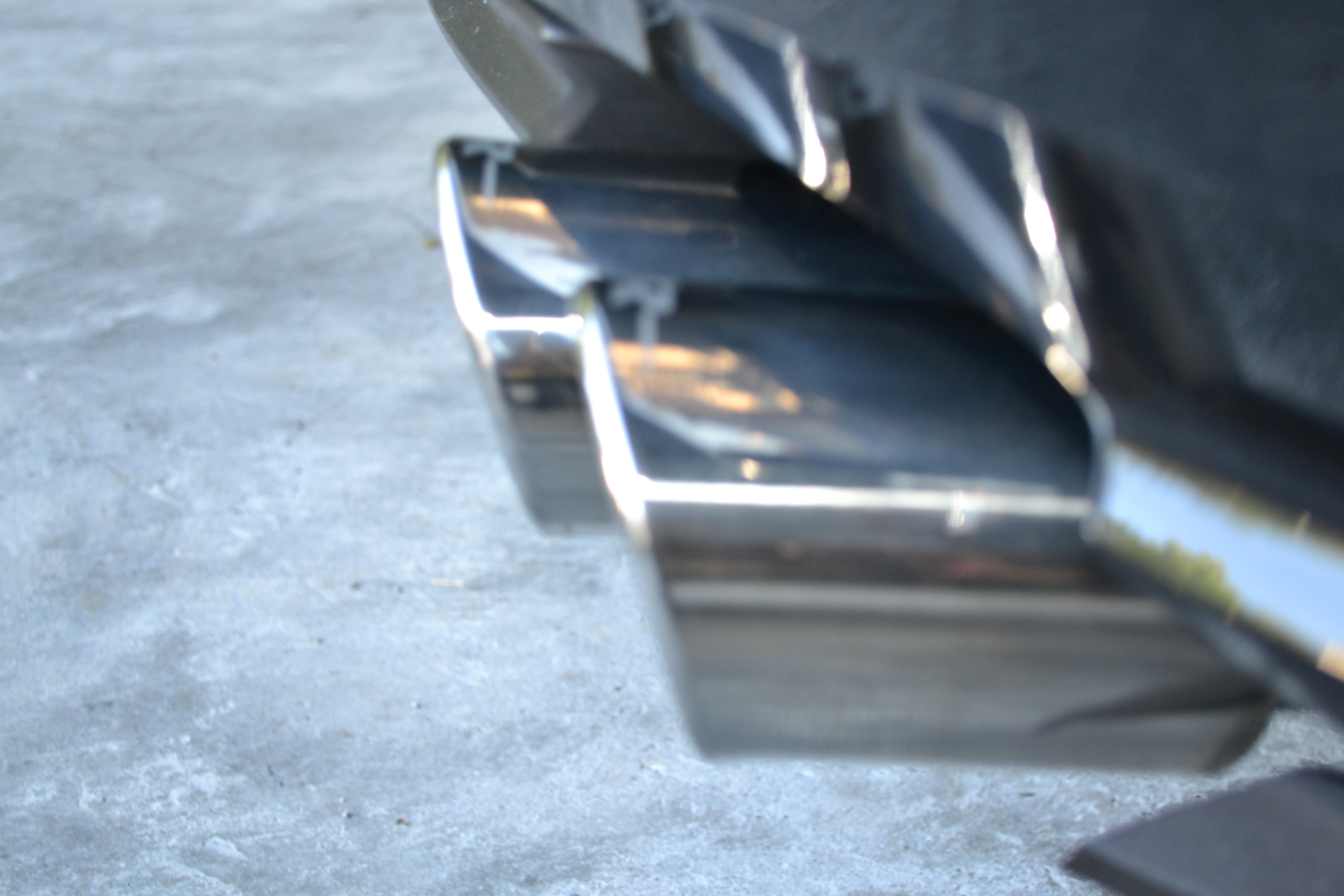

Staggered length tips, that follow contour of the bumper.

very nice.

now THAT is what i'm talking about! are those custom or bought? can I get some specifics? tnx!

+1 Me lika.

They are T304 Stainless, Slant cut, Staggered. I'm using a 3" in and 3.5" split outlet. I'll have to look back at the which vendor made them. There were some on ebay that gave me the idea. WS6 Trans-ams use similar.
The slant cut flows into the angle of the bumper nicely.
Rough Dims below. Kept my system set to minimal bends, thus had a 20 deg exit from mid-pipe segment. Picture below.
Hope this helps.

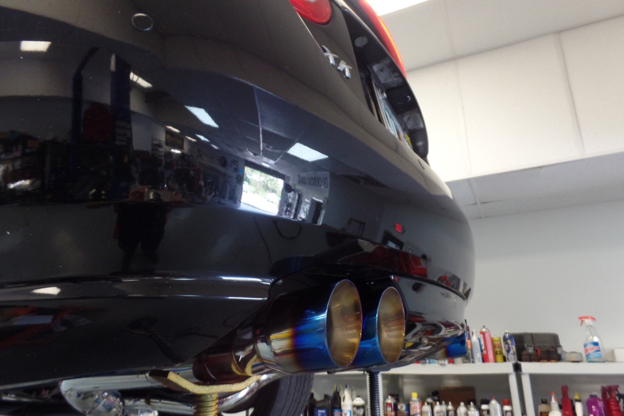

deleted two center boxes, added x-pipe and rear muffler delete

How do you like the sound Guille? I deleted rear muffler but kept 2 center boxes and have been thinking about removing them and adding an X-pipe. Would love to hear a sound clip if you have one.

posted on youtube start up and drive by
