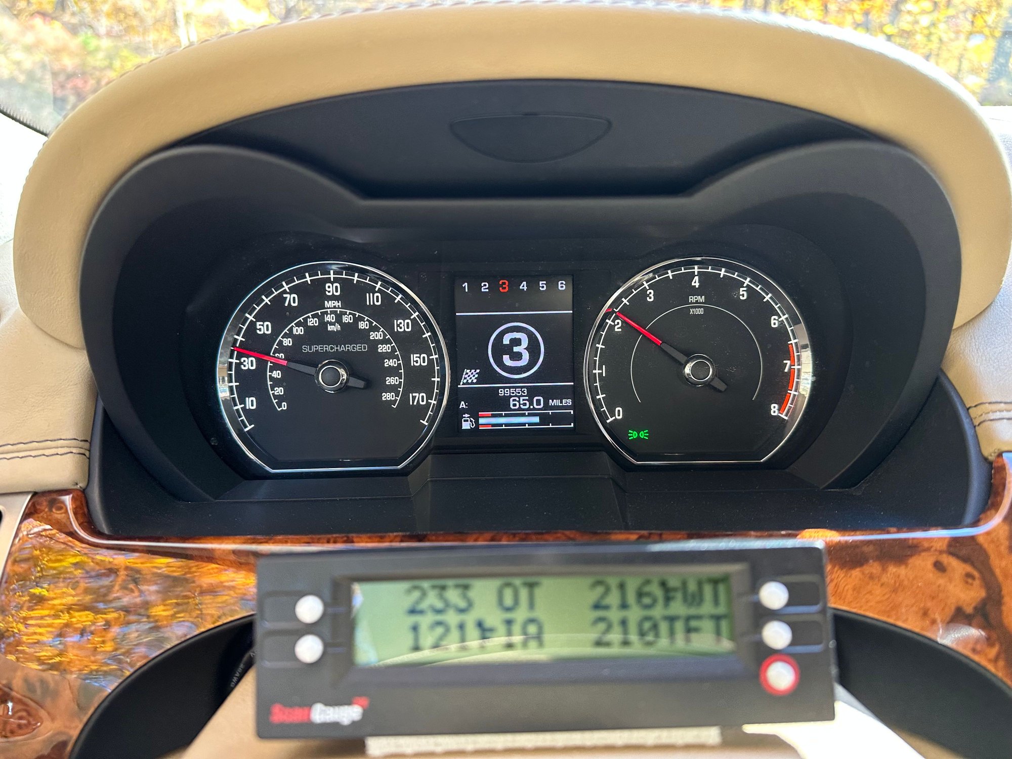

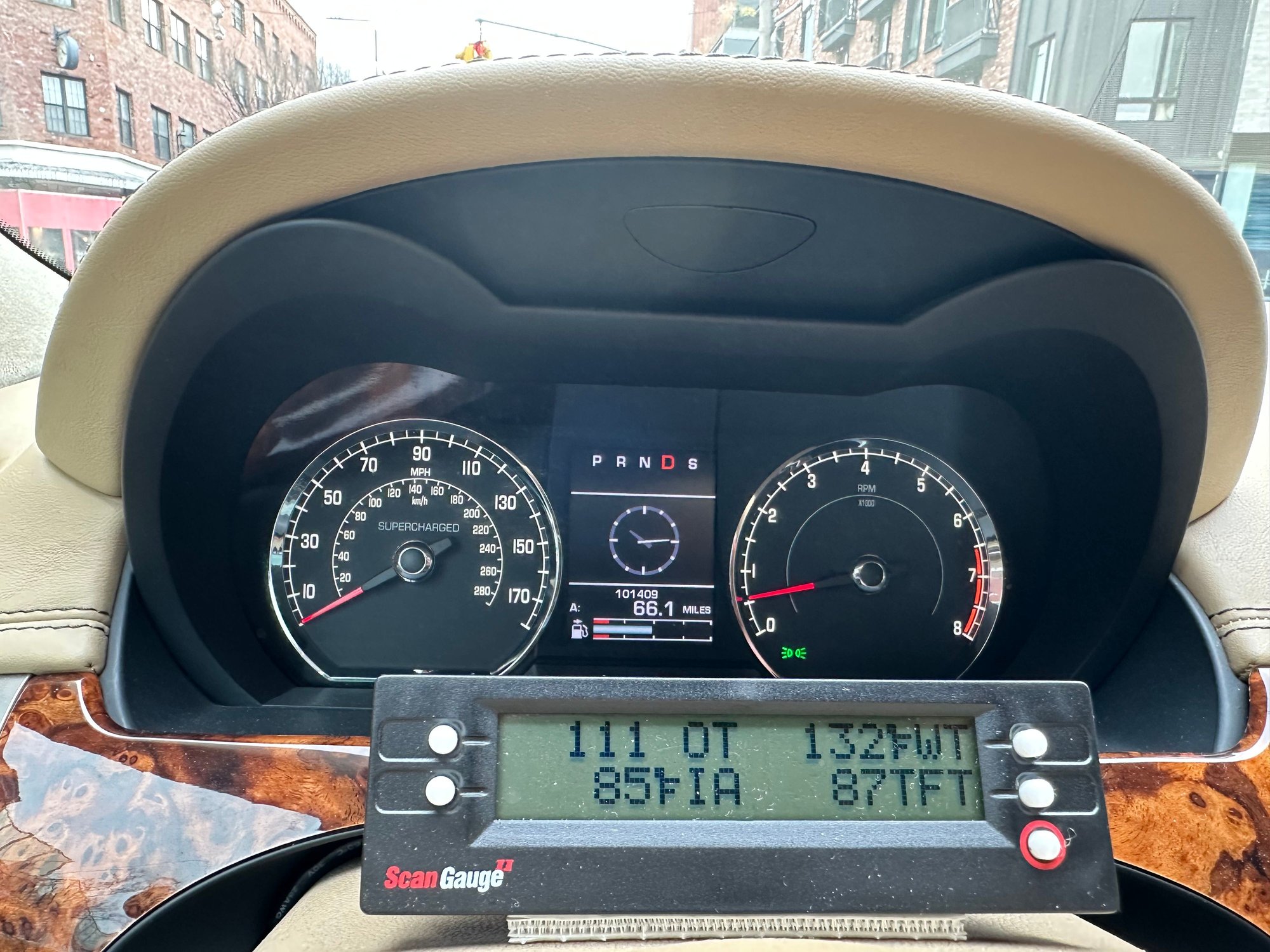

I run a scan gauge
requires some custom coding for jag but the company is helpful and will send the codes
