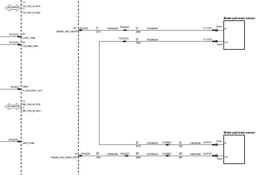

Two - according to the electrical manwell and from the service manwell:
The brake pad wear sensor is wired in series with a wear sensor on the RH rear brake and the instrument cluster. If the
thickness of one of the brake pads connected to a wear sensor decreases to a predetermined limit,
illuminates the brake warning indicator

The brake pad wear sensors, if memory serves, are LH front and RH rear, not all four wheels.

Yep, LH front and RH rear, inner pad only for both.
That's 2 pads out of 8 so not that great but at least it's the inner pads which on modern Jags tend to wear twice as fast as the outer pads.
