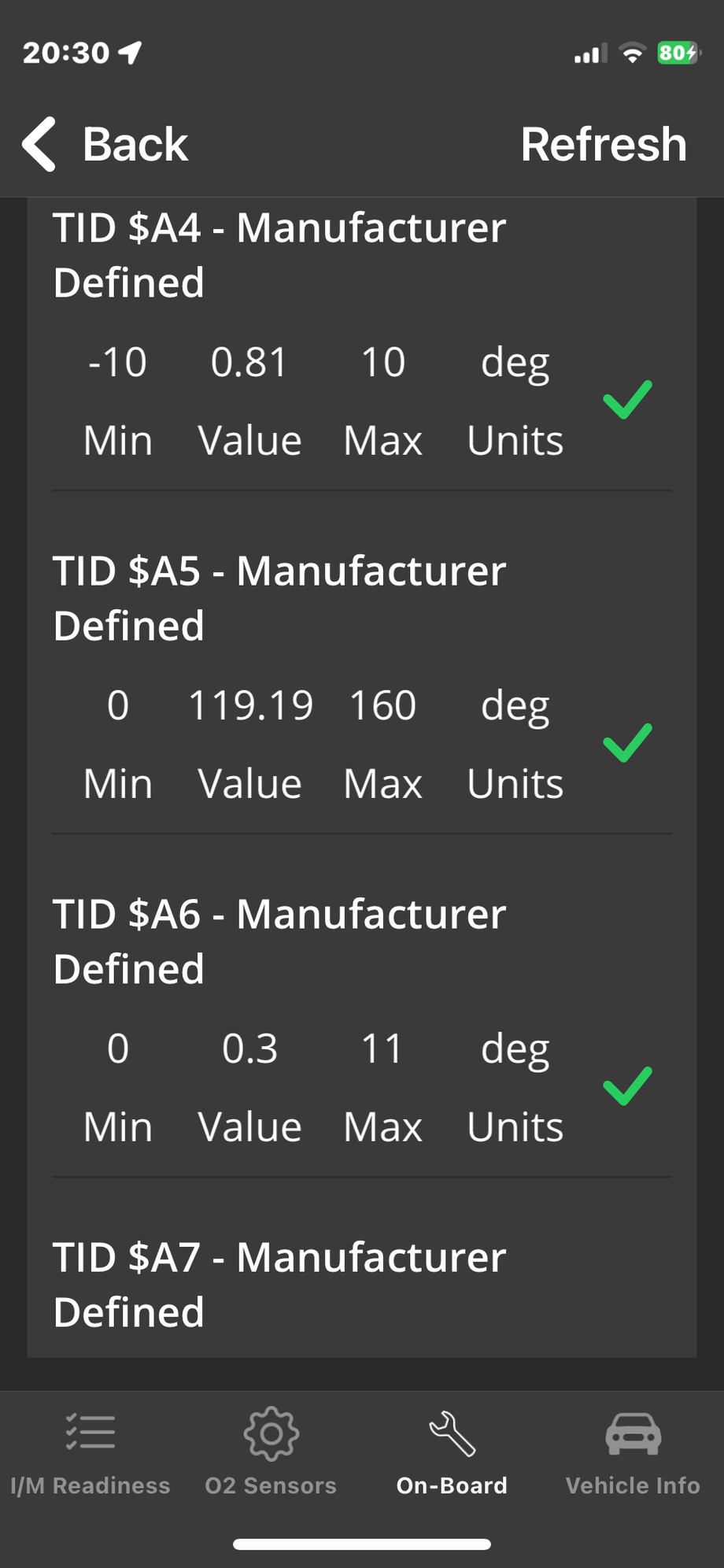

This exactly shows what comes up after clearing and won't clear

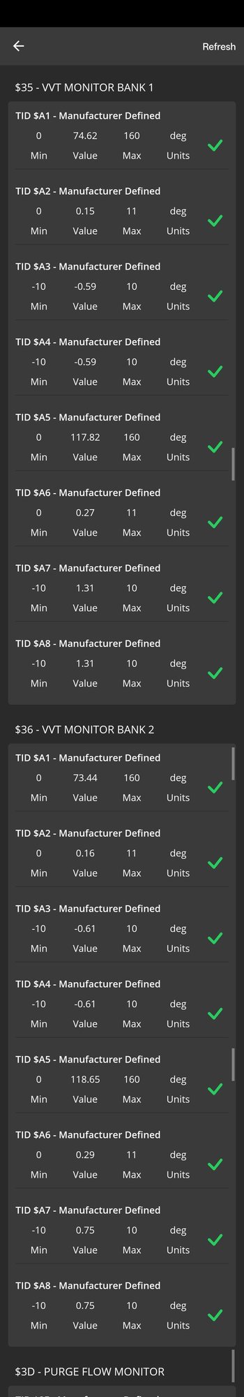

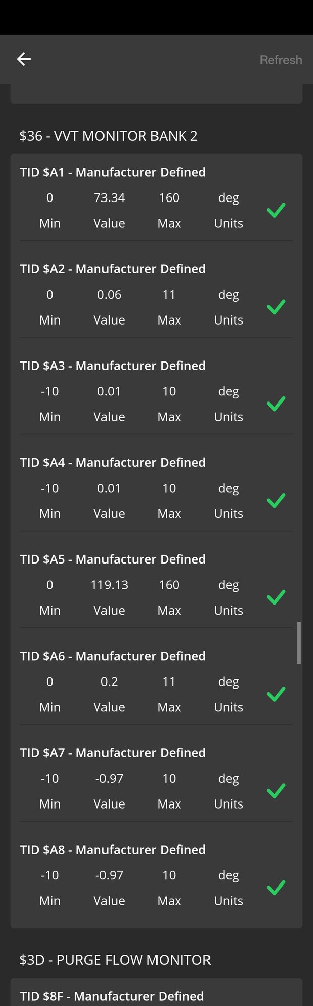

Do you have the ability to read the OBDII monitor data? With OBDFusion you can see the actual data being posted as part of the OBD monitoring cycle. That includes the data on where the camshafts are rotating to and how much of an adjustment bias is being applied. See screenshots attached.
Camshaft position data from the Monitor function on OBDFusion. 2012 XK X150 NA
I'm downloading it now I'll add pictures with what it's showing
I mean everything is within range looks fairly similar to yours in terms of figures
