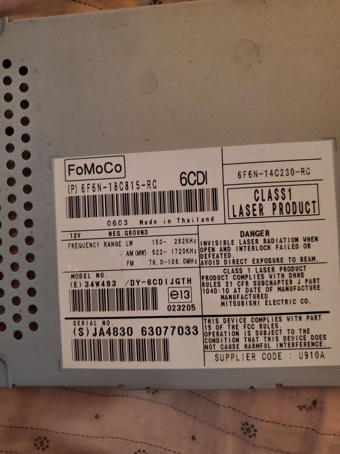

I removed my 6 disc cd player and cross referenced(obviously not well enough)to the post about replacement. I scored a TA however... when replacing I noticed I had extra plug with no spot for connection on the new. I didnt bother to compare the 2 before hand. My CD unit is a 6f6n-14c230-RC w manufacture date "06/03"
I cant find one anywhere. Im so jag damn frustrated. Can anyone please help. The newer TA came with module from a '14 XF
and was only 28$ w S&H. I waited over a week. My battery is dead from sitting w window open in 100° temps So working on that as well.
they look like same unit but why does mine have an extra plug? Possibly the old Nav? Any advice much appreciated. Im "just a girl" with her whole dash apart

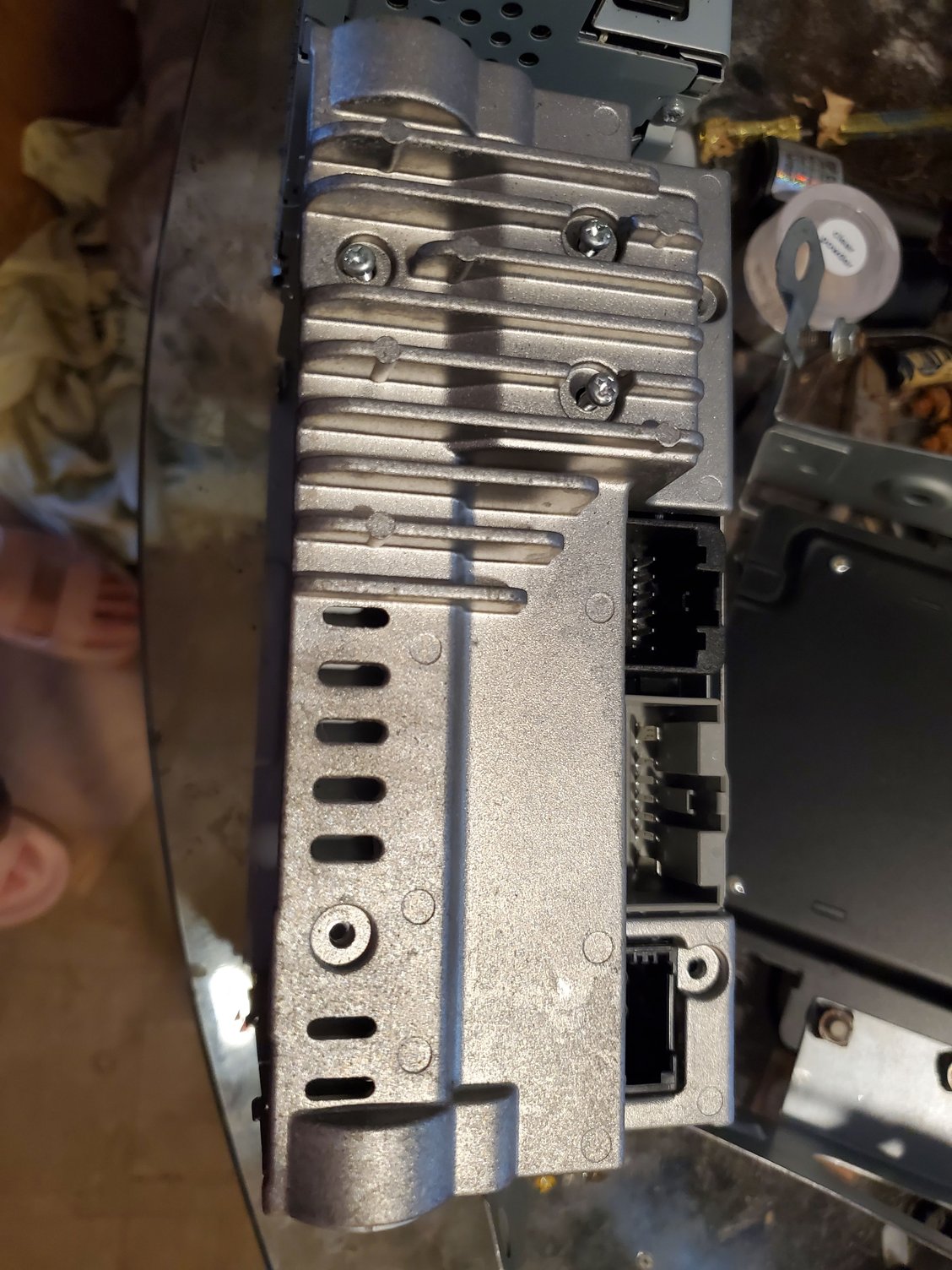

3 plugins vs 2
3 plugins vs 2

I don’t know what a TA is. please clarify. Do you have premium or standard sound system? The pic you show is referred to as the integrated audio module. Connector IP058 has 12 pins and connects to the speakers directly. It applies to the standard system only. Connector IP057 is for antenna, mic, power. Did you try connecting it to test it?

Sorry I meant to put the whole model number in. The replacement I bought was the 6G9N18C815-TA (2 connection) the original is 6F6N-14C230-RC. (3 connection) The pic I posted is of the original connector plugs
Here is the one bought to replace it
Missing the 12 pin (black)

ok thx. You’re pointing to IP058 connector which is used for standard stereo. Those wires are your speaker wires. If you have a standard audio system, you have the wrong player (I think). It’s been a while for me. Please let us know if you have standard audio or premium. I fed those wires into the amp when converting to premium so you must have standard audio.
