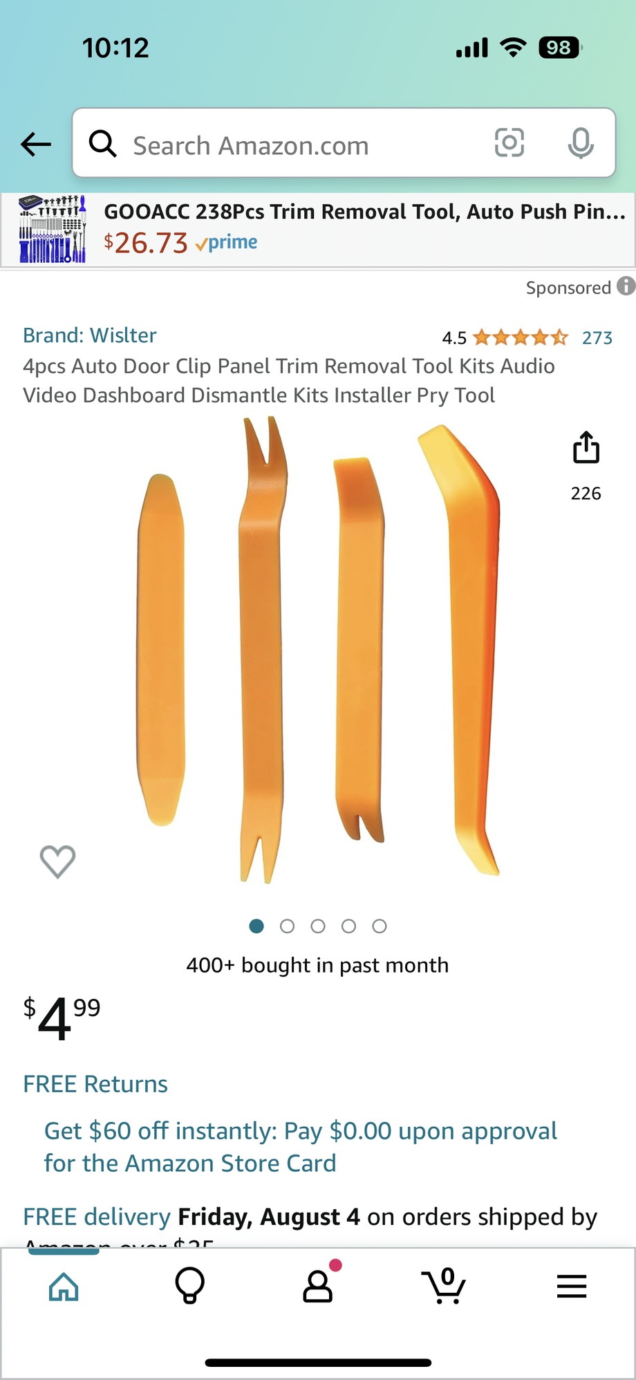

Can you describe or show a photo of the plastic trim removal tool? Something to get from an upholstery shop? In theory, if something thin and non abrasive could get under the lip (even partially), the rest should be able to be lifted and removed.
I'll Bogart this post if'n ya don't mind:

Lots of choices out there. Just google ‘trim removal tool’. You’ll find sets like this for under 5 bucks (bought one like this years ago, used it many many times):

A set of plastic trim removal tools should be in every DIY car owner's toolbox. They make it easy to remove the plastic push-in plastic fasteners that secure the plastic appearance covers in the engine compartment, the carpeted trim in the trunk, and dashboard trim.
Search Amazon. There are lots of choices.
There might not be enough space for a trim removal tool to fit and remove a center cap.

I've tried putting a very sharp thin steak knife uder the edge (only to check the amount of clearance) and let me tell you....Those suckers are in SUPER TIGHT! No clearance whatsoever. Any aggressive prying will most certainly mar the paint which is stupid.I may just punch a hole in the caps and remove them if all else fails. No point in destroying or damaging an expensive painted wheel.
