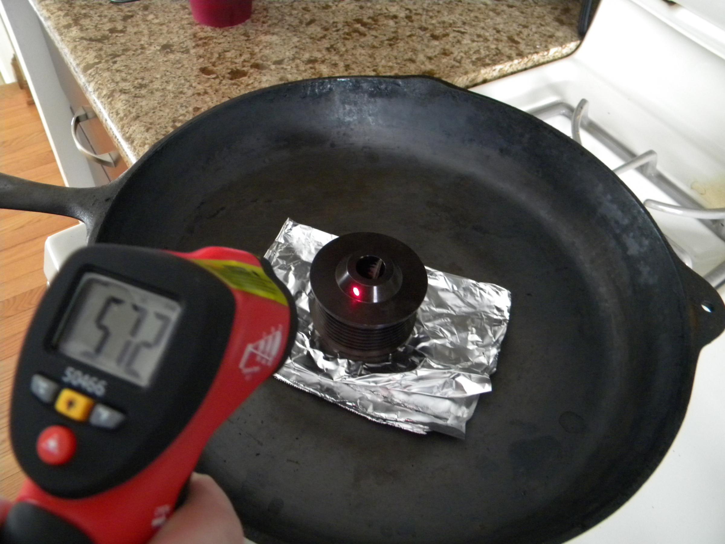

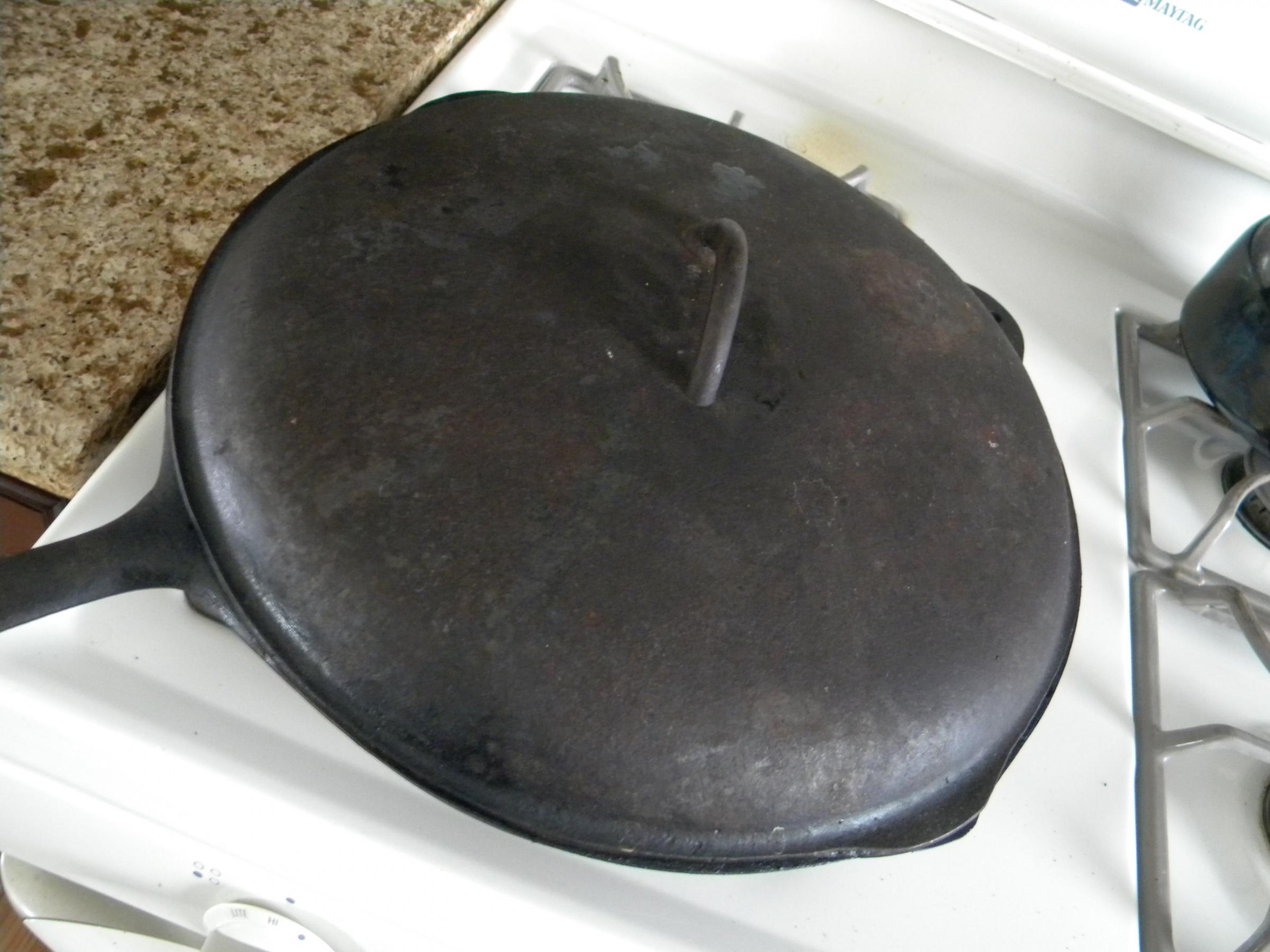

Time to put the Mina pulley on the 13 xkr ragtop shaft. Chris at mina suggested to put the pulley in the oven at 550 degrees. But I am too impatient. So I grabbed a cast iron coverd pan out of the barn at my dad's that is older than Methusela . (The pan . Not my dad) I put it on the stove and put the burner on thermonuclear. I used a digital thermometer that has a non-contact laser on it so I would know where the temp is at. The red dot on the pulley in the pics is the laser. U can see that I got it up to temp easily. Any pan would work I am sure. However I dont suggest using a Calphalon or other hi-line pan to cook car parts. this wouldnt be fair to your wife or girl. I will post the other pics of the pulley on the shaft and what to do in order to prevent a night mare

Dinner is served ... nom nom

I dont understand your response. The pulley has to be heated so the the diameter of the pulley is much larger than the shaft. The pulley is a press on fit with a friction hold. Once the pulley cools down the pulley wont come off or spinn cause it is loose. The diameter of the pulley shrinks by a few thousands and then it holds. There is no other way to put this pulley on other than heating it up. If your response is to make fun of me cause I am a girl that works on cars that ok too. My directions to you, and you only, to replace a pulley would be to heat it with an oxy-acety torch or to take a sledge hammer to the pulley to get it on the shaft . That way you wouldnt have to heat it in a pan or the oven. Feel free to call Chris at Mina and let him know that u might have a different thought on how to apply the pulley without heating it. Feel free to let the moderator know or the administrator that this is the advice I gave you and you only. I am not a car enthusiast. I am a hands on car aficianado (sp). Big difference

just tongue in cheek response to the pictures with a pulley in the frying pan ... nothing more nothing less

Got the pulley on OK. Thanks for your support. you r one of the only people taht has supported my posts. I greatly appreciate that. I used 80 weight gear oil on the shaft before I slid the hole onto the shaft. I used mirror fine paper to scuff up the pulley and shaft prior to sliding on the pulley. I heated the pulley to 600 degrees prior to sliding it on. I used the gear oil cause that was the only thing within my reach. I would suggest never using synthetic oil or Mystic gear grease as these wont melt under 700 degrees. I would be concerned that the pulley mite slip if these were used. Why did I lube the shaft?? Cause I didnt want to put a dry shaft into a dry hole and expect it not to bind up. The worst thing that could have happened here would be to get the pulley on half way and then get stuck on the shaft. Like my bf, the financial analyst always says, "Time is a commodity that can never be regained , once it is lost" I dont have the time to fix a second mess. The first was bad enough and it cost a bunch of time. I havent decided on who for a tune. I will let u know what I am gonna do. One of the ferrari guys at my bf office found a company that will sell me a OBD tune that I can use over and over again that is registered to my VIN. I havent found the time to do my due diligence Once again, thanks for your support. I m gonna post pics soon on the pulley upgrade

I used oven gloves that had fireplace wrap around the thumb. I held the pulley on and poured water on the snout of the blower untill it cooled down. I used that digital laser thermometer as I had in another post and let go of pulley when it reached 150 degrees
