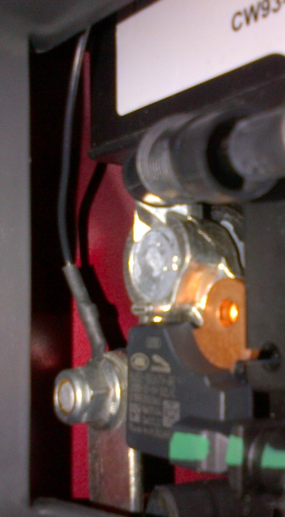

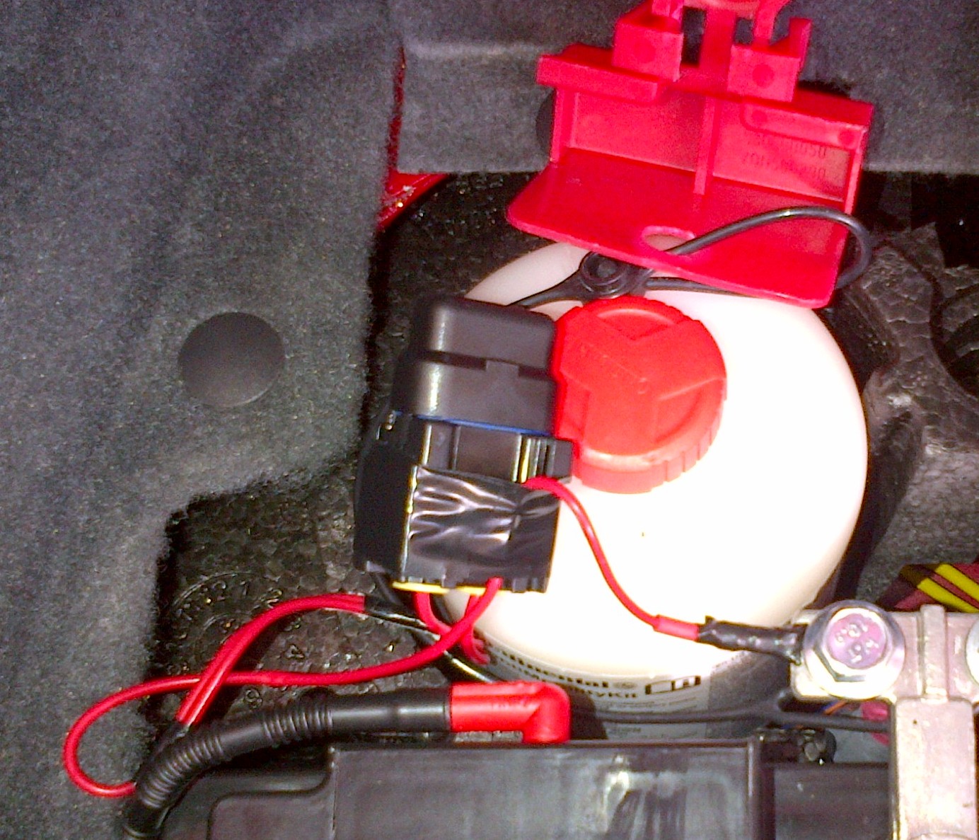

All reading at the posts on the LH battery.
Engine off, door and trunk open. 3300 disconnected:
Battery reads 12.6V
Engine on, door and trunk open, 3300 disconnected:
Battery reads 14.5 after 1- 2 minutes
Engine off, door and trunk closed and locked, 3300 connected, amber charge light on:
Battery read 12.6 v immediately but after 15 min is 13V.
Charger is wired directly to the posts on the main (LH) battery. See pics, small wire is charger.

Now I know that the dealer hooked it up but I seem to recall someone on this form mentioned that you do not hook up the + side directly to the battery. I forgot why (CRS) but they mentioned you had to hook it up to the post in the trunk. Maybe the F-Type doesn't the same arrangement as the XK.
As for the XKR. 2009 or earlier MY with 4.2L can be hooked up directly to the battery posts CTEK red to positive terminal, CTEK black to negative post.
Later MY's 2010 and beyond, hook the positive CTEK red lead to the positive terminal and put the black negative to a ground bolt.
There is a module on the 5.0L XKR that suggests the battery maintainer be connected to a ground bolt, not negative terminal.
Not sure at all about the F-Type as I have no experience with them.

Just checked it and it was still amber. I unplugged it to add in an extension I just picked up and when I plugged it back in it went green. Unplugged it and moved the car over in the garage and it went back amber again. Nothing on as far I can tell. The top is up doors and trunk closed and locked. At this point I'm just gong to keep it going and I have any battery trouble will go back to the dealer. Weird.
Old Nov 30, 2014 | 04:57 AM
  #216
Ngarara's Avatar
Posts: 3,425
Likes: 1,140
From: London, UK
The module on 5.0 cars is the battery monitor, which is attached between the car and the negative battery terminal and (as the name suggests) keeps an eye on the battery's state of charge - if the output is low, it tells the ECU, which can then start turning off nonessential services in order to keep the car running. If you connect a charger or tender directly to the negative terminal, the monitor cannot 'see' the charge going in to the battery because the current does not flow through it, so it gets an incorrect indication of the state of charge.
I would assume that the 5.0 F-Type has the same (or a similar) module, since it seems to be a part of the 5.0 system.
That would explain a lot. I will modify the installation and report back.
Thanks very much for this info. Wish the dealer knew.
