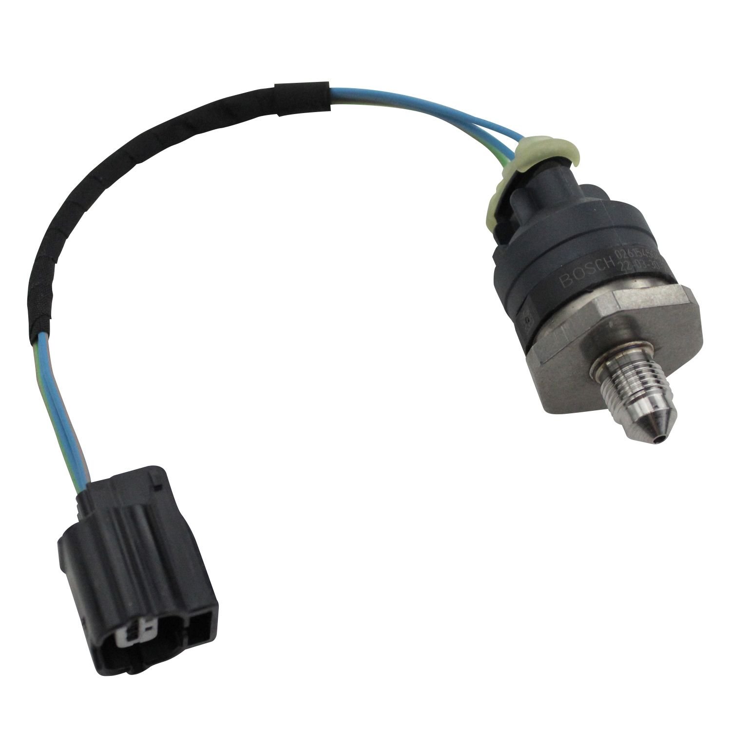

Is this the FPS? It's at the end of the fuel rail.

Originally Posted by billqs
provided you take the time to release the pressure in the fuel rail first.
Pretty easy. IIRC, with the engine running, pull the fuel pump fuse.

It says the fuel pump fuse is F33 located in the rear seat compartment fuse box. We pulled it, but the car never sputtered out. Is there another fuse that should be pulled so we can depressurize the fuel rails?

Does anyone know the size of the socket to get the FPS off? I thought it was a deep well 15/16 but that is not big enough to turn the sensor.
Metric 27 Deep Well socket will remove the FPS on the 5.0 liter XK engine. It looks like this... We could not figure out how to remove the wire harness which made using a deep well socket kind of tough on the wires. Does anyone know if it is supposed to be removable?
