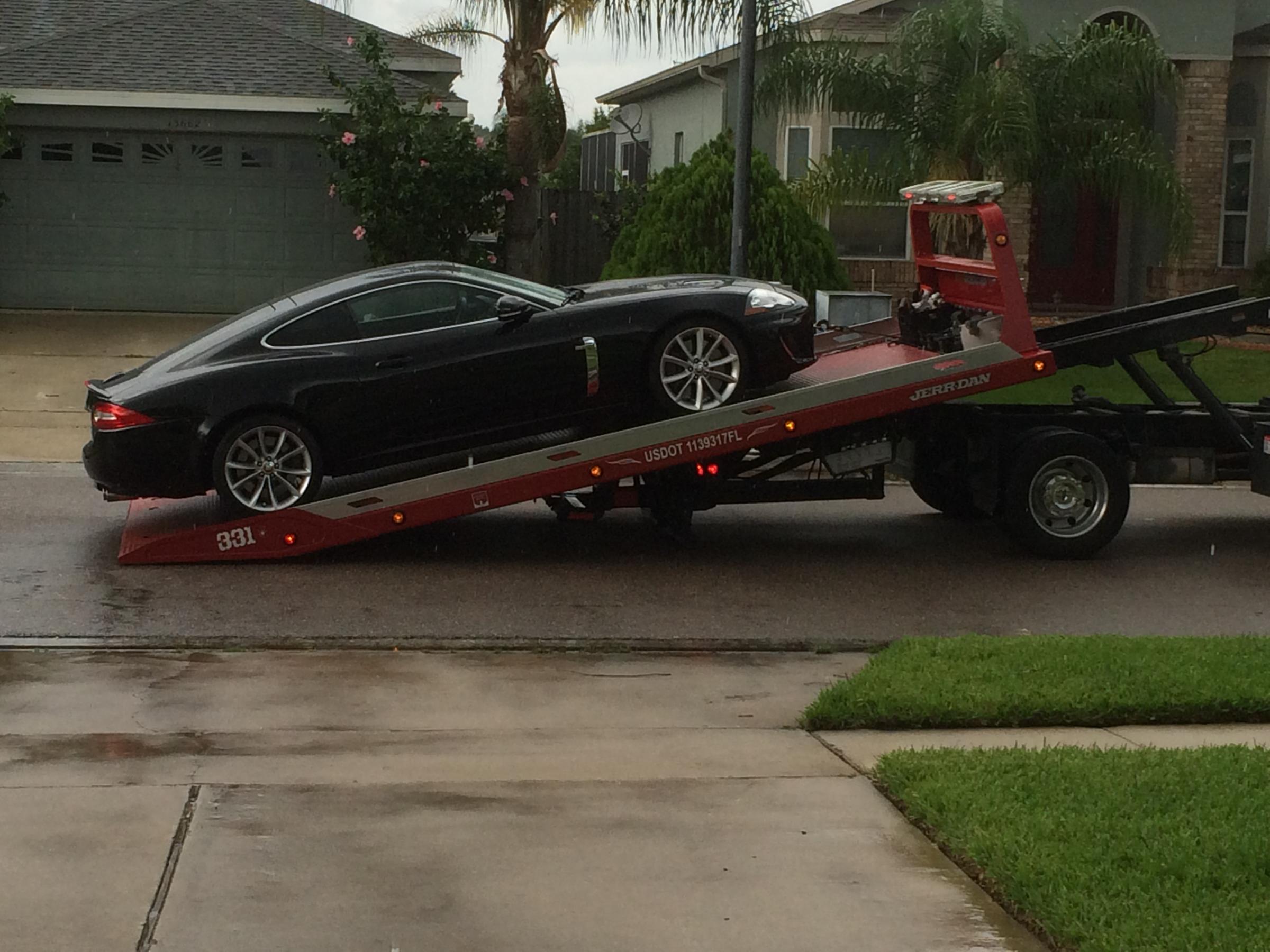

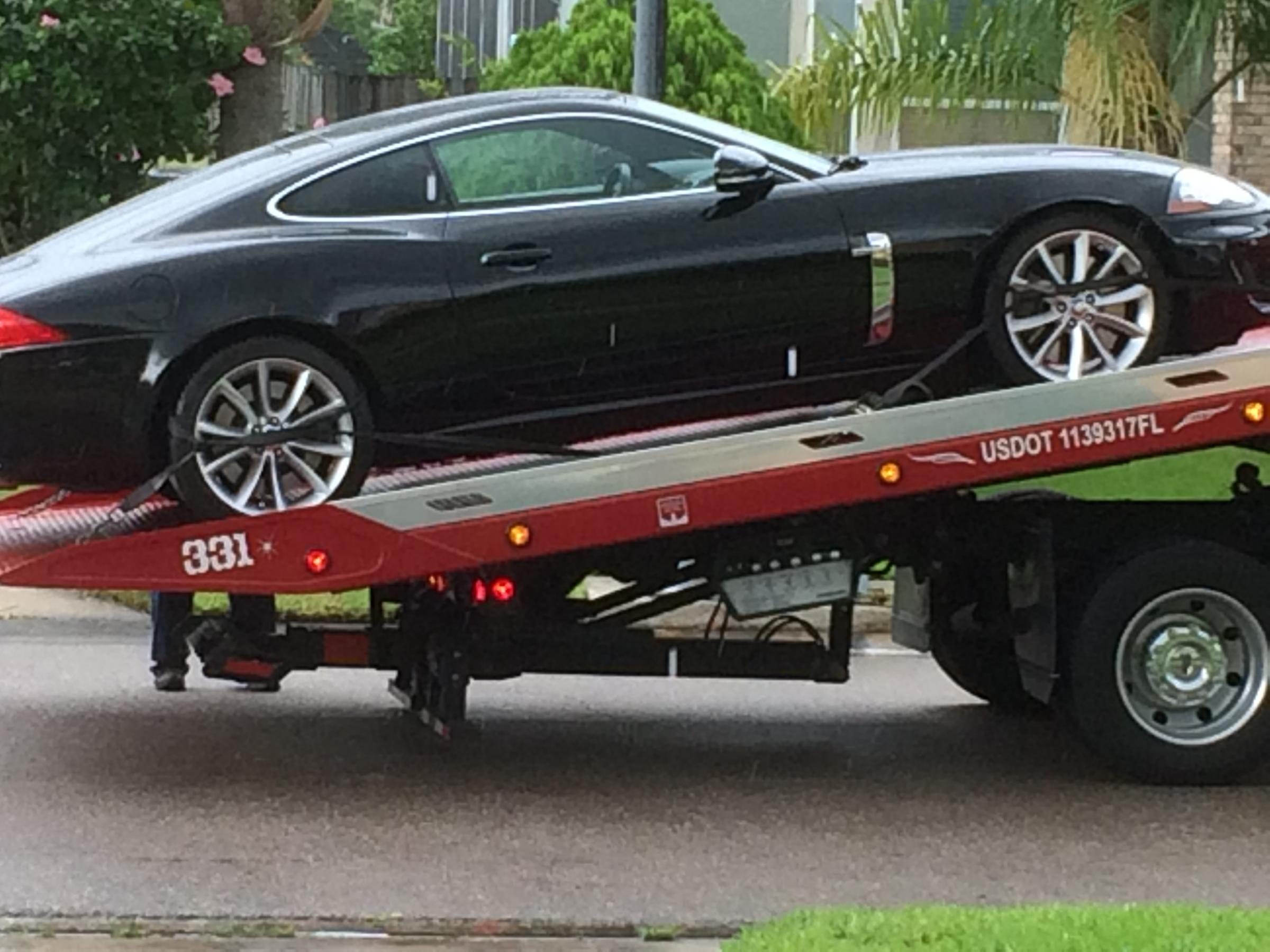

Jump into the ride yesterday and didn't get far! battery completey dead, not even interior lights came on........ssoo had towed to the dealership under warranty. I'll keep everyone posted as to "what" the dealer has to say!!https://www.jaguarforums.com/forum/i...icon_idea1.gif
