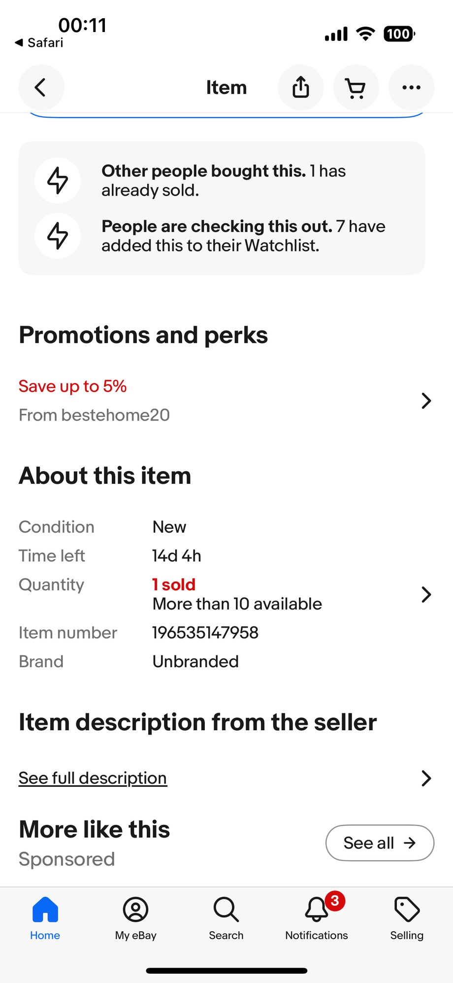

Here ya go!
Bluetooth 5.0
Bluetooth 5.0

I tried to google BT tpms but couldn’t find anything. Do you have a link for the website or anything?
EBay https://www.ebay.com/itm/19653514795...Bk9SR4C3nvfRZg

Originally Posted by arenaej
EBay
You must be the only purchaser, as it says 1 sold!
Like the integrated design, rather than those valve stem caps that are easily stolen. But the battery life of 3-5 years is kind of a pain.
You asked for a link to the item…this wasn’t my seller, I’ve had mine installed for awhile. I’m 75 years old…3-5 years is probably plenty for me!
