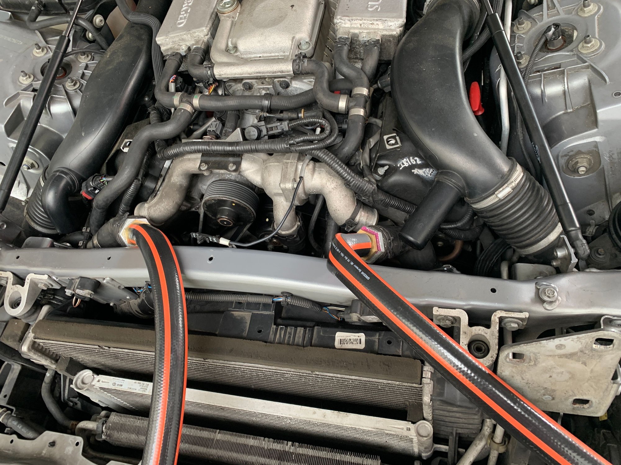

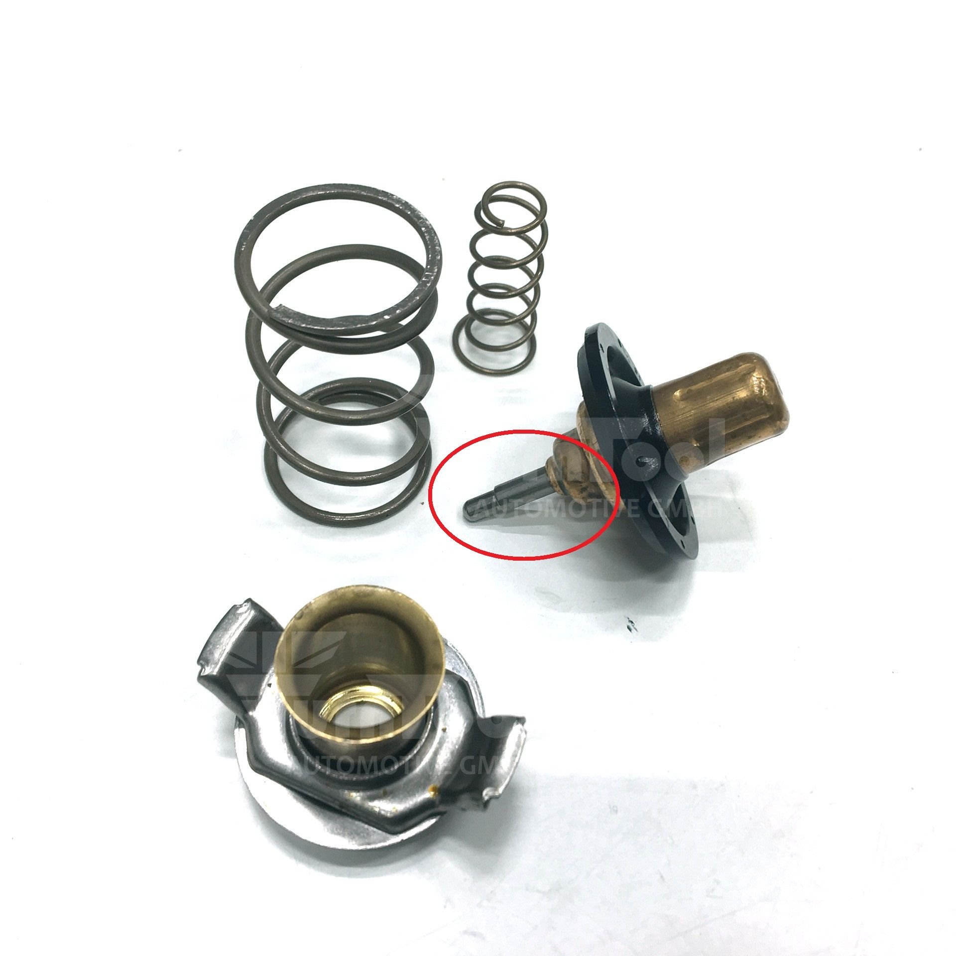

I am back with more information and I guess I have found the problem.
But lets start at the beginning.

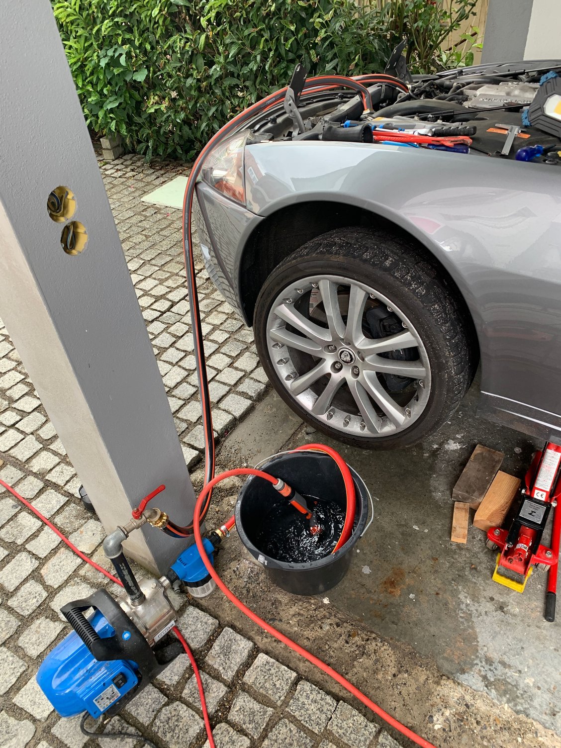

I have checked the last part which was not replaced - the radiator. I thought it would be polluted maybe. So I bought a cleaner and flushed the radiator with a normal water pump. This water pump was used to pump water from the river into the garden and water the flowers.
The water from the radiator outlet was clean so the radiator was not the problem.

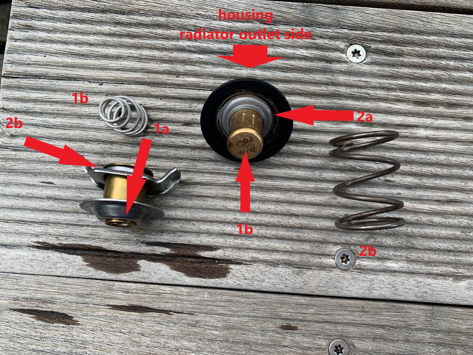

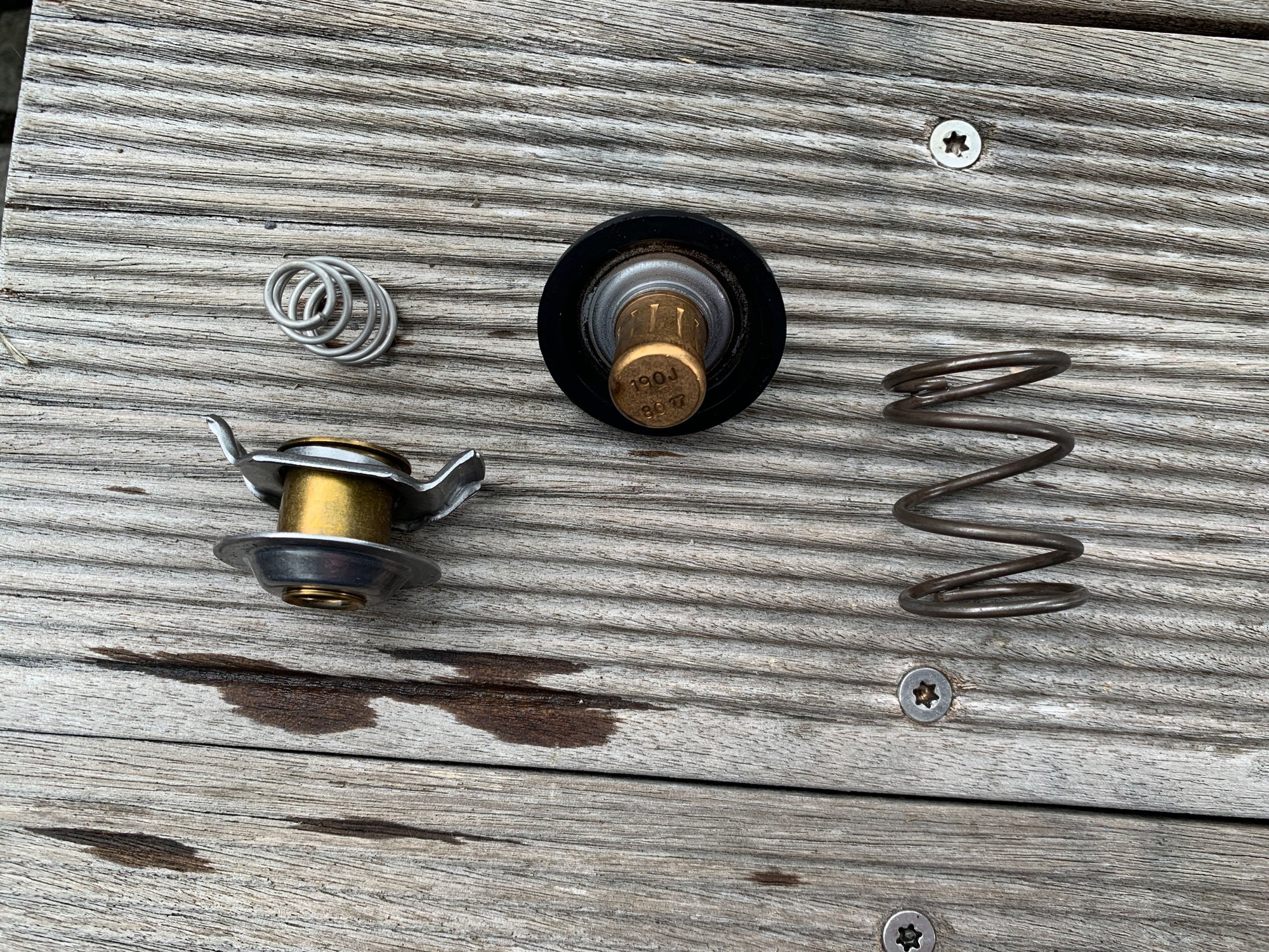

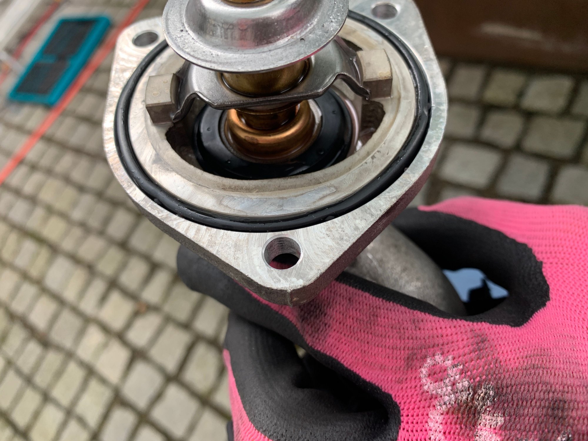

Because of that I removed the thermostat to see if the water pump pumps enough water through the system. I have removed the thermostat from the housing and I have recognized that the bolt (check the photo of an original jaguar thermostat) was missing. So our JLR dealer has sold us an original thermostat where the main part to function properly was missing
Additionally my husband has forgotten the big spring while assembling the thermostat. Because of that the water pump could "open" the thermostat with higher engine speed because the pressure inside of the cooling system was high enough to press against the small spring. He has assembled a kind of back-pressure valve
My next step will be ordering a new thermostat with all parts then assemble it. I have made a picture just to check with you guys because the jaguar workshop manual does not provide that much details about assembling the thermostat

If it's me, I'd rake the dealership over the coals, not mention the miss by your husband and
1) see if they will install it given the amount of time and money you've spent,
2) barring that, see if you can finagle a few oil changes out of them.

Glad its sorted... but don't feel bad. The multi part thermostat confuses many, the first time.

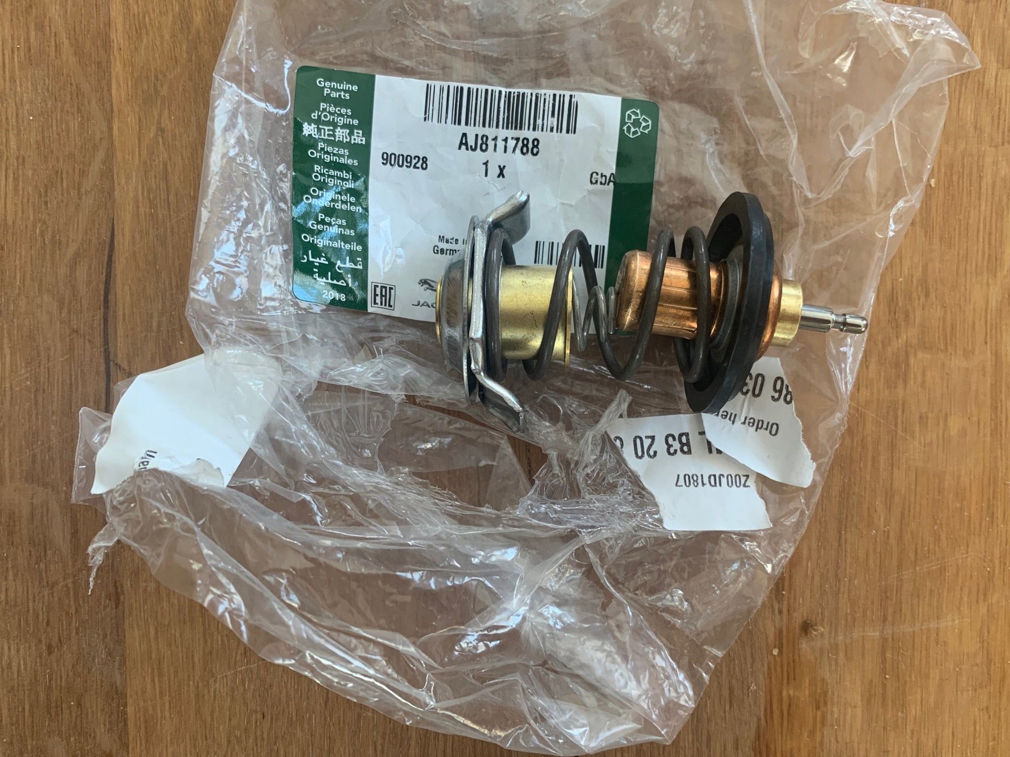

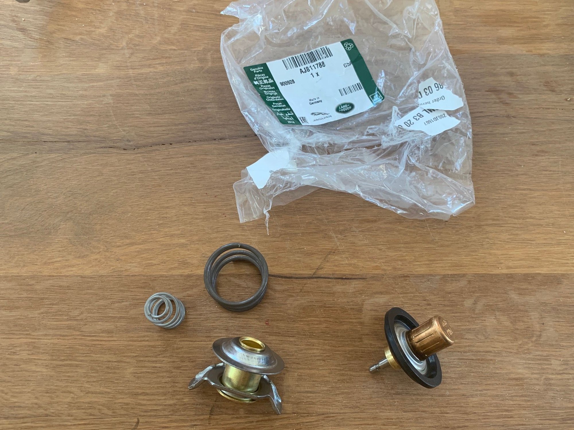

The new thermostat arrived today :-)
The bolt is not missing. It is not possible to remove the bolt so I am wondering why the one from the old thermostat was missing.
Maybe someone bought it and wanted to test it with hot water outside of the housing. So the bolt would be pressed out of the thermostat, he recognized that and returned it to the JLR dealer.
The dealer sold us then the broken thermostat.
I do not have another explanation for this.
Anyway I will install it and then testdrive the car. The weather is really hot outside, perfect conditions to test this :-)

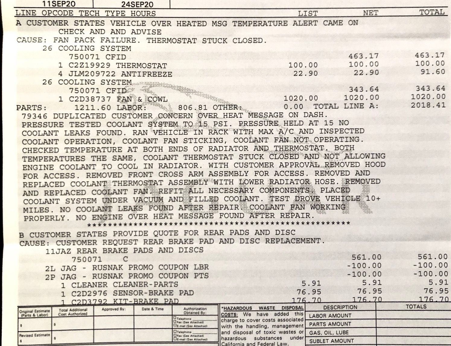

In case you want the dealer pricing on this. FYI, as someone pointed out elsewhere - the module that turns on the cooling fan is embedded in the motor, which is part of the fan and shroud assembly. $1,080 for that alone.
Thank GOD my warranty covered it....
