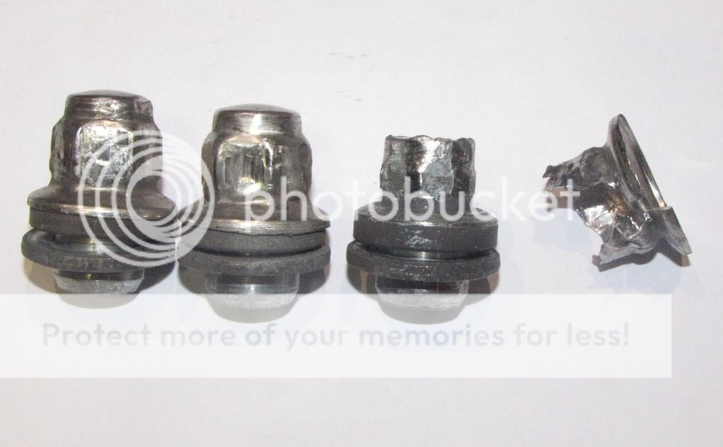

XKRAU Feb 16, 2022 07:08 PM
A couple of my OEM lug nuts were damaged when I purchase my XKR but not as bad as these in the picture. I had to hammer a socket to remove a couple of the the lug nuts as they were mangled up and rounded. A 5 min job turn out to be an 1 hour job just to remove the wheels to repaint the calipers.

Stuart S Feb 16, 2022 10:05 PM
There's nothing wrong with the OEM Jaguar lug nuts that a tire jockey armed with a power tool and wrong size socket can't fix.
The OEM Jaguar lug nuts will last forever without any problems IF you always use the correct size (19mm) deep socket and hand tools only, and use a torque wrench to tighten them to 92 lb-ft. I keep a 19mm deep socket wrench in my trunk together with the factory tool kit that includes a breaker bar, jack, 12 volt tire pump, and torque wrench. My XKR's lug nuts are still like new because I insist that tire jockeys use my 19mm socket and hand tools only.
https://cimg0.ibsrv.net/gimg/www.jag...52d4bf03fe.jpg
See this Sticky and scroll down to 15. Wheels - Retrofit a Spare Wheel: https://www.jaguarforums.com/forum/x...enance-227403/
Problems happen when tire jockeys who don't have metric sockets repeatedly use the closest size SAE socket that fits (usually 3/4") together with a power tool with excessive torque to remove and reinstall those lug nuts. That will eventually cause the outer shell of the OEM lug nut to deform and spin on the inner nut, thereby making it difficult, but not impossible, to remove. Simply hammer a 19mm or smaller socket onto the deformed lug nut to remove it.
Don't blame the OEM lug nuts. Blame the lug who used the wrong tools.
