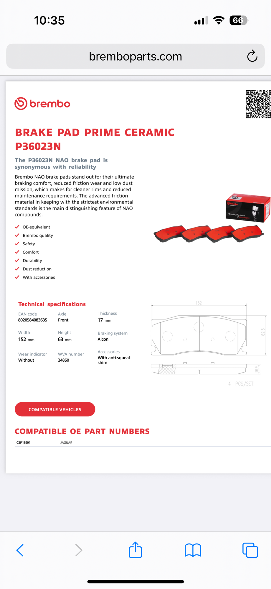

My brembo Pads just arrived the other day.
I hope they’re the right ones. Alcons make life harder lol.
According to the tech data sheet for the Brembo part number they list the JAG part number for Alcons.
C2P15994 JAGUAR
C2P15994 JAGUAR
1610696480 PEUGEOT
its from autopartsway in Alberta so I think its correct. The box says 06 jaguar xk- lol but that means nothing im sure

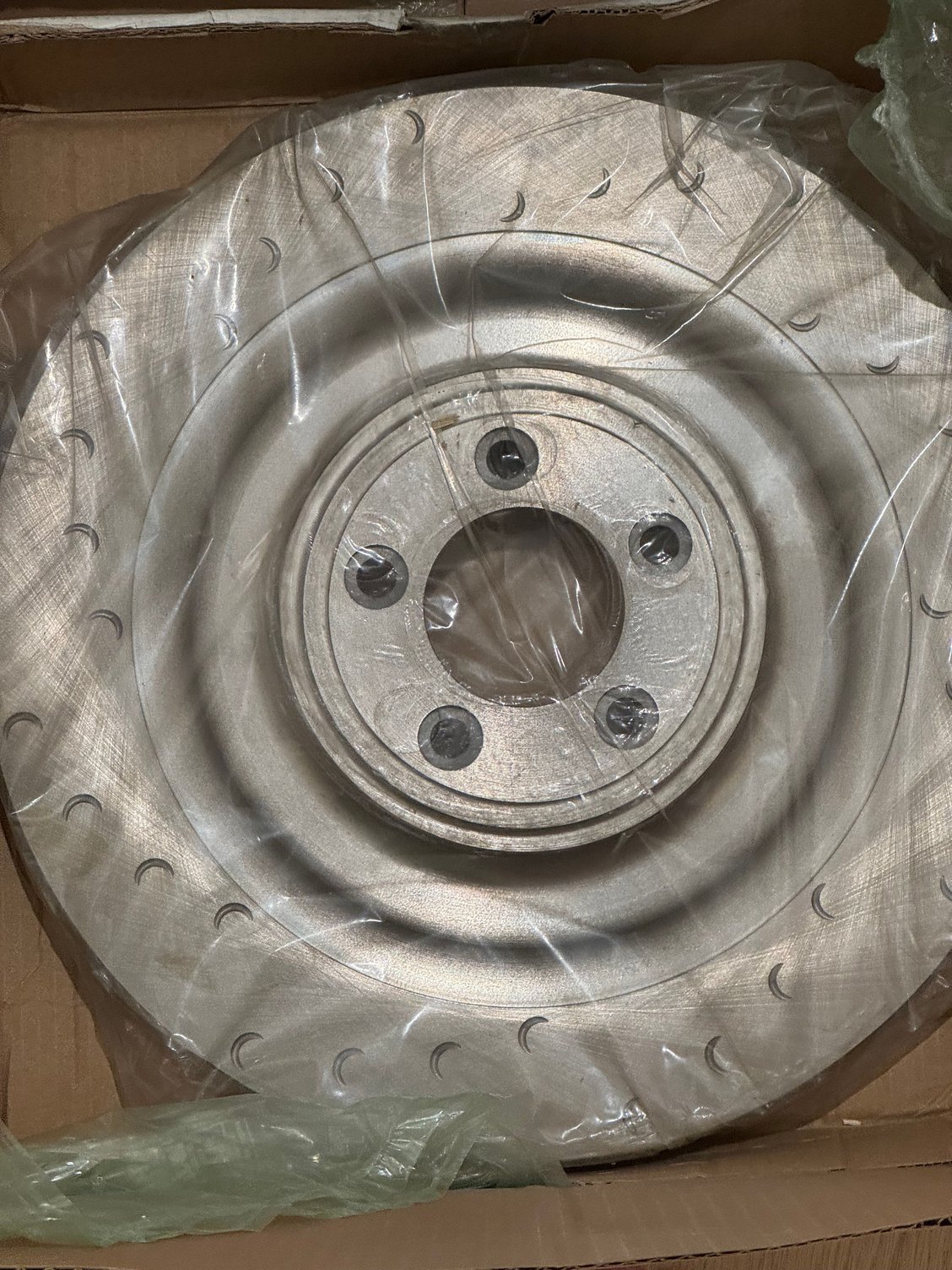

Ok rotors arrived , I ended up and maybe I made a mistake to go with the crescent slots so they match the rears. Difference part number, not the premium but the way I drive it’s no issue. All looks good. Install is next Wednesday so can report back .. thank you Mj for all the info and everyone one else. Landed from Car ID ( I got hit with 54 bucks duties ) was around 500. 460 cad and duty. Pic below

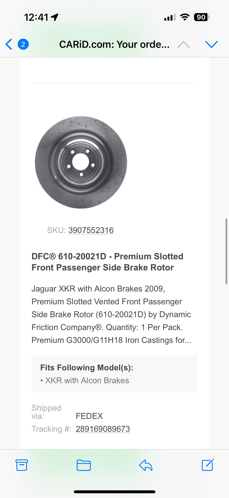

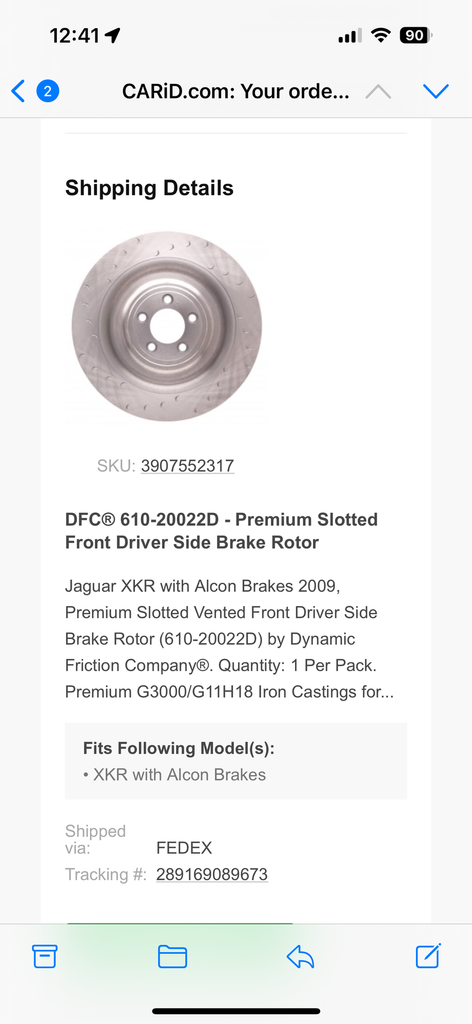

Here are the part numbers DFC and CariD
Why do you think you may have made a mistake? Good choice, IMHO.
