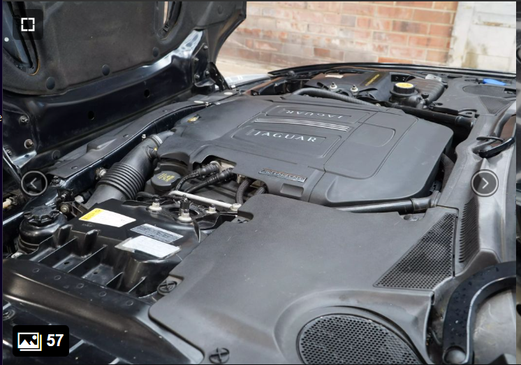

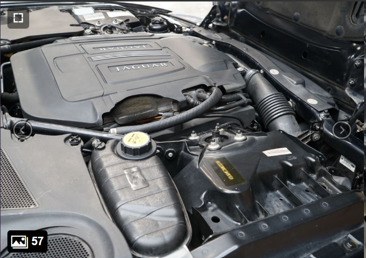

I've posted some pics from the dealer of the engine (cover on) and a couple others for those eyeball experts out there.
When I zoom in, the visible hoses look almost new.

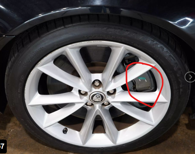

What brakes are these?
Anything look awry?

How about here?
How about here?
