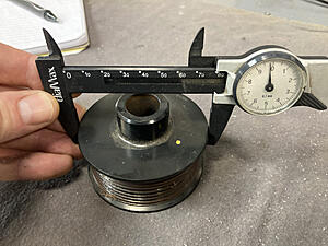

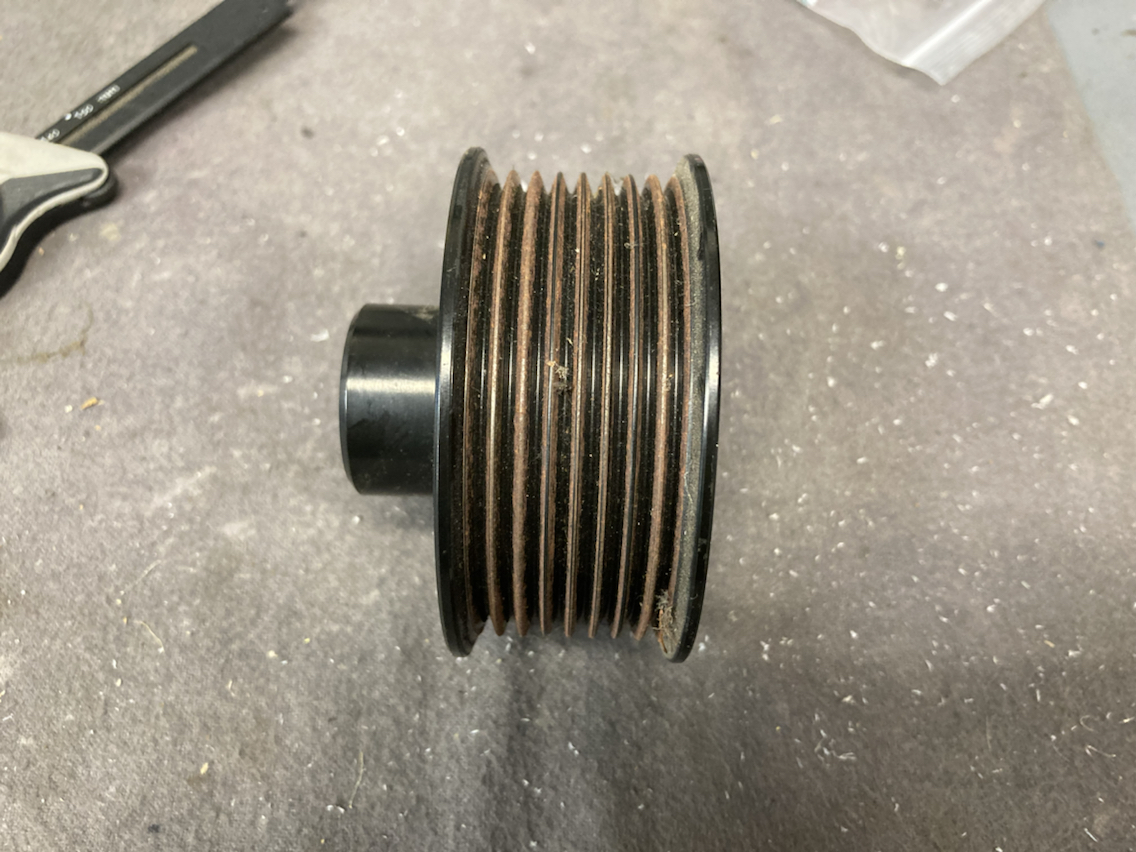

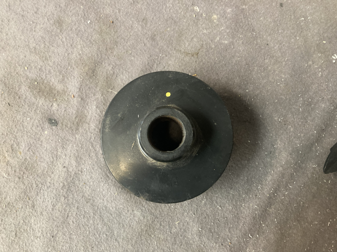

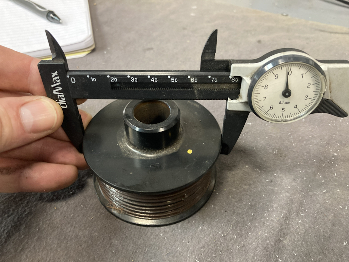

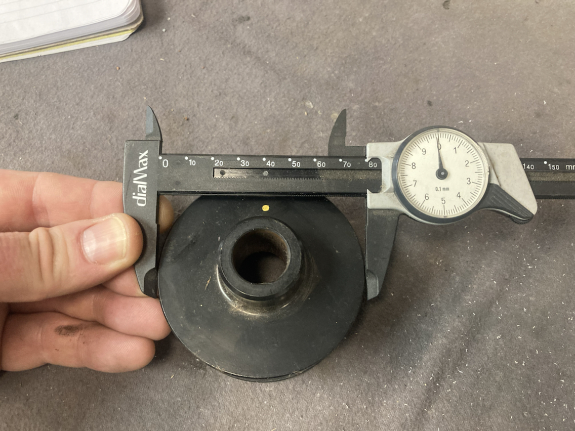

Just a smidge under 80mm at the widest part of the front flange. The diameter at the grooves is less but you couldn't measure that with the belt on anyhow.

I've never heard of an aftermarket pulley that was magnetic... 😉

Well that saved me taking it off! All good it's uprated!
