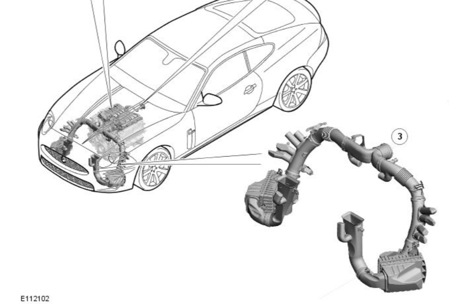

Originally Posted by Queen and Country
...never seen any manufacturer put dual intakes on the outside of the car and on the lowest point is the car.
Errr, what? The filters are down by the wheel arches, but the intakes are much higher up:
Old Apr 2, 2015 | 11:47 AM
  #44
jagtoes's Avatar
Joined: Sep 2013
Posts: 5,209
Likes: 1,847
From: NY
Interesting diagram but what are the "warts" sticking out of the tubing.
Almost all of them are "quarter wave resonators", which are designed to reduce induction roar. The rest are mounting brackets.

By the way, the actual cold air intake is at the top of the grill so it is fairly high off the ground. Just the boxes that hold the filters are in the bottom of the bumper.
Attachment 109188
Ngarara, must you destroy all my fantasies. If you believed the hood scoops were part of the performance, and allowed rain to cool the engine, I would let you dream, if you believed the 75th anv was indeed different, I would cheer you on.
Thanks for the sobering cold shower diagram. Where did you get it?

Sorry to disappoint
It's from the workshop manual PDF, available from JagDocs:
Jaguar XK8 XKR X150 Documentation
