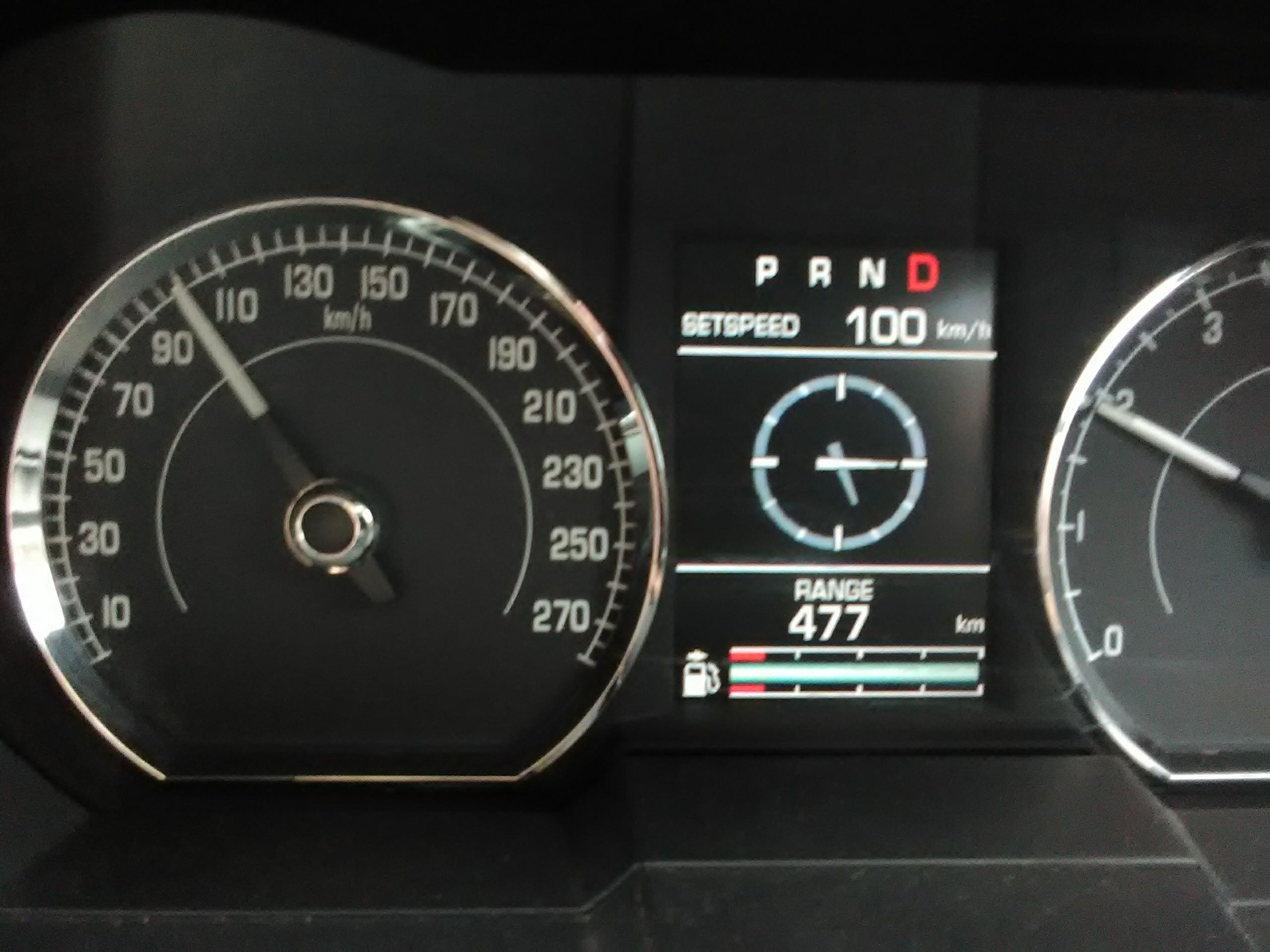

Yes currently running a 3.58 Lincoln differential in my Xk no codes no TCM adjustments.
Due to the shorter ratio it gets into 6 gear alot sooner on the city roads so fuel consumption actually started to decrease on the open road it's also very good 9-9.5L/100km
Now to the juicy part the xk is always in the power band now it feels a hell of a lot more responsive & torquey .
The big downside it's virtually impossible to launch it off the line now desperately need that quaife !!
