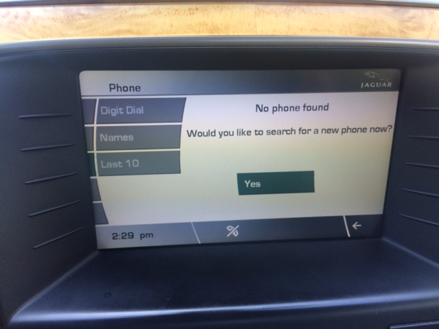

Mine has 135,000 miles and is my everyday car. My Iphone 5 has worked flawlessly over Bluetooth for the past two years. About 2 days ago, it lost connection over Bluetooth. When I select phone on the main screen, I get the screen below. Everything is grayed out except the YES button. Pushing it does nothing. Timeout is set to off. All I can do from that screen is either push YES or return to the main screen. Iphone is in discover mode and has no problem connecting to other Bluetooth devices. Any suggestions?

Maybe you need to reset the electronics in your car. That involves disconnecting the battery for several minutes. The downside to doing this is that you will have to reset everything such as seat memory, radio stations, mirrors, steering wheel, etc.
Another thought search frozen bluetooth phone app on the forum and see if you come up with anything. Good luck

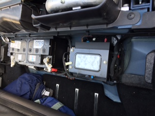

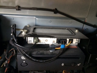

I discovered some time ago for the convertible that if you open the top halfway you can from the top remove the four screws and the cover for the battery compartment and work on these components from there. However, a warning that I address below. I did that and a photo is attached. I found the bluetooth module and I attach 2 photos. One shows the big gray plug. I have my doubts that this is a power plug because when I removed it, the connector looked a lot like an RF connector. Anyway, that didn’t solve the problem.
So I decided I would disconnect the battery and do a full reset. However, when I did that and lost the power that was holding the top and tonneau up, they dropped down. In the end, that required the manual top reset procedure which is not complicated but you’ve got to follow the owners manual instructions carefully. I learned about that procedure when I first got the car in 2007. All is back where it was supposed to be and bluetooth is again operating as before.
The battery disconnect also solved another problem with the navigation system. About a week ago I noted that whenever I used the navigation system it would come up with DC as the search area, 1/16 mile on the map and North on the map. It would not hold my normal parameters. The reset solved the problem and now it holds the last entered parameters.

sorry Meng the power is that large black connector with the blue tape on yours. The center one. My mistake.
Sounds like it worked out for you. It also sounds like your issue may be one of low battery causing ghost issues, have you run it down before? Do you use a battery maintainer?

Originally Posted by Meng
Success!
Note: I've since discovered that these photos are not the Bluetooth module. I wondered why such a module would have an RF connector. I'm pretty sure these photos are of the satellite radio module.
