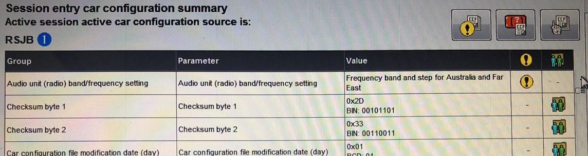

A dealer or someone with SDD should be able to change it for you. A lot of our XK imports are from Japan (including mine) and the radio frequencies are just reconfigured as part of the process of preparing them.
I think this is the setting in the CCF:

Yes the radio frequency region is defined in the CCF, swapping the radio won't make any difference, they are the same hardware regardless of country/region.
I don't think a dealer could change it, it would be one of the locked out settings.
Not sure where you are in Germany, but these guys could change it www.jaguar-codierung.de
