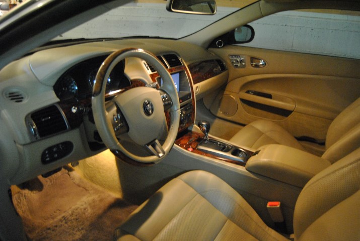

I have not done this on the XK (but I have done exactly this on 2 X-Types) - it should be completely straightforward - the cruise and audio packs simply get transferred to the new wheel - There shouldn't be any alterations as far as I know (the 07 and 08 cars are essentially identical).
The leather can be redyed with no problem at all (before the wheel goes on). I can tell you where to get the dye if you decide to do this. Did the dealer tell you why they do not want to do this? After all, removing the wheel is a "normal" procedure and it is in the service manual.
My car has the (heated) wood/leather wheel - very nice indeed.
