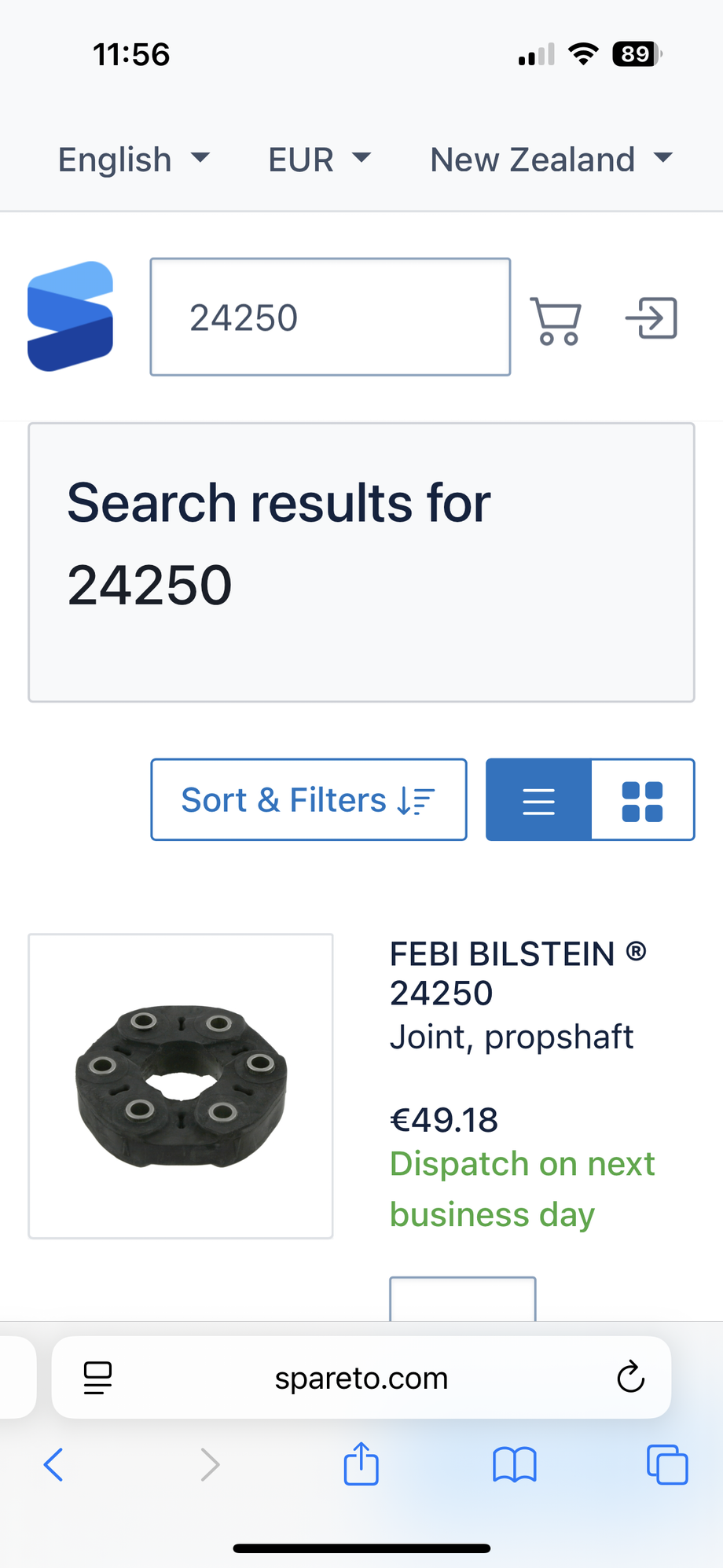

Old Sep 3, 2025 | 06:58 PM
  #31
Alboy's Avatar
Joined: Oct 2022
Posts: 48
Likes: 17
From: Auckland
Just to add to this old thread. Searching Spareto.com indicates this jurid is used in a whole bunch of vehicles - even a Ford Transit van. The Febi Bilstein part number is 24250 and available out of Europe for around €50 each plus shipping
