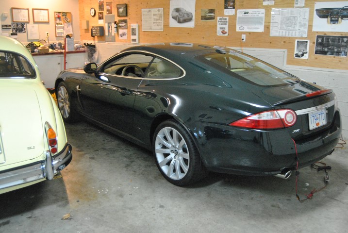

When I had Jaguar V12 cars (Series III XJ V12 Vanden Plas) it was very easy to tell when the engine/transmission/exhaust system were properly warmed up (that is, to a temperature that burns off the corrosive materials produced by combustion). Those cars had real oil pressure gauges! I could tell by a drop in the oil pressure at idle that the engine was ready for hard work, and it took about 15 kms at highway speed for this change to be noted (all of the readings well within factory specifications), despite the fact that the engine temperature gauge read the normal 90 degrees within one km or so of city use. So those who think that running the engine at idle and near idle for 10 minutes is good for the engine are mistaken, I think. Engine use like this produces quantities of corrosive material that has no chance of burning off. Our XKs don't even have a temperature gauge, let alone an oil pressure gauge so we have no way of knowing when the engine is even at normal operating temperature: treat the car gently for the first 10 minutes!

There is no reason at all to remove the battery! Just get a proper battery maintainer (CTEK is my preferred brand) and keep it permanently installed; just plug it in when the car is not in use, even for months at a time. Removing the battery requires subsequent resetting of various memory systems; keeping the car on a battery maintainer avoids all of this fuss; it takes about 45 seconds to plug in or unplug the unit.
Look at the photo.
