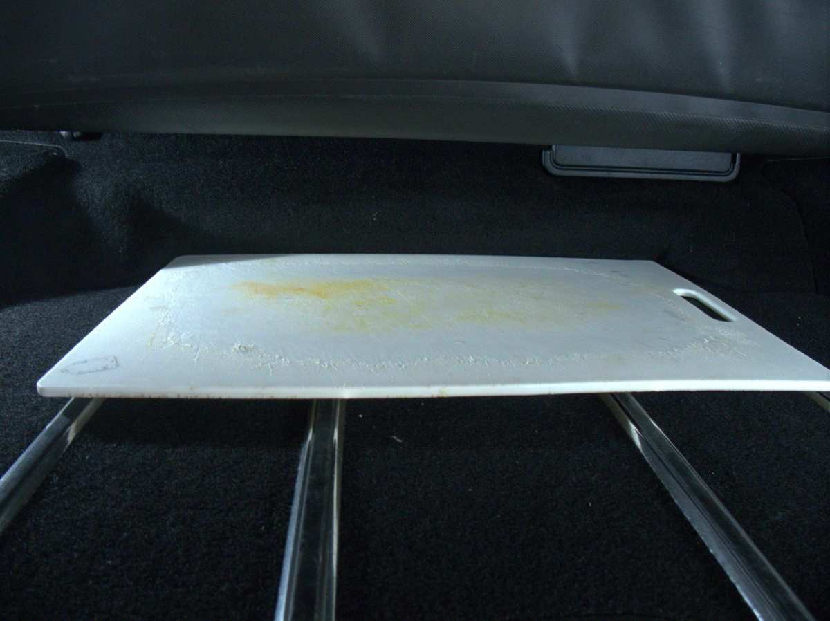

What I do!
Remove the separator
Remove the positive and negative cables
Remove the right hold down battery bracket
Loosen the front hold down bracket
Place a garbage bag on the trunk floor
Place my kitchen cutting board on the GB and position it adjacent to the battery
Lift the battery @ ½ inch vertical and pull it toward the cutting board
Walk it onto the CB
remove the vent tube
Slide everything back to the truck opening
Remove the battery without breaking my back
Jump the + and - battery cables for @ 10~ minutes
Charge new battery
Remove the battery cable jumper
Reverse order with new battery
Reset windows
I’m not a slow typist and it probably took as long to compose and type this as it would to remove the battery.
WJ
Ps….a slightly discharged battery may seem to recover a little overnight due to a brief "ionic rest period" that allows chemical reactions to even out, but this does not provide a real charge.
Pps…My XK Service Manual states that the battery must be at 12.5 (not .6) minimum to expect accurate testing results

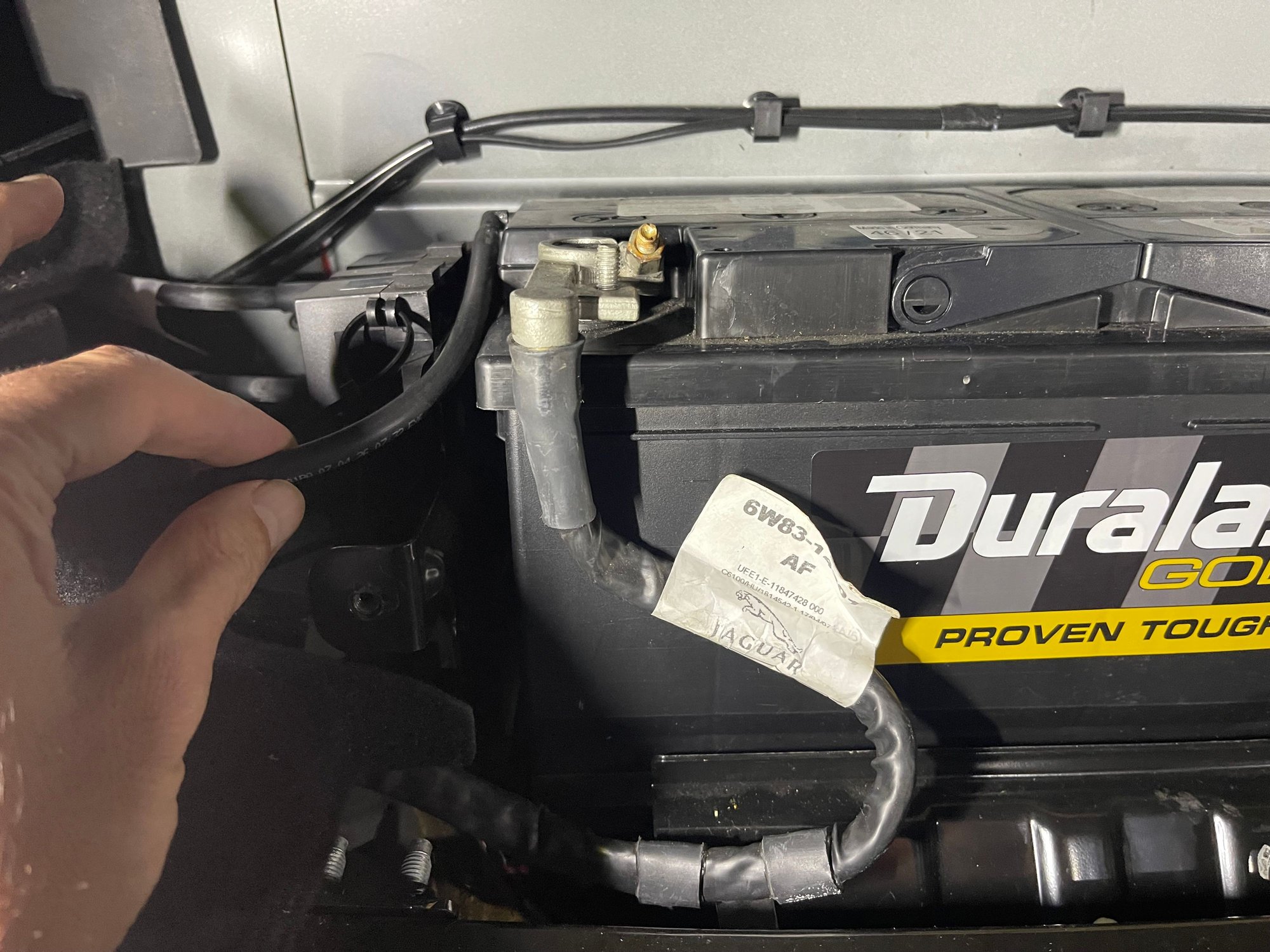

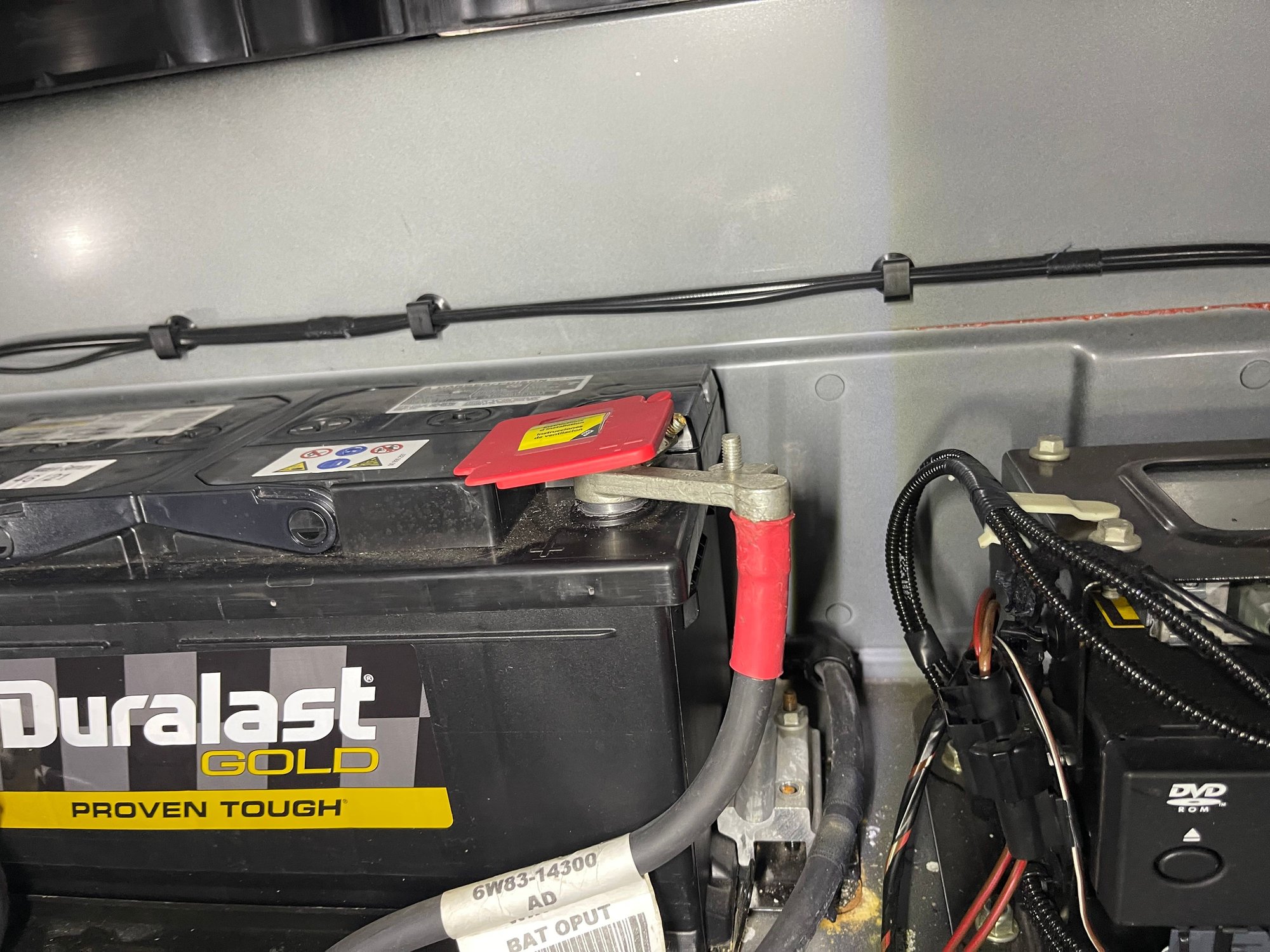

Went out to start playing around.
As shown above, I tested voltage at the Ctek connector and still at 12.57v as it was at 10:30am.
But alas the wife is in her office doing her nails then working out, so we wait. Need her to open the top so I can look down under the tonneau cover.
Turned the car around to back in for more room in the trunk (2 single garage doors really suck) and it was stuck in the Jaguar logo for the third time now.
Turned off the engine and locked the car.
5 minutes later (just now) and the screen is still on with the logo. FML.

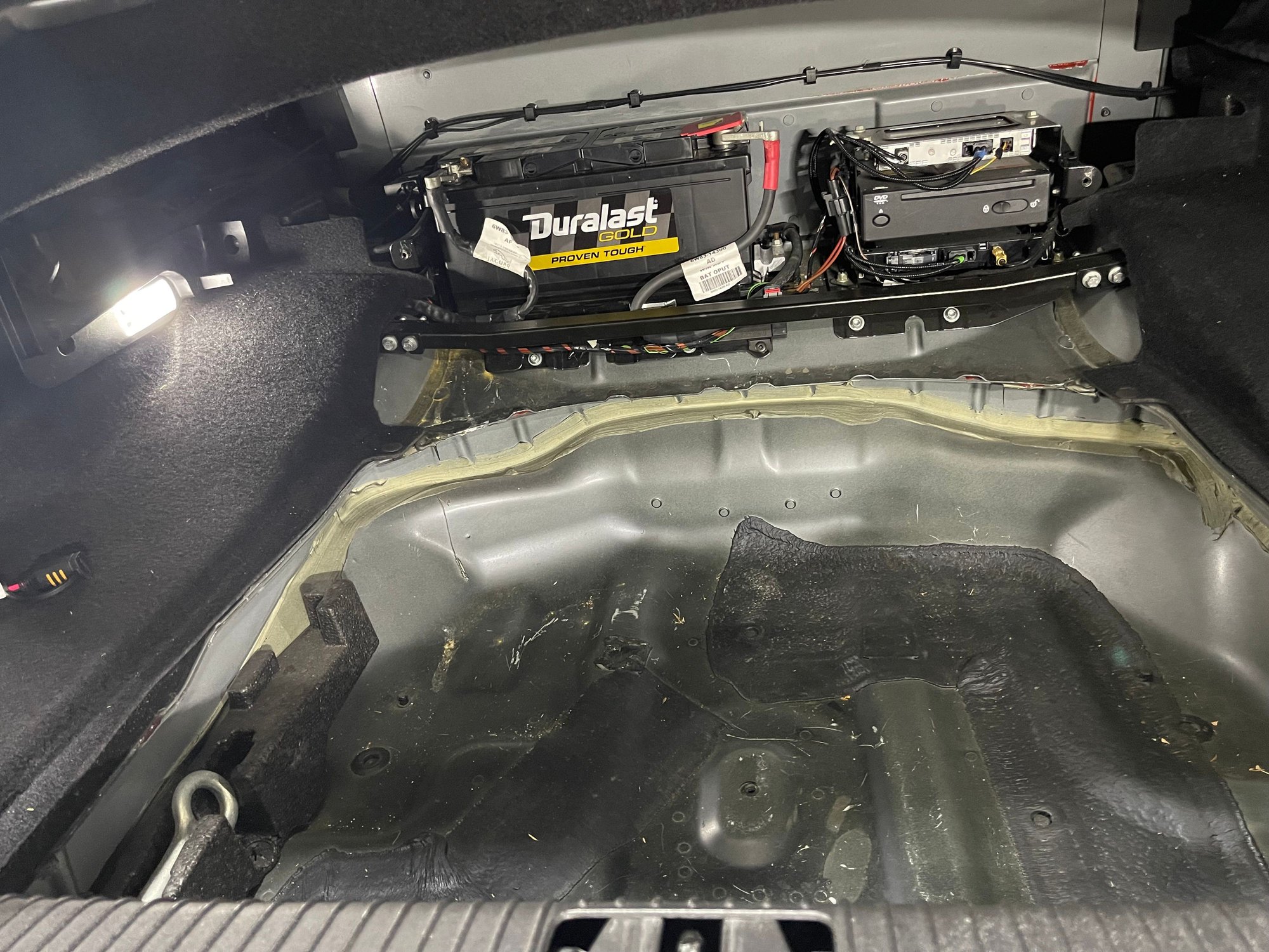

Wow if one could lift a 70lb battery that high, it can just be dropped in through the tonneau.
But still went in through the trunk to look.

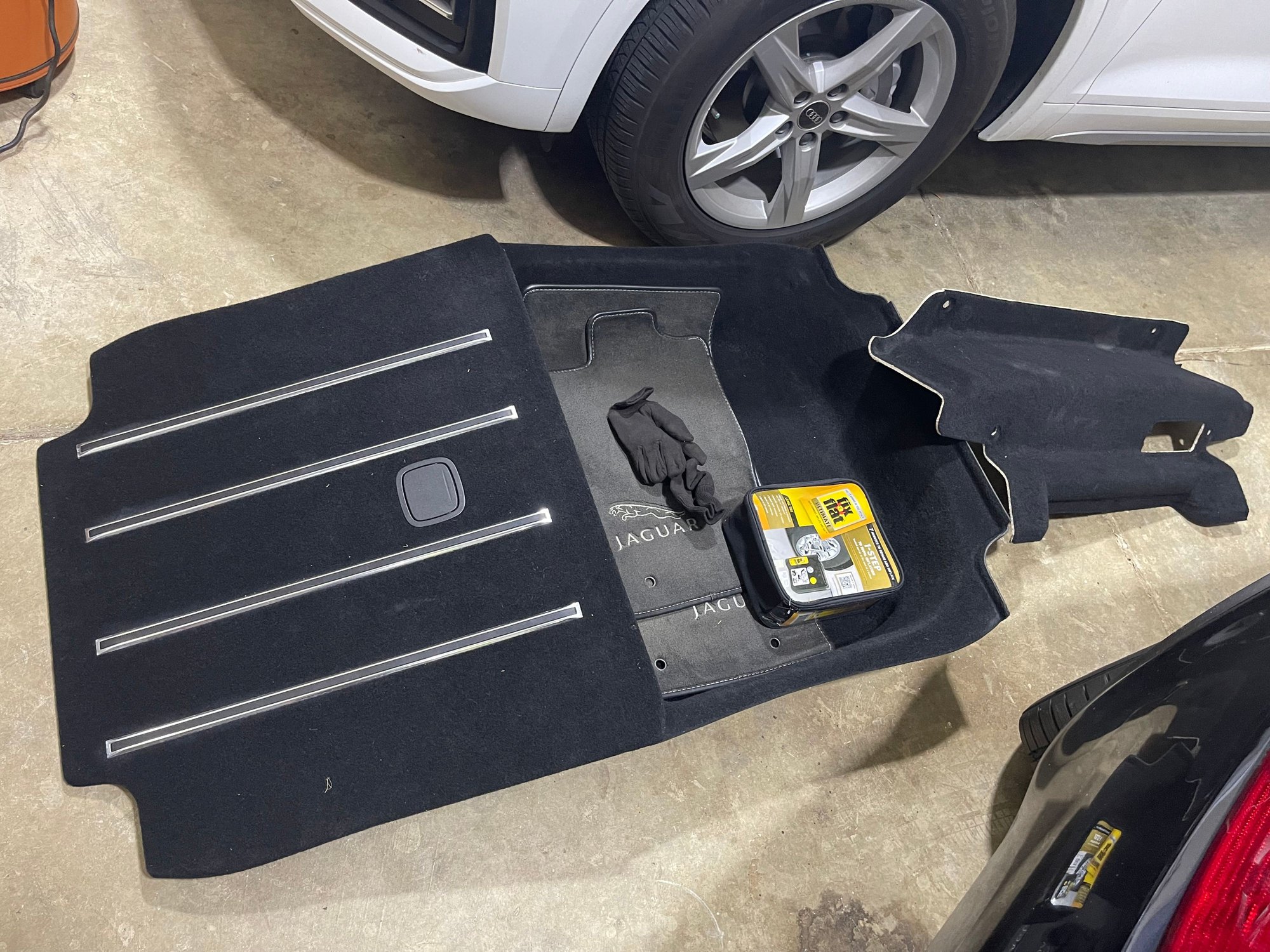

Who knew the spare well lining just lifts out.
Took everything out. Vacuumed all three after the pic.
Then cleaned out the entire thing.
** Anything else I should do while I’m in there?
I found a vent tube on the ground side.
Assume that’s it.
There is nothing on the Pos side.
For posterity, here is the whole thing, with all carpet removed.
Gonna leave all the inserts out and get the battery replaced with the Walmart AGM H8 tmr before I have to drive my daughter back to college Sunday.

1. Remove the luggage cover
2. Remove the floor panel
3. Remove the cover over the battery and electronics stack
4. Remove the angled bracket battery hold down (bottom front of the battery)
5. Put the floor panel back in
6. Lay a short 2x4 parallel to the battery
7. Start sliding the battery onto 4” wide board
8. Lay a 4 foot 2x6 or 2x8 board from the edge of the 2x4 and up and out the trunk
9. Slide the battery up the 2x6 top of the trunk
10. Remove battery (didn’t have to lift it out)
Reverse the steps to install the new battery.
There was no need to remove the spare tire.
What's a spare tire? Me no have one of those.
If I can't pay someone a bit younger than I, this plan sounds good.
I will just leave all the inserts out of the trunk when I go to Wally World.
(See last photo above)
