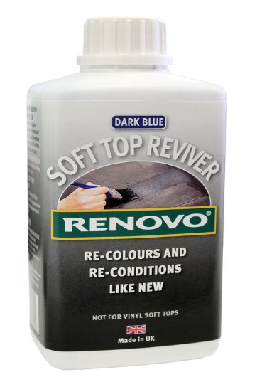

@Jaunty is correct. Renovo is the Cat's meow.
The blue makes a blue top look new.
Available in 500ml and 1000ml. I recommend that 1000ml. If you have too much save for next time. I did need more than 500ml.
Use a plastic drop cloth and tape to protect paint and chrome. Renovo may run on occasion and is very difficult to remove.
Good luck. Let us know your results.
PS: Made and generally distributed from UK. It was unavailable for a while in protest to tariffs.
Looks like this is the route to go,,
Thanks to all!!!

Quite accurate video, similar to my experience.
Fabric had mild surface breakage on rear quarters due to folding that would not hide.
Multiple coats were required for my project.
Massive drop cloth and taping highly recommended.
Not water based.
Good luck.

Heard thru one source the BLUE was almost BLACK...
any help?

WOW..
4- to 5 coats did not solve the tops problem on the video...look was poor,,,,
NOT very optimistic...

Just watched it, and have to agree with you. A lot of effort put in, yet the result wasn’t very convincing.

I've done a Blue and a Black.
The Blue is actually Blue.
Results depend on top condition and prep.
Short of replacement fabric, Renovo is about as good as it gets,
IMHO, looks a bit better with a little age after treatment.
I did try Star-Brite Water-proofer during the Tariff embargo.
Very thin by comparison.
The black one was of "lesser" condition.
Ultimately swapped black top & pump assembly from a nice donor.
That is the easiest way to install a "new" used top.
While out of the car, removing and cleaning the oil reservoir is quite easy.
PS: Definitely a two-person operation.
