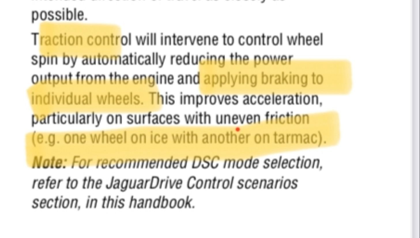

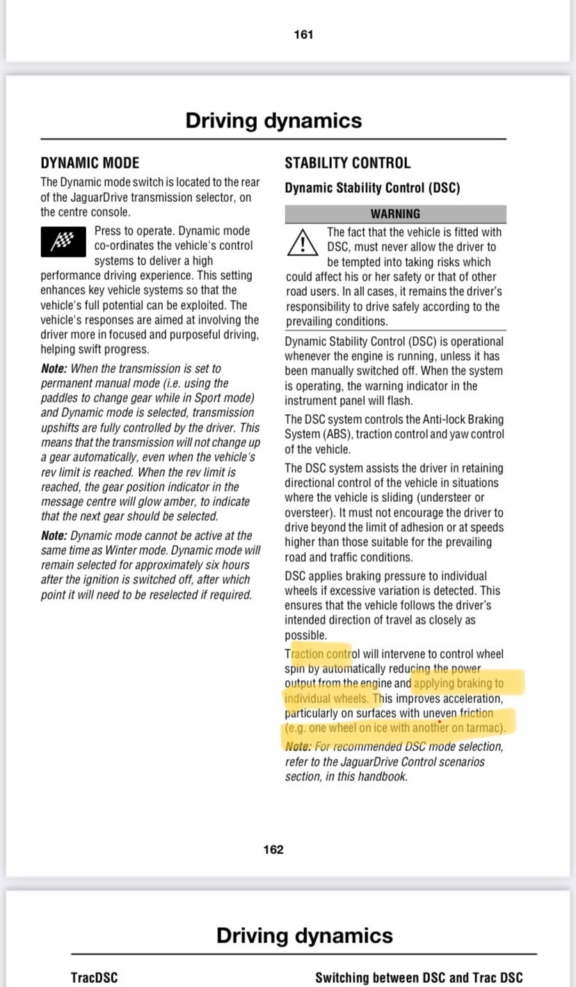

My question goes mostly in the direction as to whether the XK X150 range didn’t have any electronic systems available to avoid spinning wheels due to open diff applying the ABS-break on the affected wheel. Such system is explained e.g. here: cartecc.com - Limited Slip Differential (electronic)
I believe such systems are today in 2020 standard on most cars.
Edit:
And also the 2011 XK should have such system included in the Dynamic Stability Control (DSC).
No clue why this didn’t work the other day???
See user manual:
