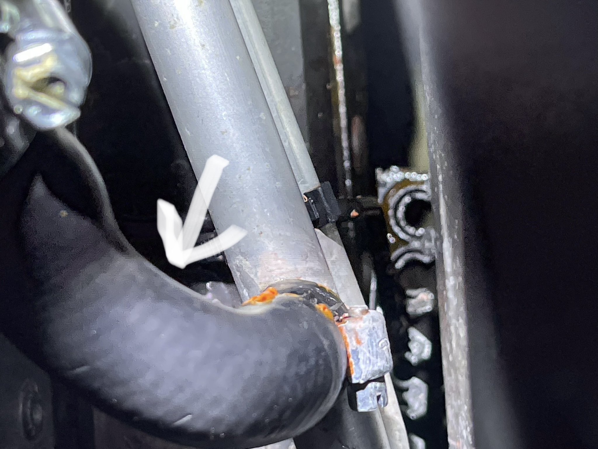

As the seller says they had been chasing down the small drip and the expansion tank was replaced recently, My first guess is the short hose pictured below.
There are crystals on top and bottom of the hose.
Someone in an older thread had tried it, so I am also going to try adding a second worm screw clamp to the top and maybe the bottom.
(Looks like the pinch ones were already replaced, probably when the expansion tank was)
Life on Cars vid. 11m mark and 14m mark for part# of entire replacement.
My planned steps today:

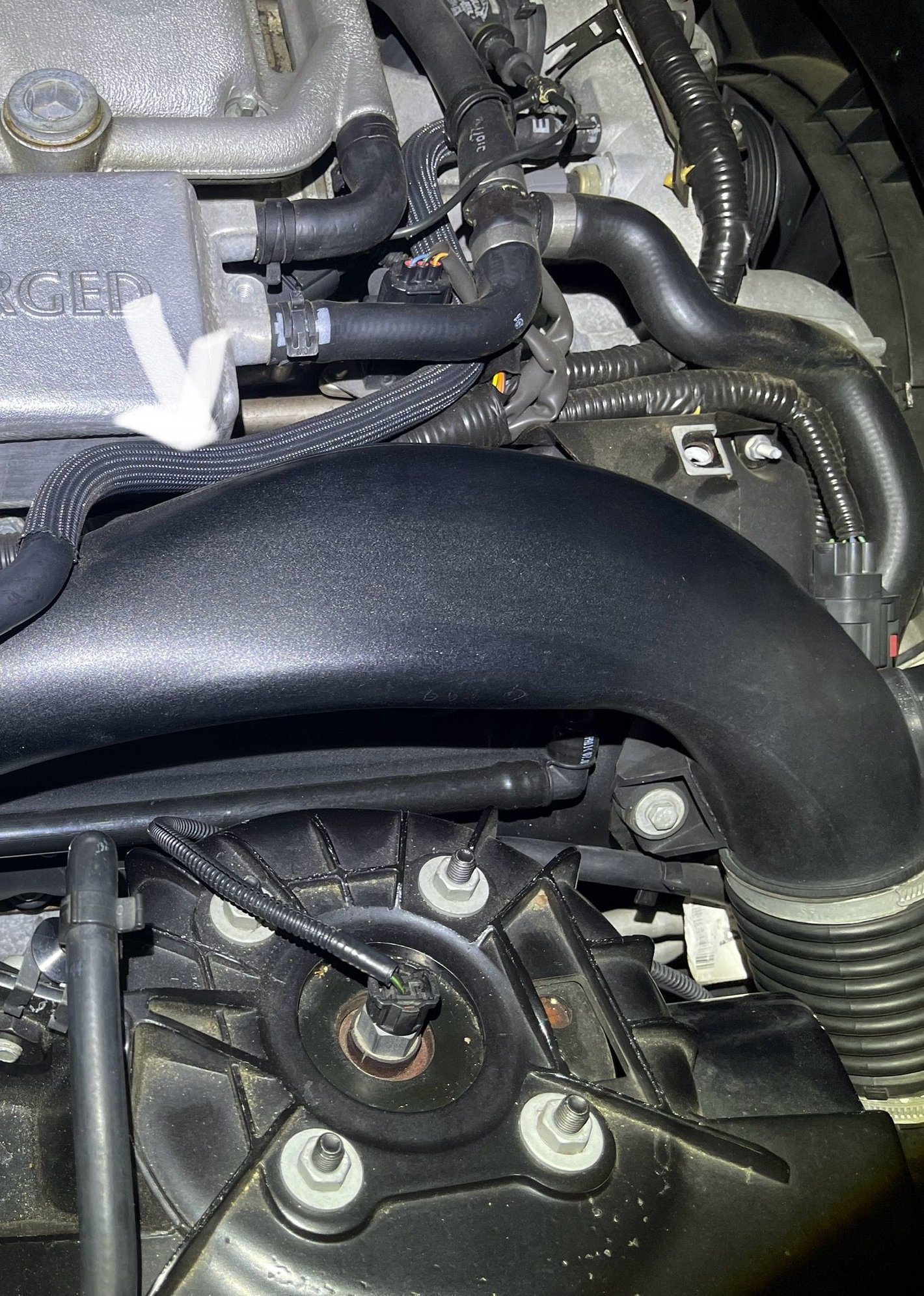

-- Remove under engine splash guard. Set aside and let dry out. (I'll post a pic)
-- Clean as much coolant off of the hose as well as surrounding areas.
-- Apply the worm clamp on top, closer to the tank nipple.
Then I will take her for a ride and monitor.
Rinse repeat for bottom connection tomorrow or next day if it resurfaces.
As always, since I don't know squat and tend to be overly presumptuous, I welcome any tips, tricks, advice, wisdom.... Or even request for pics or anything else.
(This is step one. Step two if not resolved will be indie shop pressure test and their investigation, etc etc)
Attached Thumbnails Time to poke around the Coolant Res tank-coolant-expansion-tank-leak.jpg

That is a major coolant leak. Is there any sign of coolant on top of or below the bellhousing? If so, my money is on the small hose which is under the intake manifold.

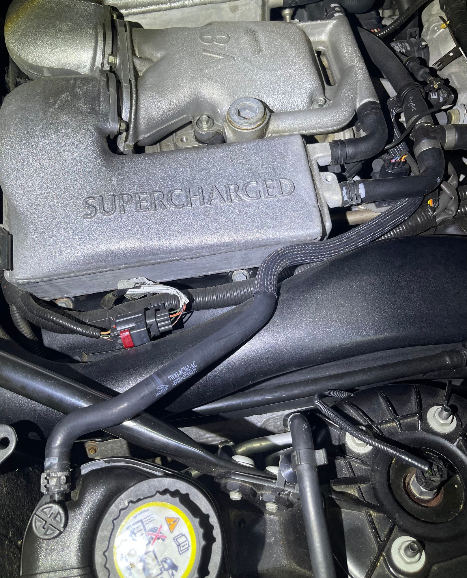

I won’t know if there are any other traces of pink until the jack stand covers arrive in the next hour and get the under engine off to look up and all around.
From the top, all looks good. Most of the hoses are nice and soft, not brittle, and looks like prev owner did the braided hose thing for the long one that returns to the expansion tank.
Let me know if there is a specific place I should look for now and I can take a pic.

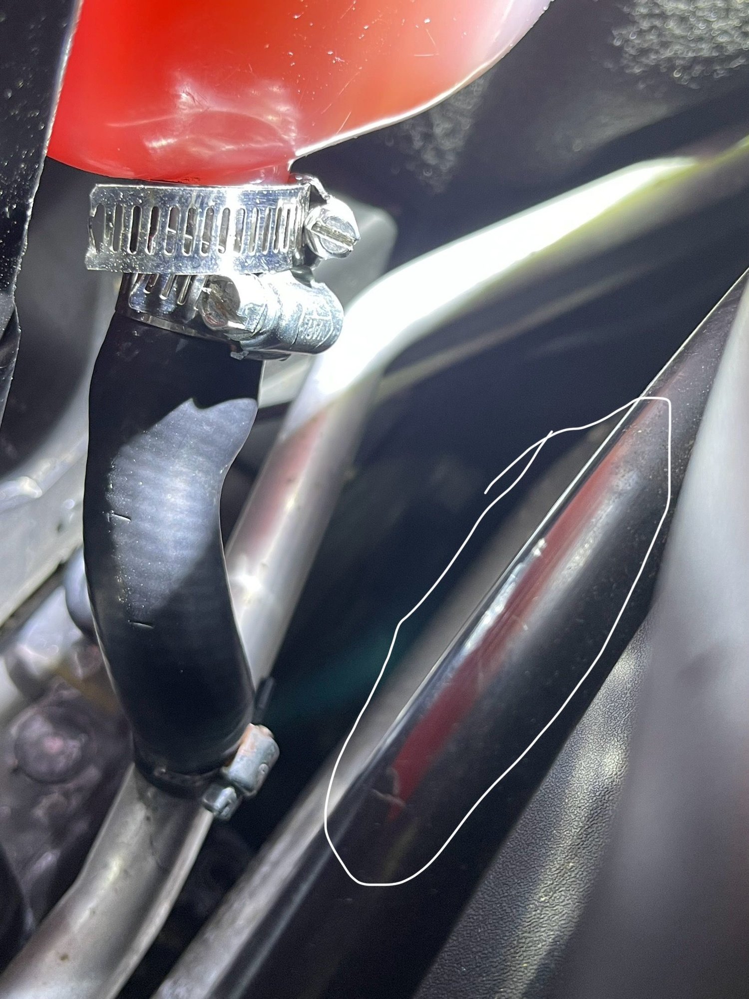

Update: I had cleaned the hose that is leaking. After making the 2 vids in a sep post, I felt underneath the top and there was coolant again.

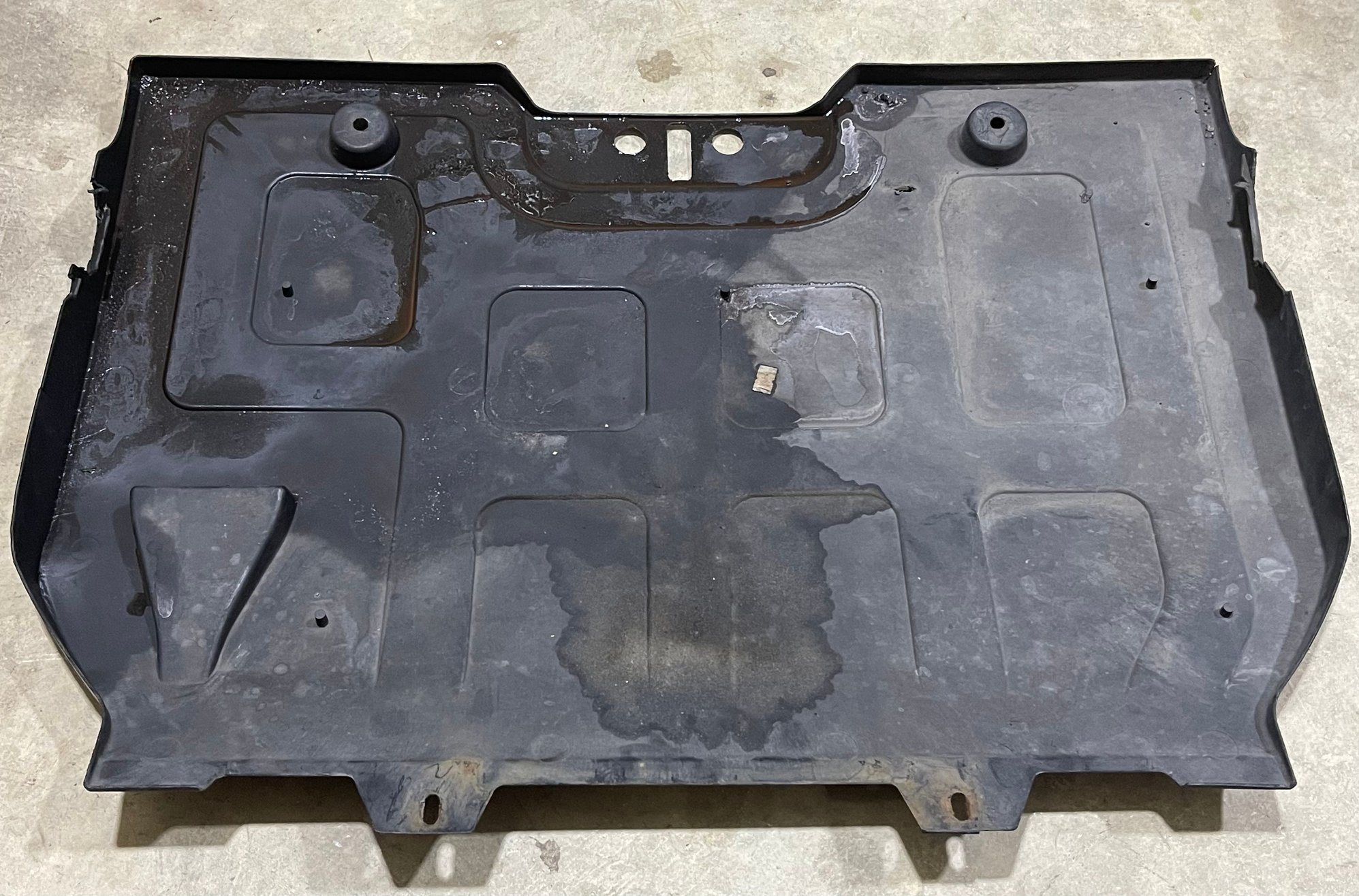

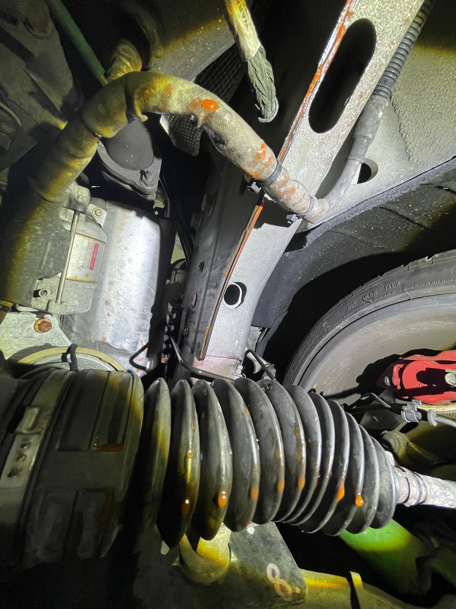

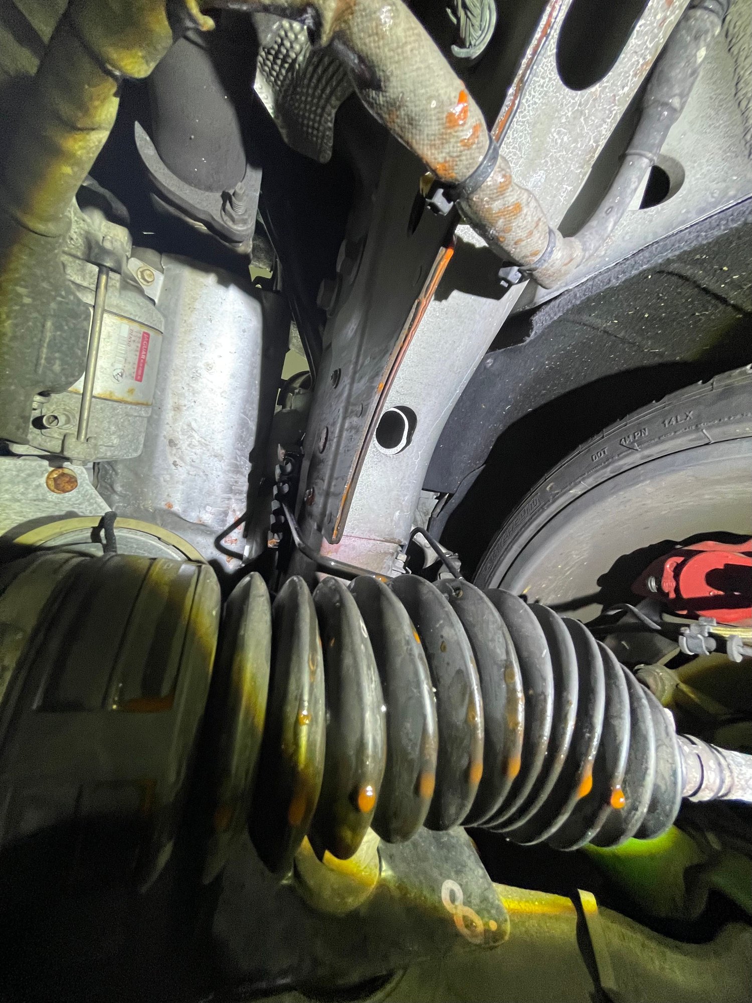

Seems by the under engine splashguard and the other evidence, it is definitely only the hose from the expansion tank.
Now, there could be coolant in the valley, but since I have neither the tools nor the skills, I won’t be removing the SC to look.
I am going to clean everything up under there and up top, then throw on another worm clamp.
The coolant trail of tears.
To make a trail like that, it has to be more than a drip.
Another view.
Another view.

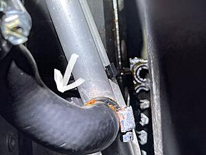

And finally the cover.
Confirms that side is the source.

My worm clamp was too big so I ordered an assorted set of 20 or so for $6 on Amazon to be here tomorrow.
Having stared at it a dozen times, fondling it and wiping it off, I think when the tank was replaced (non jaguar shop), they tightened the top clamp too hard.
Hose is snug, but so snug there is a slight bulge behind it.
I do find myself wondering if I sprayed it with some FlexSeal, if it wouldn’t stop the leak.

someone put an autozone worm clamp on it, probably ate the hose up. if it's not norma/aba or a clone of those designs don't use it

Don't use a worm clamp on your Jaguar. OEM was probably a single ear hose clamp or spring clamp:

Highest coolant temp was 206. But at 45mph around 196. MAF was 6.75-7.2 whatever that means.
Along the stops, popped the bonnet and stuck my fingers under the hose. Holy crap that burns. But no coolant.
Back in the garage. I’ll wait 2-3 hrs, check the coolant level and feel for leaks.
Worth noting because it was asked, after cleaning the coolant trail of tears underneath and above really well, I did not notice and burning coolant smells. None.
Pics for posterity:
(circled is a reflection from shining the torch. Not actually red)
