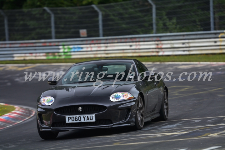

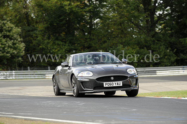

The 75, Dynamic Pack & R-S have re-tuned Adaptive Dynamics damper-control software, increased spring and damper rates (front springs 28% stiffer, rear springs 32%) and lower ride height (10mm). They also have different front and revised rear suspension uprights that increase camber stiffness by 30%.
Subjectively, the car has little body-roll, though it doesn't feel excessively stiff. Here are a couple of 'Ring shots; the first is halfway through Brünnchen (uphill, cresting, slightly reverse-cambered right):
And the second is the exit from the Small Carrousel (rough, sweeping, heavily-cambered left):
So, some roll, but not really noticeable from the driver's seat - things are a little exaggerated in the second image due to acceleration squat (you really boot it out of that corner).
If you're buying the rest of the GT package, and have the money, I'd say: get the full set. Mr. Pook wouldn't have put the sway bars in there if they weren't necessary.

Thank you for the detailed images and explanation, I'm currently going with the Spires Coilovers as these guys spend some serious time on the track with Jags and BMWs. They are building me F-Type dampers with coilovers ~30% stiffer than the RS for my XKR. If the GT package part by part is extremely expensive and I might as well buy the GT. I do regret not getting the speed pack but from what I have read the Coilovers will make me happy. It just always concerns me that such a heavy car has such small sway bars but I'm going to see how it handles before dumping 1200+ into a sway bar.
How fast are you going in the second picture? The right rear is under a heavy load but the camber looks dead on.

I appears to me that the car could definitely use larger sway bars. Too much body roll in those pictures will slow the transitions.

I can agree but I wonder what the speed is exciting that cambered turn. Coming out of a cambered turn like that onto a flat surface will cause a lot of weight transfer. Hence the large sway bar LOL I answered my own question, and its the transitions that have bothered me most. Oh well overpriced sway bar here I come.
Hard to say - 70? Judge for yourself at 10:05 on here:
I wish I'd positioned my Road Angel so that the speed was visible; there are a few places on the lap that I'd like to know my speed.

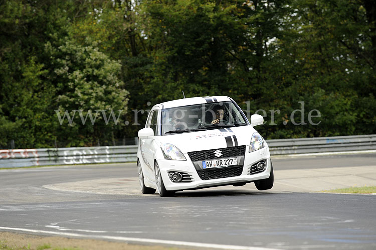

Transitions are fine, at least at my speeds - watch the video, and you'll see that through the twists from 7:18 onwards (Wippermann, Eschbach & Brünnchen). There was never any sensation of it 'lurching' from one attitude to the other. Those images represent some of the points of greatest stress on the circuit. Coming out of the Small Carrousel the camber change is particularly abrupt - the concrete is banked, the tarmac isn't, so the car tends to hop a bit, as this guy will attest:

LOL That only thing that will fox that is about 200lbs of sandbags.
I've never been on that exact track but I know coming out of banking abruptly as in that turn upsets are cars balance very quickly.
