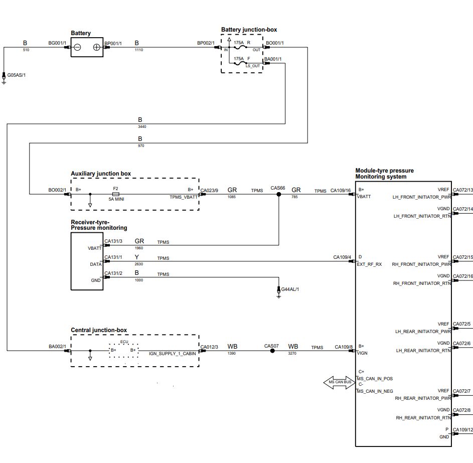

I want to reboot the module, or I may want to give it the boot. With the warm weather it gets initiated, or since I am not plugging in the battery minder, the parasitic battery loss will be my next challenge.

Not sure what year your car is, so here's one from a random X150. Looks like F2 in the aux junction box

Thanks RiverJoe! Its a 2007 NA.
