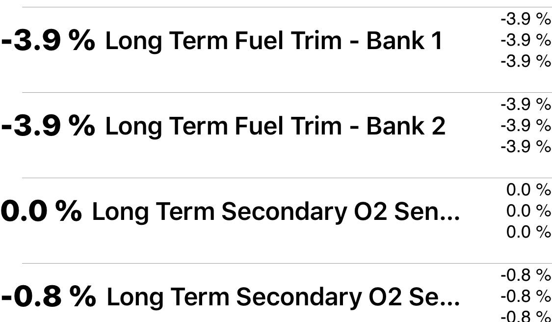

Could you post your current LTFT (long term fuel trim) first please.
I'd like to see where your car is at right now in terms of air fuel ratio.

Both banks are showing long term fuel trim at -3.9%
The secondary O2 sensors are at 0.0% on bank one and 0.8% on bank 2

Originally Posted by tarokyama
Excited to see the results,
Id like to hear your theory on how you figure out afr ratio out of fuel trims.. 🤔. 😆 let's hear it. Don't mean to make make fun but this is amusing ..

I was curious about that but since it’s two different paragraphs I was thinking those are two unrelated thoughts. He didn’t ask for any specific A/F data so I didn’t post any. I’d have to display it as a table anyway. I can tell you it’s stoichiometric when idling, I guess?

Thanks for posting that,
+6 and +9
not sure how to fix it still

My understanding its that anything under +-10 is not to be worried about, but I'm not as familiar with an engine that is as picky refined as a Jaguar motor. My initial thought would be not to be concerned about it.
