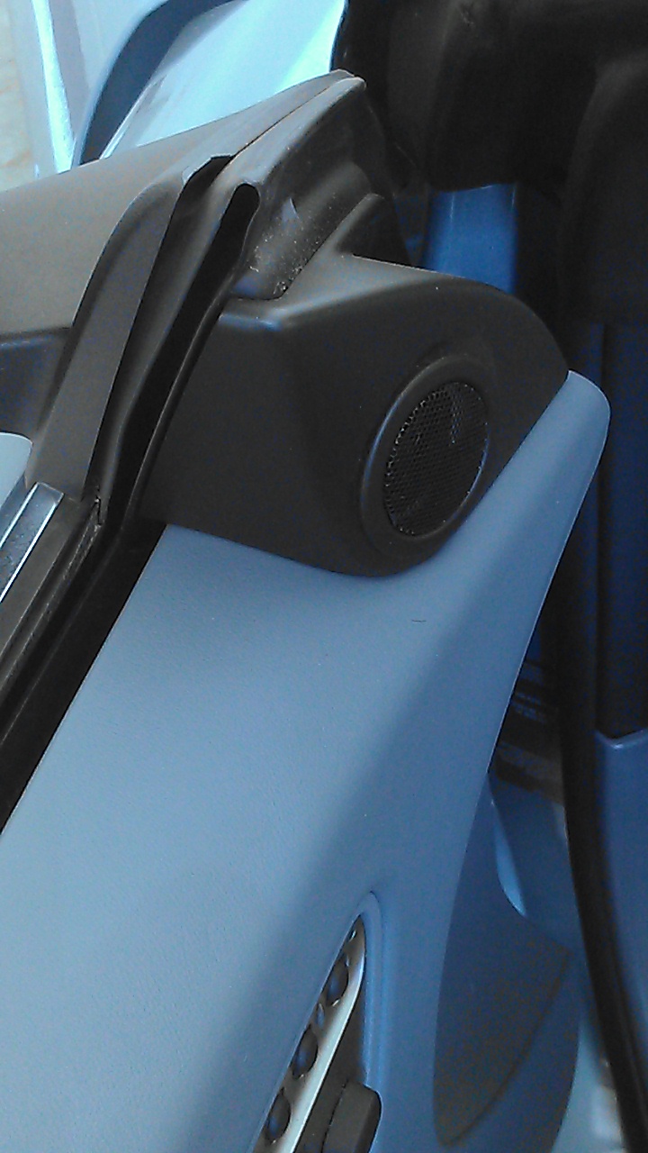

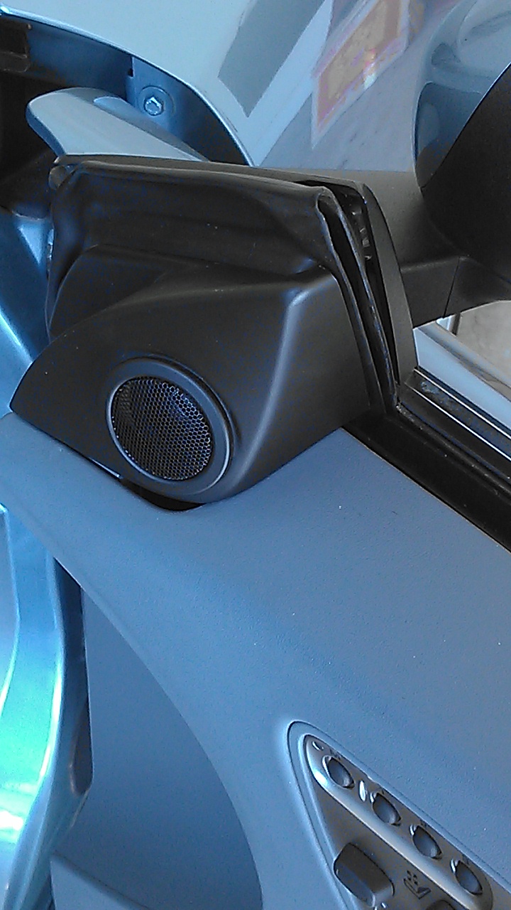

Here are photos of driver (good) and passenger (warped) panels. Showing both where they fit against the speaker grills, and the window channels. The speaker grills are mounted correctly. The photos just make them look an odd angle. As I say, its not a huge gap,less than 1/2 inch, just annoying. Hoping it doesn't increase over time, though. Ideas anyone?

Ok, looks just like mine. I thought maybe I had messed up the speaker 're-seating', but apparently not. It's another thing on my list to look into when I get a chance (thanks WhiteXKR for the suggestion about the door clips, that's a possibility).
Since I'm in the driver's seat I don't see it often, but it does detract from the 'perfection' one tries to show a passenger.
