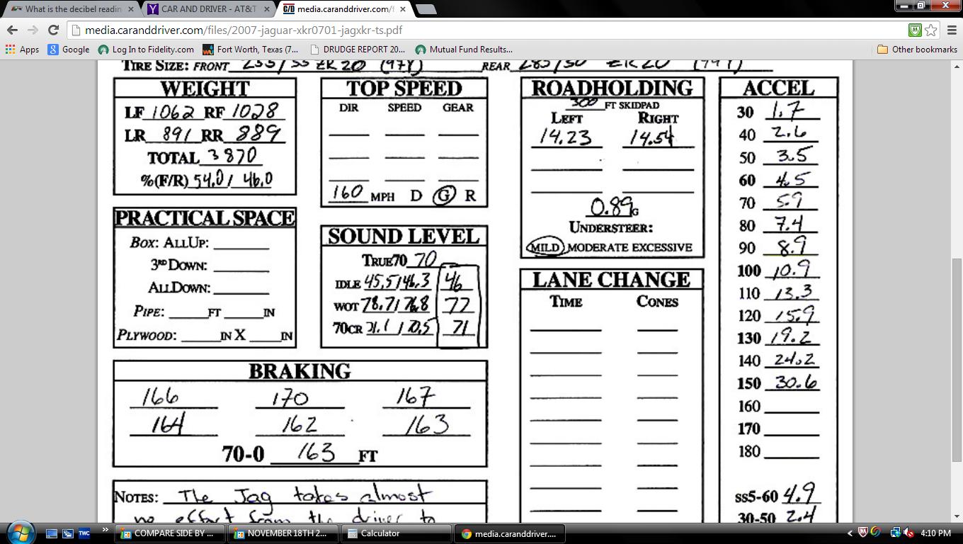

Car and Driver do road tests, as you know, and if you click on the DOWNLOAD SHEET for a particular car you find the DB for ..idle....wot....and cruise at 70mph.
See jpg attached of a 2007 XKR from the Car and Driver instrumented road test.
Or this: 2007 Jaguar XKR - Road Test - Car Reviews - Car and Driver

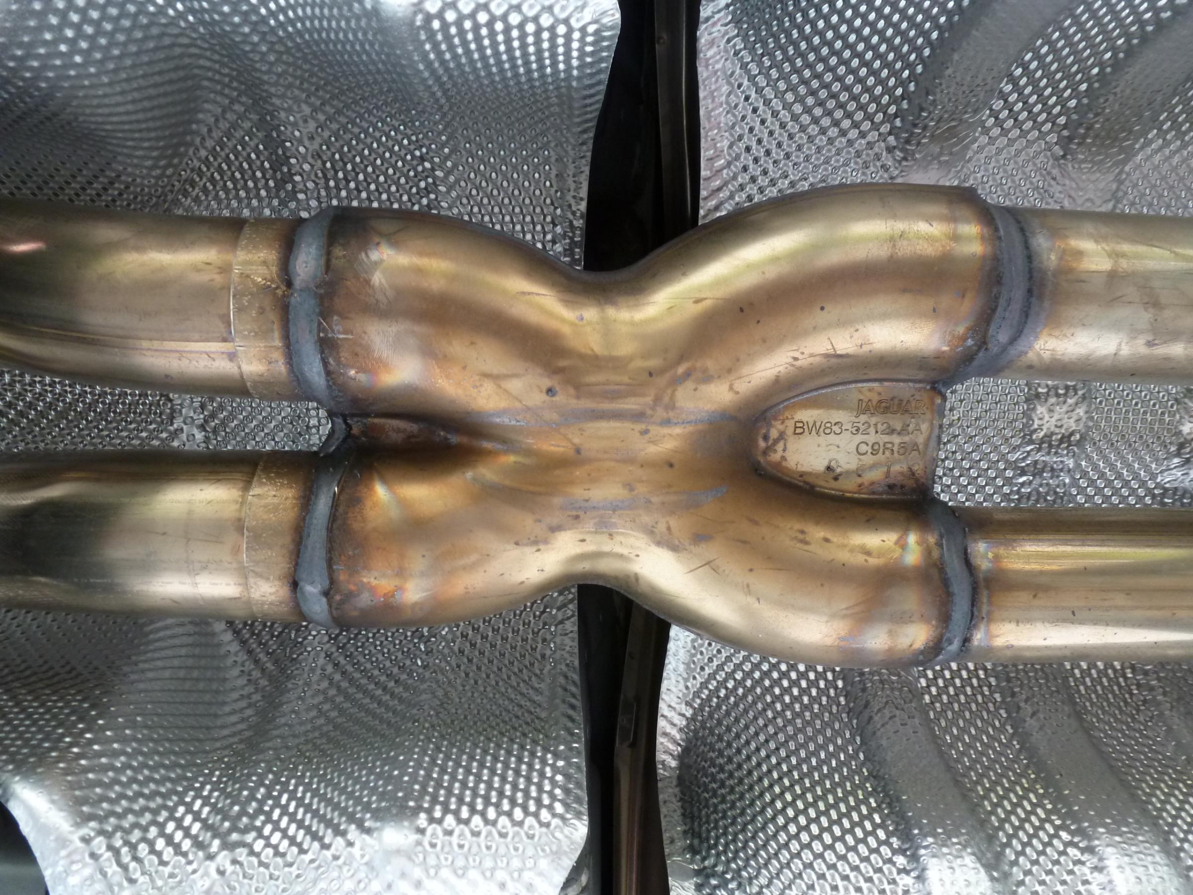

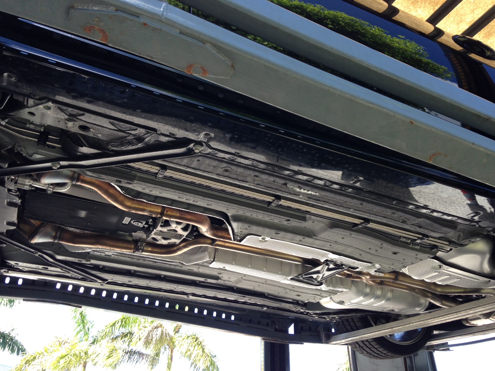

Some after market exhaust systems remove the active exhaust muffler system and replace it with there own muffler with no switching control. If you have the standard exhaust and want the performance exhaust option which is standard on the XKR-S you can remove the 2 resonators in the mid pipe and replace it with an "X-pipe". X-pipes are available after market or you could buy the Jaguar X-pipe. With the X-pipe and the active exhaust values opened the sound is addictive. The best thing with this set up is that you can have it both ways. Picture attached of performance exhaust "x-pipe".
