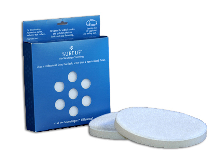

I have been experimenting cleaning windows by using a clay bar and window polish. The results have very good. Not only does the glass appear much clearer; but it remains that way longer. Also with an application of sealant, any water beads up and runs off leaving less streaking and residual dirt on the window.
Begin by first washing the window of any debris using non-ammonia cleaner. Then while the window is still wet, run a clean clay bar over it to pull out any embedded debris. If the bar 'drags', spray a little detailer to lube the surface. Then wipe the surface dry with a microfiber towel. Next I used a "glass specific polish" with the DA orbital polisher and a firm pad. I spent about a minute or two on each window. The results are amazing. Some sources advise to tape the rubber edges around the glass, but if you're careful I think this is unnecessary.
Most detailer/bloggers advise finishing the job by using a glass sealant to protect the surface, just like a wax protects the polished painted surface. I had some RainX that seems to do the job, however, I think I'll experiment with other brands. Finally, I use the DA orbital with a Surbuf Microfingers Pad to buff out the haze left by the sealer. I would estimate that it takes less than three or four minutes to do a windshield, and using the power tools it is very easy. I even experimented with the inside of the side windows, although not the front or back glass.
BTW I am using Griots Fine Glass Polish, an 8 oz bottle cost about $12. Do not try to use ordinary paint polish as it leaves a greasy film on the surface. The glass specific polish dries to more of a powder consistency. To get the best results use microfiber towels.
