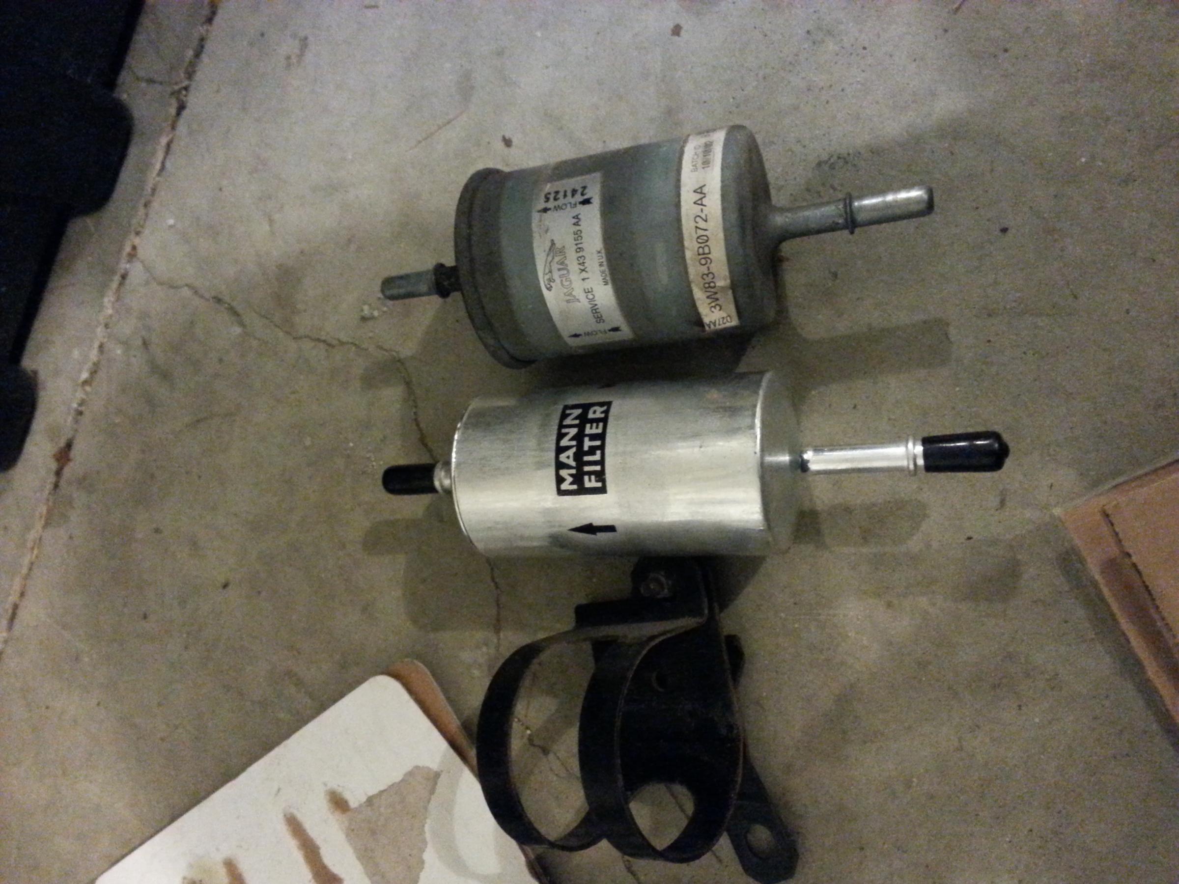

Default Not too bad
Got mine done without needing a lift; not sure if it would help much, really. Once you take off the left rear wheel the process goes a bit easier. I think you can probably get away without the special tool, but it did make removing the quick release fittings a bit easier once the buttons were pushed (took a while to find them, but they are there).
Removing the upper fitting first is a good idea, but you will spill a few ounces of fuel once the lower one is removed, regardless. Keep some kitty litter and a drip pan handy. The Mann filter is a bit thinner than the one I removed - which I think is the original one; unless one of the prior owners had it replaced. Will find out once I disassemble it. I made it fit the bracket by using the tape trick mentioned in an earlier post (thanks).

Wow. The difference in diameter is significant. Hope you work it out. At least"your" original was made in the UK!
A few wraps of electrical tape did the trick. Now it fits into the bracket like the original.

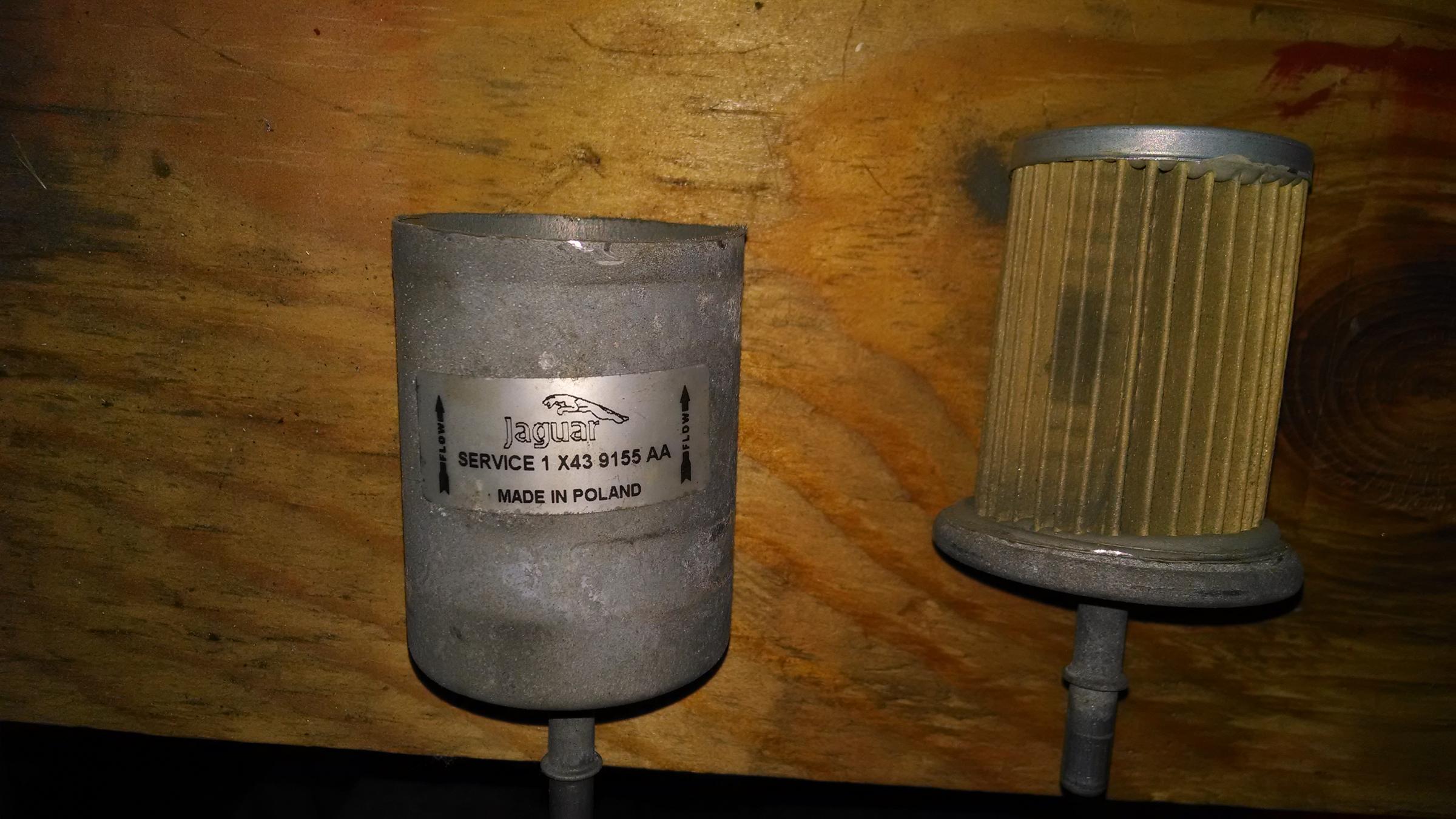

Hi Guys,
I finally got around to cutting open the filter that remove from Kitty a couple of months ago. Attached are two photos. The first shows the cut apart OEM filter with the oh-so-British "Made in Poland" label. In the second I have stretched out the removed filter element. The top strip is obviously the dirty side and the bottom strip is a piece that I flipped over so you can see the difference.
I believe this may have been the original filter, so it had over 100K miles on it. Of course a bunch of blackened gasoline drained from the dirty side when I remove the filter, so that amount of debris is missing.
I guess the dirty side isn't shockingly dirty, but it has definitely collected some grit over the years. So, ... do we "need" to change our fuel filters regularly? Well, I think the 100K mark is a bit high mileage for a change, but it certainly isn't going to knock the earth off its axis.

Not bad at all. Today's gasoline is relatively clean compared to leaded fuel back in the day. Clogged fuel filters are much rarer today than they were during the leaded fuel era. But given enough time and miles, it can certainly happen....
