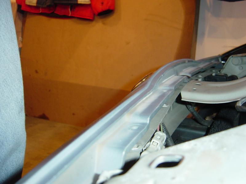

Here are a few pictures of what I have done so far. Just checking to make sure everything fits.

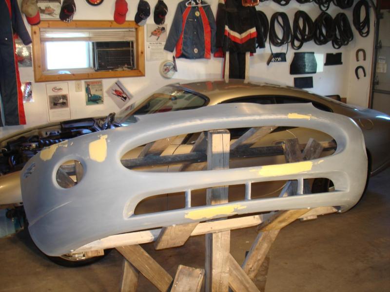

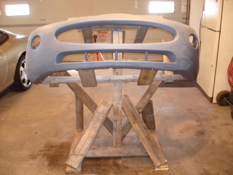

Here we go.............Got started today on the bumper cover. Over the year's I found out the best way to paint bumper covers is to make a stand to hold them. Make it as if the bumper cover was bolted to the car. Keeping the same shape and size. Keeping the bumper cover from flexing while you work on it and paint it is very important to the longevity of the paint, you will not get spider cracks and paint starting to chip and peal. I keep the bumper cover on the stand through the whole process from sanding and body work to color sanding and buffing it out. The last picture the bumper, it is painted silver metalic. I've learned that the plastic bumper covers tend to be darker than the rest of the car after painting. So I use a little bit lighter base coat as a primer. I will paint the bumper cover next week . I am not a paint and body guy, I just do this for myself at home in my garage. It's getting there.

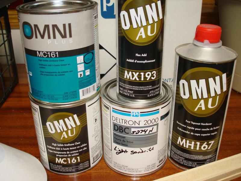

The paint I'm using is the Omni brand. It's made by PPG. I will have to add flex additive to the clear coat. I've talked with some painters and you can get away with not using a flex additive on the plasitc bumper that are fixed solid and do not move around on the car. Flex additive back in the day was used only for reassembly of the bumper keeping the paint soft so as you move the bumper around it wouldn't crack on you. Todays flex additive will last for ever and helps resist rock chips and if you have a small mishap and actually use your front bumper as a bumper the paint wont crack and fall off.I mix the paint at the local NAPA. I've been working with the guy's over there for over 20yrs and I think we got it down on how to mix the paint. I spray it right in my garage with a HVLP spray gun.

Mixed up the paint today and getting ready to spray the bumper Friday. I will see if I can take some pictures while I'm painting. The picture I posted is of the base coat paint, the Urethane clear, the topcoat hardener and flex additive. The base coat paint is a 1:1 mix with a medium reducer.
