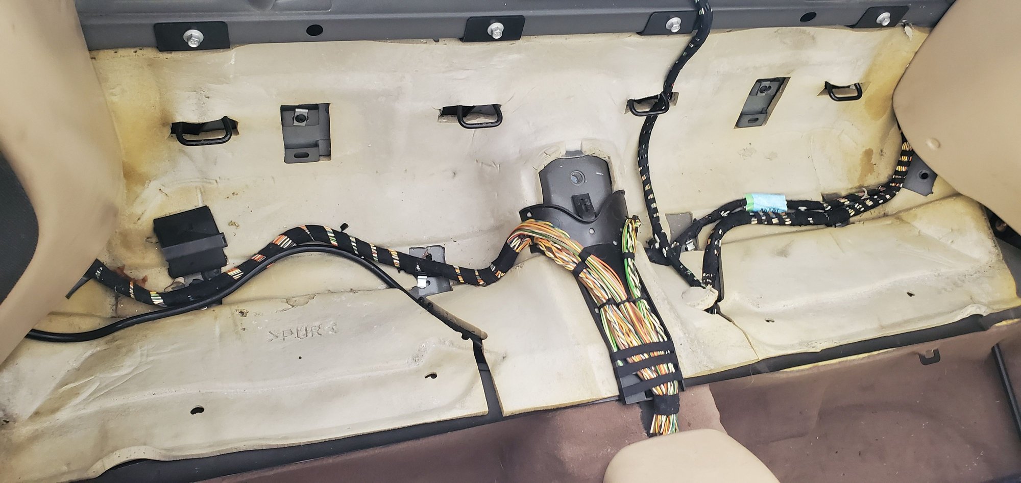

I pulled my useless rear sear out to add a usable package tray, and a couple of lockable storage buns(not real big, but useful. Replaced the speakers while I was at it, and added acouple more. I have been very happy with the results, and gotten many positive comments on the work.
Seats removed.
Trunk access??
The beginnings of the install.
Final results. Aluminum ribs to protect the carpet.
