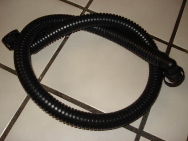

I have obtained Norma connectors and user "vanremog" is making hoses with these using uprated flex hose. PM him.
I'd blame Jaguar more than Norma. It's not uncommon for there to be a non-retail, OEM supply. I think hose Jaguar chose to use was designed for electrical conduit not breather hose

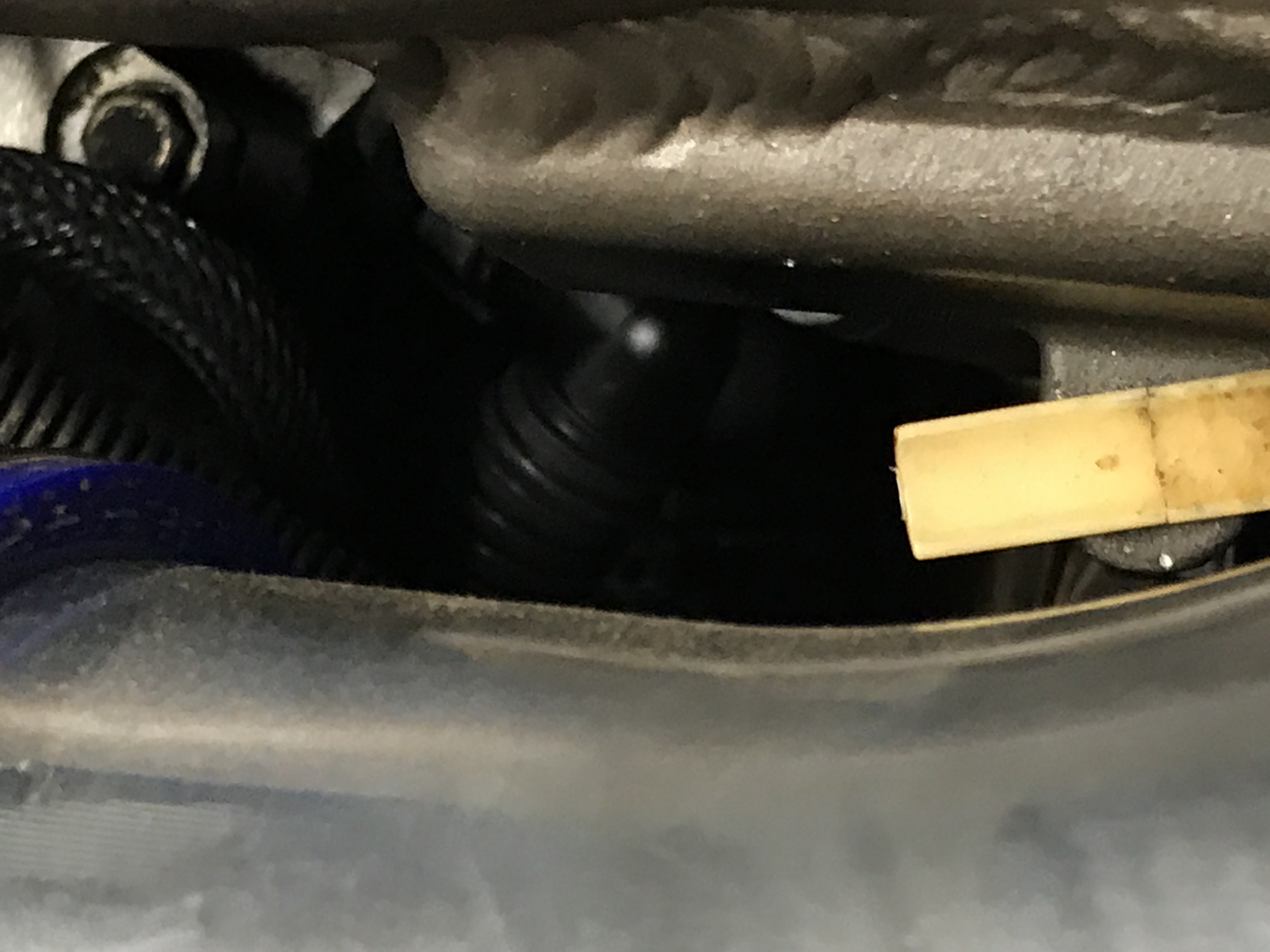

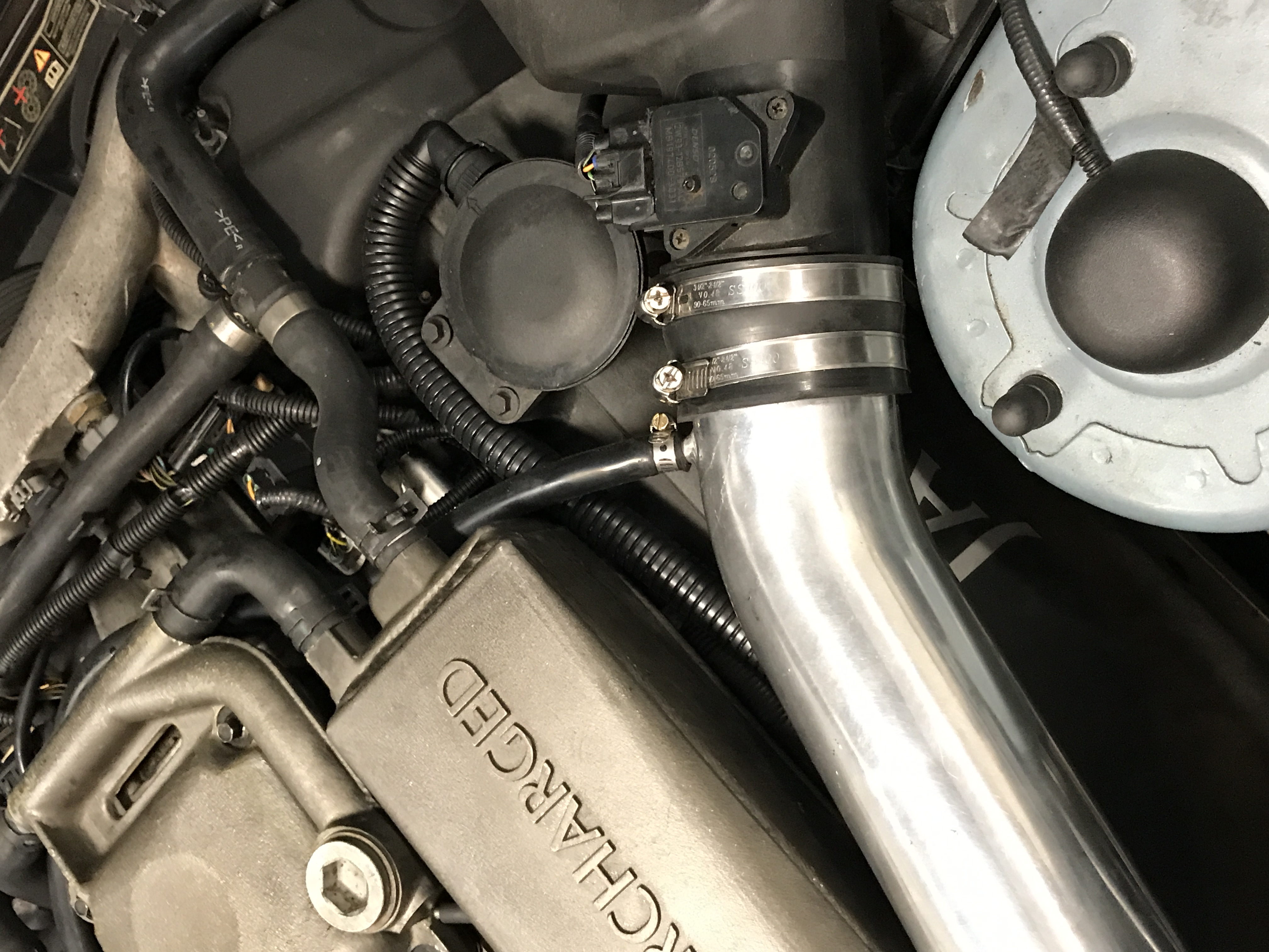

I finally fitted the new breather hose on my 2003 XKR.
The Norma V2's fit perfect. My car had one side 90 degree other end straight, but with a bit of extra slack (32" of hose) the dual 90 degree hose worked perfect.
If interested pm vanremog as he has the Norma connectors and the hose.
Best!

New hose installed.
